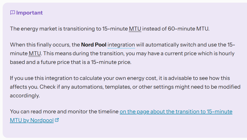

I’ve been trying to get Nordpool 15min data into HA and this is what i’ve managed so far.
Use the HA Core Nordopool integration that supports 15-min data (uninstall your hacs version from hacs first to be able to install this from devices)
Use a template to create graph data with corrections for vat and transfer costs
Use AIO energy management to automate cheap hours.
pasting code below

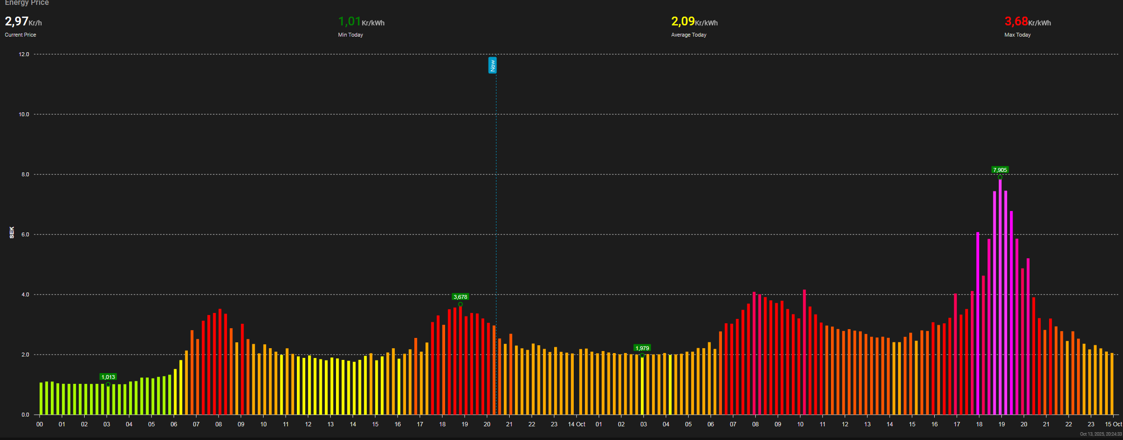

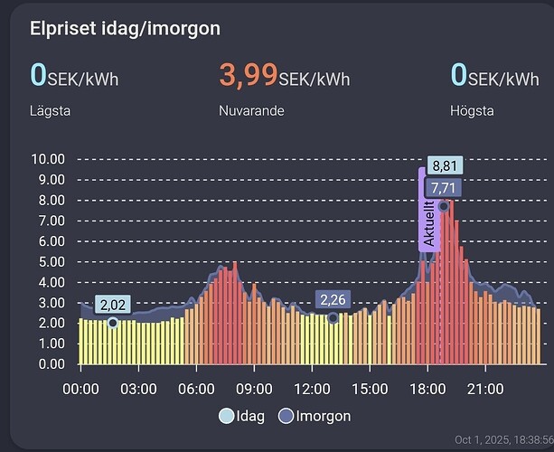

and here is an updated (again) graph to show current, average, min and max
type: custom:apexcharts-card

        const end = new Date(entry.end).getTime();
        const midpoint = start + (end - start) / 2;
        return [midpoint, entry.value];
      return data;
  - entity: sensor.electricity_prices_today
    yaxis_id: SEK
    float_precision: 3
    show:
      in_header: true
      in_chart: false
    unit: Kr/kWh
    color: white
    attribute: min
    yaxis_id: SEK
    float_precision: 2
    show:
      in_header: true
      in_chart: false
    unit: Kr/kWh
    color: green
    attribute: mean
    yaxis_id: SEK
    float_precision: 2
    show:
      in_header: true
      in_chart: false
    unit: Kr/kWh
    color: yellow
    attribute: max
    yaxis_id: SEK
    float_precision: 2
    show:
      in_header: true
      in_chart: false
    unit: Kr/kWh
    color: red
yaxis:
  - id: SEK
    min: 0
    max: ~12
    apex_config:
      tickAmount: 6
      forceNiceScale: true
      title:
        text: SEK
A more advanced graph can be found below
Sorry for stealing you post, but do someone know what broke my min/max in the Apex chart? Cant get this to show :frowning:
now:
  show: true
  label: Aktuellt pris
  color: var(--primary-color)
graph_span: 24h
show:
  last_updated: true
span:
  start: day
  offset: +0H
header:
  title: Elpriset idag/imorgon
  show: true
  show_states: true
  colorize_states: true
  floating: false
apex_config:
  show:
    offset_in_name: false
  chart:
    height: 250px
  legend:
    showForSingleSeries: true
  plotOptions:
    bar:
      borderRadius: 0
  yaxis:
    min: 0
    decimalsInFloat: 2
    tickAmount: 10
hours_12: false
stacked: false
experimental:
  color_threshold: true
all_series_config:
  show:
    legend_value: false
    datalabels: false
    extremas: true
    in_brush: false
  float_precision: 1
  type: area
  invert: false
  fill_raw: zero
series:
  - entity: sensor.nordpool_kwh_se3_sek_3_10_0
    type: column
    color: lightblue
    color_threshold:
      - value: 0
        color: "#8be9fd"
      - value: 1
        color: "#50fa7b"
      - value: 1.5
        color: "#8be978"
      - value: 2
        color: "#f8f872"
      - value: 2.5
        color: "#ffb86c"
      - value: 3
        color: "#ff9859"
      - value: 3.5
        color: "#ff7846"
      - value: 4
        color: "#ff5555"
    float_precision: 2
    stroke_width: 0
    unit: SEK/kWh
    show:
      legend_value: false
      extremas: true
      in_header: false
      header_color_threshold: true
    data_generator: |
      return entity.attributes.today.map((price, index) => {
        return [new Date().setHours(index/4,index%4*15,0), price];
    attribute: min
    type: column
    float_precision: 2
    stroke_width: 2
    show:
      in_chart: false
      in_header: true
      legend_value: false
    color_threshold:
      - value: 0
        color: "#8be9fd"
      - value: 1
        color: "#50fa7b"
      - value: 1.5
        color: "#8be978"
      - value: 2
        color: "#f8f872"
      - value: 2.5
        color: "#ffb86c"
      - value: 3
        color: "#ff9859"
      - value: 3.5
        color: "#ff7846"
      - value: 4
        color: "#ff5555"
    type: column
    show:
      legend_value: false
      extremas: true
      in_header: true
      in_chart: false
    float_precision: 2
    color_threshold:
      - value: 0
        color: "#8be9fd"
      - value: 1
        color: "#50fa7b"
      - value: 1.5
        color: "#8be978"
      - value: 2
        color: "#f8f872"
      - value: 2.5
        color: "#ffb86c"
      - value: 3
        color: "#ff9859"
      - value: 3.5
        color: "#ff7846"
      - value: 4
        color: "#ff5555"
    attribute: average
    type: column
    color: "#ffb86c"
    float_precision: 2
    stroke_width: 2
    show:
      in_chart: false
      in_header: false
      legend_value: false
    attribute: max
    type: column
    float_precision: 2
    stroke_width: 2
    show:
      in_chart: false
      in_header: true
      legend_value: false
    color_threshold:
      - value: 0
        color: "#8be9fd"
      - value: 1
        color: "#50fa7b"
      - value: 1.5
        color: "#8be978"
      - value: 2
        color: "#f8f872"
      - value: 2.5
        color: "#ffb86c"
      - value: 3
        color: "#ff9859"
      - value: 3.5
        color: "#ff7846"
      - value: 4
        color: "#ff5555"
    color: "#6272a4"
    extend_to: false
    unit: SEK/kWh
    float_precision: 2
    opacity: 0.5
    stroke_width: 2
    show:
      extremas: true
      in_header: false
      legend_value: false
    data_generator: |
      return entity.attributes.tomorrow.map((price, index) => {
