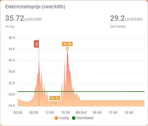

And here’s the code for the apexchart. Note that I am using the “area” format. I am still working on showing only one day if data for tomorrow is not yet available.
I was not bothered about splitting min/max values over today or tomorrow, so these were omitted.

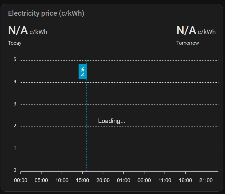

Somehow my chart looks like this:
What could be the problem? Data_generator mayby? Data seems ok in sensor.electricity_prices -entity.
Code from @Stolsel.
I am having the same issue with the graph not loading

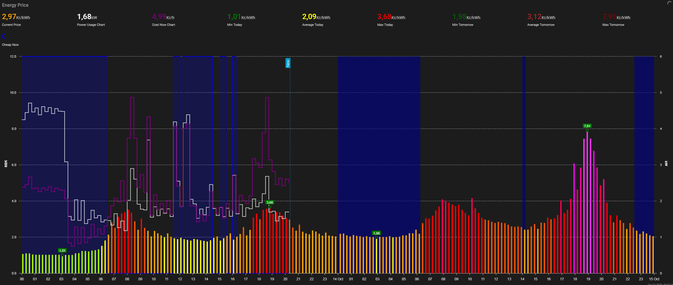

Advanced graph
remove what you don’t need

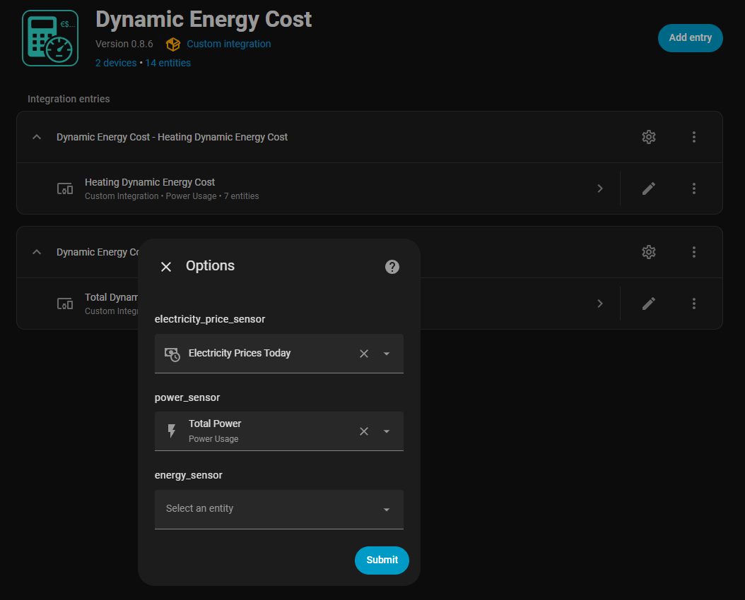

there is a power sensor. and i use Dynamic Energy Cost from HACS to calculate current price with the power used now.
the graph also shows future low price planning from aio energy management.

  - entity: sensor.electricity_prices_tomorrow
    attribute: mean
    yaxis_id: SEK
    float_precision: 2
    show:
      in_header: true
      in_chart: false
    unit: Kr/kWh
    color: brown
    attribute: max
    yaxis_id: SEK
    float_precision: 2
    show:
      in_header: true
      in_chart: false
    unit: Kr/kWh
    color: darkred
  - entity: binary_sensor.my_cheapest_hours
    yaxis_id: CHEAP
    transform: "return x === 'on' ? 1 : 0;"
    color: "#00f"
    show:
      in_header: true
      in_chart: false
yaxis:
  - id: SEK
    min: 0
    max: ~12
    apex_config:
      tickAmount: 6
      forceNiceScale: true
      title:
        text: SEK
  - id: kW
    min: 0
    max: ~6
    decimals: 0
    apex_config:
      tickAmount: 6
      opposite: true
      title:
        text: kW
  - id: CHEAP
    min: 0
    max: 1
    show: false
    apex_config:
      tickAmount: 6

to get dynamic energy cost. you need a power sensor reading your current powers usage. in this case Total Power (i use a shelly 3em)
get Dynamic Energy Cost integration via HACS
make a dynamic cost entity in Dynamic Energy cost wit Todays Price as electricity price sensor. and your Total Power (W) sensor as power sensor.
Name it " Total Dynamic Energy Cost" (that’s what is used in the advanced graph)
