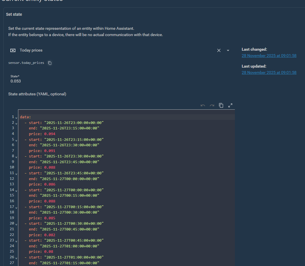

I have a strange behavior word the Core nordpool integration. At the start of the day (from 00:00 to 13:05), the template (code below) collects the data from yesterday as the today_price, and i don’t know why.
If i use a template action in the developer tools the collected data is fine, what am i missing?
- trigger:
    - trigger: time_pattern
      minutes: /15
    - trigger: homeassistant
      event: start
  action:
    - action: nordpool.get_prices_for_date
        config_entry: 01KB4QNAERVA78WH3Z93BYE47R
        date: "{{ now().date() + timedelta(days=1) }}"
        areas: BE
        currency: EUR
      response_variable: tomorrow_price
        date: "{{ now().date()}}"
        areas: BE
        currency: EUR
      response_variable: today_price
  sensor:
    - name: Tomorrow lowest price
      unique_id: nl_tomorrow_low_price
      unit_of_measurement: "EUR/kWh"
      icon: mdi:cash
      state: >
        {% if tomorrow_price is mapping %}
          {% set data = namespace(prices=[]) %}
          {% set electricity_tax = states('input_number.electricity_tax') | float(0) %}
          {% set purchase_costs = states('input_number.electricity_purchase_costs') | float(0) %}
          {% for state in tomorrow_price['BE'] %}
            {% set data.prices = data.prices + [(state.price/1000) | round(3, default=0)] %}
          {% endfor %}
          {{min(data.prices)}}
        {% else %}
          unavailable
        {% endif %}
      attributes:
        data: >
              {% set data.prices = data.prices + [{'start':state.start, 'end':state.end, 'price': (state.price/1000) | round(3, default=0)}] %}
            {% endfor %}
            {{data.prices}}
          {% else %}
          {% endif %}
    - name: Tomorrow highest price
      unique_id: nl_tomorrow_high_price
      icon: mdi:cash
      state: >
          {% endfor %}
          {{max(data.prices)}}
        {% else %}
          unavailable
        {% endif %}
      attributes:
        data: >
            {% endfor %}
            {{data.prices}}
          {% else %}
          {% endif %}
    - name: Today prices
      unique_id: nl_today_prices
      icon: mdi:cash
      state: >
        {% if today_price is mapping %}
          {% for state in today_price['BE'] %}
          {% endfor %}
        {% else %}
          unavailable
        {% endif %}
      attributes:
        data: >
            {% endfor %}
            {{data.prices}}
          {% else %}
          {% endif %}

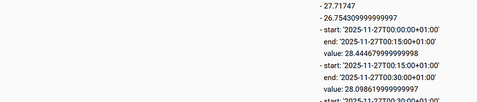

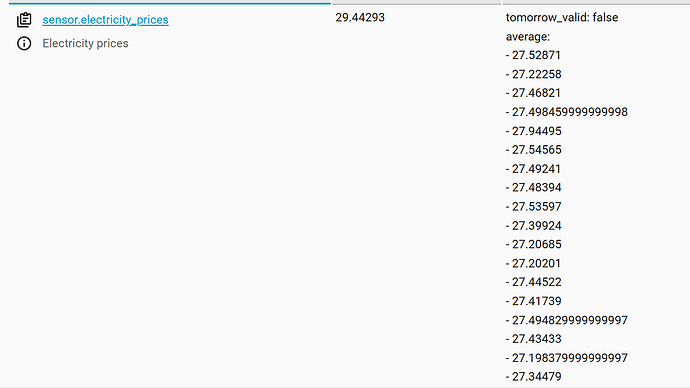

Change the code a bit, now its working:
- trigger:
    minutes: /15
    event: start
  action:
    - variables:
        area: NL
        currency: EUR
        config_entry: <your own config_ID>
        price_now: sensor.nord_pool_nl_current_price
        price_low: sensor.nord_pool_nl_lowest_price
        price_high: sensor.nord_pool_nl_highest_price
    - action: nordpool.get_price_indices_for_date
        config_entry: "{{ config_entry }}"
        date: "{{ now().date() }}"
        areas: "{{ area }}"
        currency: "{{ currency }}"
        resolution: "15"
        areas: "{{ area }}"
        resolution: "15"
  sensor:
    - name: Electricity prices
      unique_id: nl_electricity_prices
      unit_of_measurement: "cent/kWh"
      icon: mdi:cash
      state: > # returns the current price
        {% set vat = states('input_number.VAT') | float(0) %}
        {% set current_price = ((states(price_now) | float(0) + electricity_tax + purchase_costs) * (100 + vat)) | round(1) %}
        {{ current_price }}
      attributes:
        tomorrow_valid: >
          {{ tomorrow_price["NL"] | count > 0 }}
        average: >
          {% if (today_price is mapping) and (tomorrow_price is mapping) %}
            {% if today_price["NL"] | count > 0 %}
              {% for state in today_price["NL"] %}
                {% set corrected_start = as_datetime(state.start).astimezone().isoformat() %}
                {% set corrected_end = as_datetime(state.end).astimezone().isoformat() %}
                {% set data.prices = data.prices + [{'start':corrected_start, 'end':corrected_end, 'value': ((state.price/1000) * (100 + vat) + (purchase_costs+ electricity_tax)*100) | round(1)}] %}
              {% endfor %}
            {% endif %}
            {% if tomorrow_price["NL"] | count > 0 %}
              {% for state in tomorrow_price["NL"] %}
              {% endfor %}
            {% endif %}
            {{data.prices}}
          {% else %}
          {% endif %}
type: custom:apexcharts-card
experimental:
  color_threshold: true
graph_span: 36h
header:
  title: Elektriciteitsprijs (cent/kWh)
  show: true
  show_states: true
  colorize_states: false
span:
  start: hour
  offset: "-8h"
yaxis:
  - id: €cent
    apex_config:
      tickAmount: 10
      forceNiceScale: true
now:
  show: true
  label: Nu
series:
  - entity: sensor.electricity_prices
    yaxis_id: €cent
    type: column
    stroke_width: 0.1
    show:
      extremas: true
      in_header: true
      in_chart: true
      legend_value: false
    float_precision: 1
    color_threshold:
      - value: 0
        color: "#8be9fd"
      - value: 10
        color: "#50fa7b"
      - value: 15
        color: "#8be978"
      - value: 20
        color: "#f8f872"
      - value: 25
        color: "#ffb86c"
      - value: 30
        color: "#ff9859"
      - value: 35
        color: "#ff7846"
      - value: 40
        color: "#ff5555"
      - value: 50
        color: "#ff0000"
    data_generator: |
      return entity.attributes.average.map((record, index) => {
        return [record.start, record.value];
    yaxis_id: €cent
    curve: stepline
    stroke_width: 0.5
    show:
      extremas: false
      in_header: false
      legend_value: false
    data_generator: |
looks allright with my code.

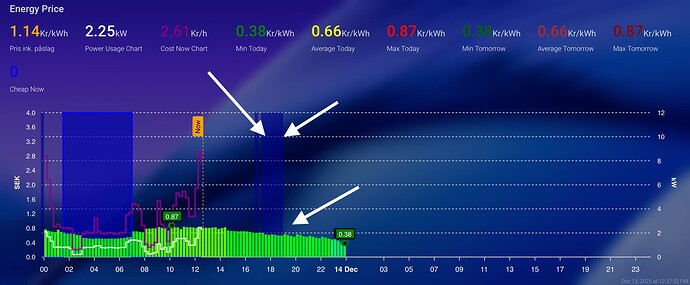

I have a question about AIO. I thought it would highlight the 8 cheapest hours by the config made by @xztraz But as you can see in the pictures there’s highlighted on some low hours, but not the lowest. Is this right, or have I accidentally changed something? Also thanks to @xztraz for making this super easy to set up.
it looks for the cheapest hours between
first_hour: 19
last_hour: 18
it will look better when next days data shows up.
Here is a bit of extended code for aio energy management with cheap and expensive hours. There are some input helpers to be able to fine tune values that need to be created for this to work.
i found the expensive setting to be usefull if you don’t want to turn something off if the price is low enought the whole day.

And graphs for that (and alot of extra stuff)
experimental:
apex_config:
  responsive:
    - breakpoint: 500
      options:
        chart:
          height: 300px
    - breakpoint: 1200
      options:
        chart:
          height: 640px
    - breakpoint: 3000
      options:
        chart:
          height: 800px
  legend:
    show: false
  title:
    floating: false
    align: center
    style:
      fontSize: 20px
      fontWeight: bold
  xaxis:
    labels:
      datetimeFormatter:
        hour: HH
  plotOptions:
    bar:
      columnWidth: 80%
      barGap: 3
graph_span: 2d
show:
  last_updated: true
header:
  title: Energy Price
  show: true
  show_states: true
  colorize_states: true
span:
  start: day
now:
  show: true
  label: Now
series:
  - entity: binary_sensor.my_cheapest_hours
    type: area
    curve: stepline
    yaxis_id: CHEAP
    opacity: 0.6
    stroke_width: 0
    color: "#008"
    show:
      extremas: false
      in_header: false
    data_generator: |
      let data = [];
      let periods = entity.attributes.list || [];
      periods.forEach((p) => {
        let s = new Date(p.start).getTime();
        let e = new Date(p.end).getTime();
        data.push([s, 1]);    // jump up at start
        data.push([e, 1]);    // stay high until end
        data.push([e, 0]);    // drop straight down
      return data;
    yaxis_id: CHEAP
    transform: "return x === 'on' ? 1 : 0;"
    curve: stepline
    type: area
    opacity: 0.2
    stroke_width: 2
    extend_to: false
    group_by:
      func: avg
      duration: 15m
    color: "#00f"
    show:
      extremas: false
      in_header: false
  - entity: binary_sensor.my_expensive_hours
    type: area
    curve: stepline
    yaxis_id: CHEAP
    opacity: 0.6
    stroke_width: 0
    color: "#800"
    show:
      extremas: false
      in_header: false
    data_generator: |
      let data = [];
      return data;
    yaxis_id: CHEAP
    curve: stepline
    type: area
    opacity: 0.2
    stroke_width: 2
    extend_to: false
    group_by:
      func: avg
      duration: 15m
    color: "#f00"
    show:
      extremas: false
      in_header: false
  - entity: sensor.electricity_prices_today
    yaxis_id: SEK
    type: column
    show:
      extremas: true
      in_header: false
    float_precision: 2
    color: green
    color_threshold:
      - value: 0
        color: "#00ffaa"
      - value: 0.25
        color: "#00ff55"
      - value: 0.5
        color: "#00ff00"
      - value: 0.75
        color: "#55ff00"
      - value: 1
        color: "#aaff00"
      - value: 1.5
        color: "#ffff00"
      - value: 2
        color: "#ffaa00"
      - value: 2.5
        color: "#ff5500"
      - value: 3
        color: "#ff0000"
      - value: 4
        color: "#ff0055"
      - value: 5
        color: "#ff00aa"
      - value: 6
        color: "#ff00ff"
      - value: 7
        color: "#ff34ff"
      - value: 9
        color: "#ff65ff"
      - value: 11
        color: "#ff98ff"
      - value: 13
        color: "#ffccff"
      - value: 15
        color: "#ffffff"
    data_generator: |
      return entity.attributes.data.map((start, index) => {
        return [new Date(start["start"]).getTime() + 450000, entity.attributes.data[index]["value"]];
  - entity: sensor.electricity_prices_tomorrow
    yaxis_id: SEK
    type: column
    show:
      extremas: true
      in_header: false
    float_precision: 2
    color: green
    color_threshold:
      - value: 0
        color: "#00ffaa"
      - value: 0.25
        color: "#00ff55"
      - value: 0.5
        color: "#00ff00"
      - value: 0.75
        color: "#55ff00"
      - value: 1
        color: "#aaff00"
      - value: 1.5
        color: "#ffff00"
      - value: 2
        color: "#ffaa00"
      - value: 2.5
        color: "#ff5500"
      - value: 3
        color: "#ff0000"
      - value: 4
        color: "#ff0055"
      - value: 5
        color: "#ff00aa"
      - value: 6
        color: "#ff00ff"
      - value: 7
        color: "#ff34ff"
      - value: 9
        color: "#ff65ff"
      - value: 11
        color: "#ff98ff"
      - value: 13
        color: "#ffccff"
      - value: 15
        color: "#ffffff"
    data_generator: |
    yaxis_id: SEK
    float_precision: 2
    show:
      in_header: true
      in_chart: false
    unit: Kr/kWh
    color: orange
  - entity: sensor.total_power
    yaxis_id: kW
    name: Power Usage Chart
    color: white
    opacity: 0.8
    float_precision: 2
    show:
      extremas: false
      in_header: true
    type: line
    curve: stepline
    stroke_width: 2
    extend_to: false
    unit: kW
    transform: return x /1000;
    group_by:
      func: avg
      duration: 15m
  - entity: sensor.total_real_time_energy_cost
    name: Cost Now Chart
    yaxis_id: SEK
    float_precision: 2
    show:
      extremas: false
      in_header: true
    unit: Kr/h
    type: line
    curve: stepline
    stroke_width: 3
    color: purple
    opacity: 0.8
    extend_to: false
    group_by:
      func: avg
      duration: 15min
    attribute: min
    yaxis_id: SEK
    float_precision: 2
    show:
      in_header: true
      in_chart: false
    unit: Kr/kWh
    color: green
    attribute: mean
    yaxis_id: SEK
    float_precision: 2
    show:
      in_header: true
      in_chart: false
    unit: Kr/kWh
    color: yellow
    attribute: max
    yaxis_id: SEK
    float_precision: 2
    show:
      in_header: true
      in_chart: false
    unit: Kr/kWh
    color: red
    attribute: min
    yaxis_id: SEK
    float_precision: 2
    show:
      in_header: true
      in_chart: false
    unit: Kr/kWh
    color: darkgreen
    attribute: mean
    yaxis_id: SEK
    float_precision: 2
    show:
      in_header: true
      in_chart: false
    unit: Kr/kWh
    color: brown
    attribute: max
    yaxis_id: SEK
    float_precision: 2
    show:
      in_header: true
      in_chart: false
    unit: Kr/kWh
    color: darkred
    yaxis_id: CHEAP
    color: "#00f"
    show:
      in_header: true
      in_chart: false
    yaxis_id: CHEAP
    color: "#f00"
    show:
      in_header: true
      in_chart: false
yaxis:
  - id: SEK
    min: 0
    max: ~12
    apex_config:
      tickAmount: 6
      title:
        text: SEK
  - id: kW
    min: 0
    max: ~6
    decimals: 0
    apex_config:
      tickAmount: 6
      opposite: true
      title:
        text: kW
  - id: CHEAP
    min: 0
    max: 1
    show: false
    apex_config:
      tickAmount: 6
