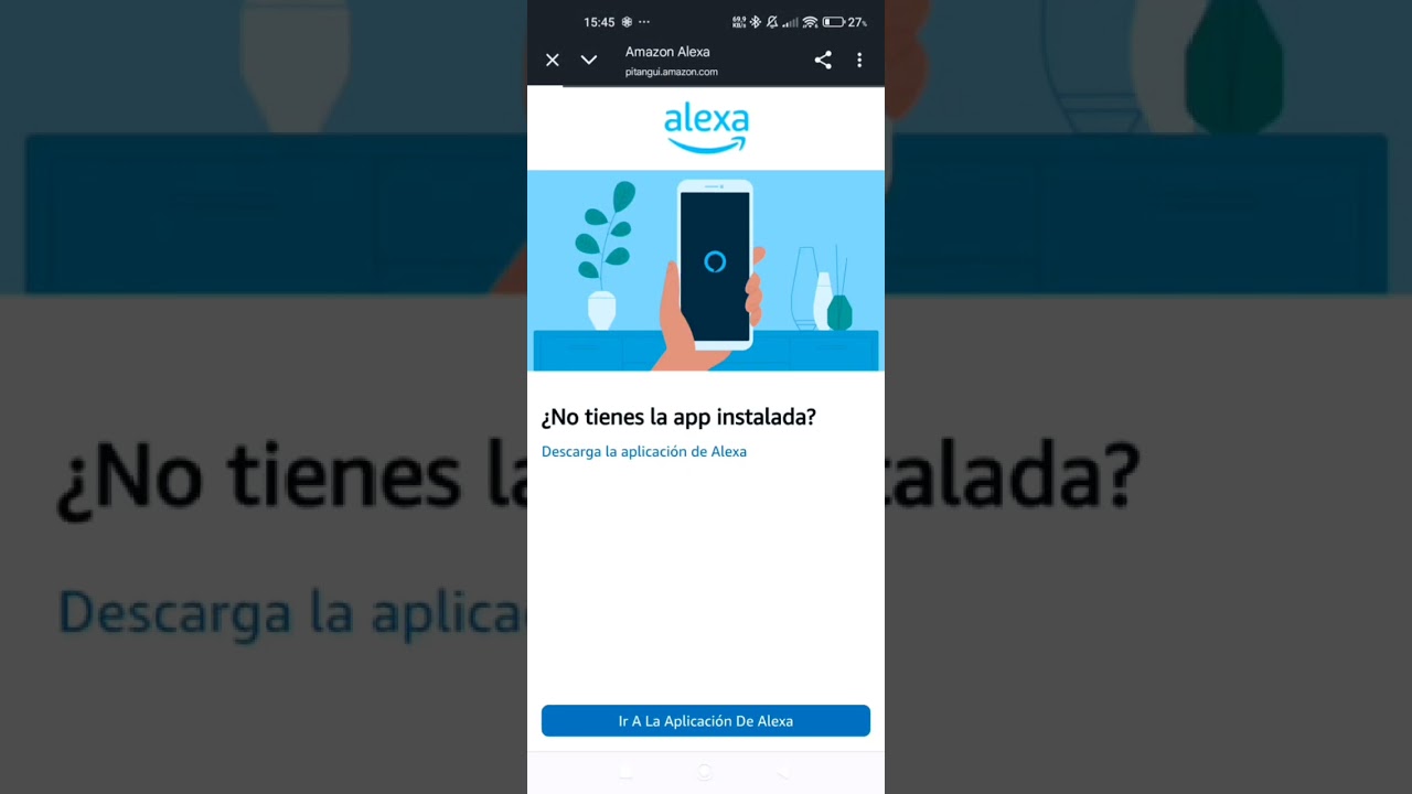

  6. https://layla.amazon.com/api/v1/accountLink/establish?r=E&code=7fxxxxxxxcbf7e&state=AmaseyJ2xxxxxxxtM%3D&error=1&&showRedirect=1&vendor_id=M3OxxxxxVX5Y GET 200 OK from 3.164.162.237:443 where in the querystring says: error=1 and showRedirect = 1
here I get this screenshot:

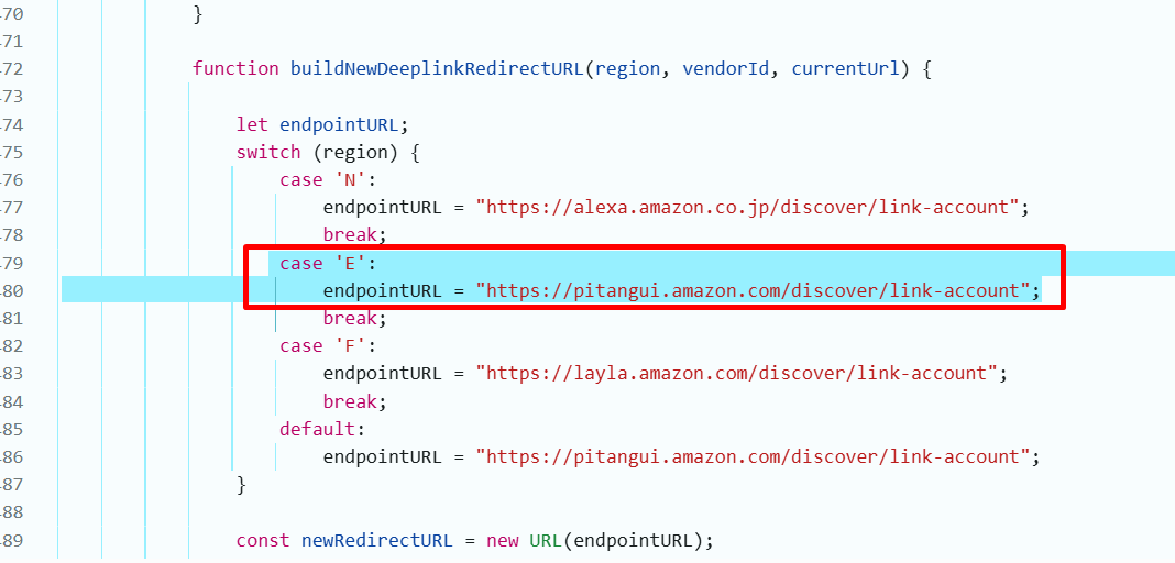

If i check the html source of that page I see that the querystring r=E from the previous url means call to pitangui endpoint and not layla one.
after press the button I get in the loop of the attached video with these 2 request all the time where appears that error in the querystring redirectedFromAMASForcedDeeplink :
  1. https://pitangui.amazon.com/discover/link-account?r=E&code=7fxxxxxxxcbf7e&t=C&vendor_id=M3OxxxxxVX5Y&state=AmaseyJ2xxxxxxxtM%3D&t=C&vendor_id=M3OxxxxxVX5Y&error=redirectedFromAMASForcedDeeplink GET 200 OK where in the querystring says: error=redirectedFromAMASForcedDeeplink
  2. https://layla.amazon.com/api/v1/accountLink/establish?r=E&code=7fxxxxxxxcbf7e&t=C&vendor_id=M3OxxxxxVX5Y&state=AmaseyJ2xxxxxxxtM%3D&t=C&vendor_id=M3OxxxxxVX5Y&error=1&showRedirect=1 GET 200 OK where in the querystring says: error=1 and showRedirect=1 again

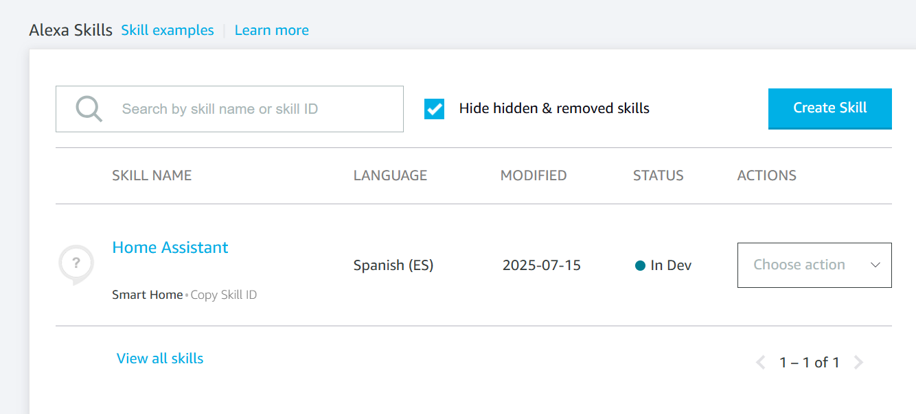

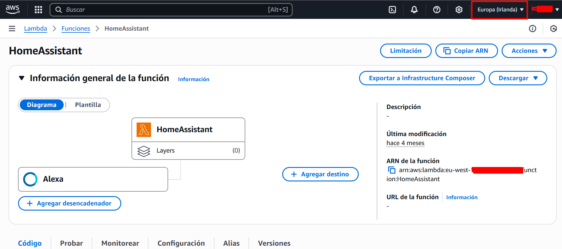

My lambada from AWS is placed in Ireland and my alexa developer account from Spain like my Amazon account which was also migrated some years ago.

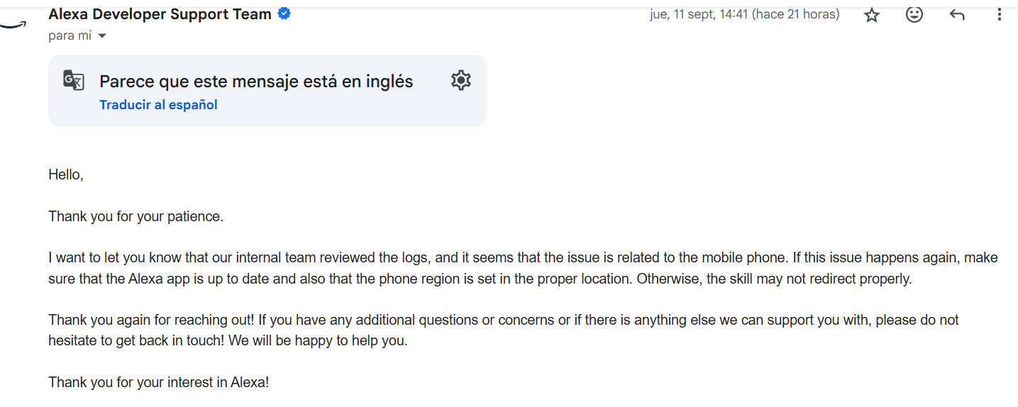

  • I am still waiting for a solution from Alexa Developer support.

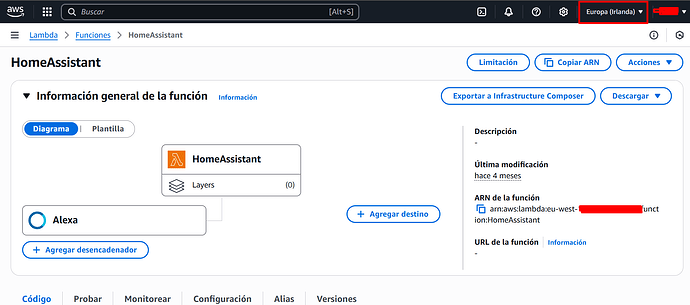

but that’s not the current problem. I cannot link it anymore, I also tried to remove all from AWS (lambda function) and the Alexa skill from developer portal. But it still happens with the new lambda function on Ireland region, the Alexa Skill in spanish language and using my Amazon account which is from Spain.
Finally solved. After migrating my old phone to my new one it worked. So, it was a problem with my Android and Alexa app. Removing cache and login again was not a solution, I never tried to reinstall the app but it was a problem from the device/app.
*one day after Alexa Developers said the same after 1 month and a half:
