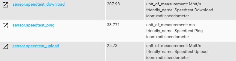

Not all values are stored in Influxdb
To check internetspeed I use this in config:
speedtestdotnet:
  scan_interval:
    minutes: 30
  monitored_conditions:
    - ping
    - download
    - upload
To store these value in Influxdb I use this :
influxdb:
  host: 10.0.0.31
  include:
    entities:
      - sensor.power_consumption_low
      - sensor.power_consumption_phase_l1
      - sensor.regenmeter_hoeveelheid
      - sensor.daily_power_offpeak
      - sensor.daily_power_peak
      - sensor.daily_gas
      - sensor.monthly_power_offpeak
      - sensor.monthly_power_peak
      - sensor.monthly_gas
      - sensor.speedtest_download
      - sensor.speedtest_upload
      - sensor.speedtest_ping
all the values are stored except the speedtest values
what can be wrong ?
