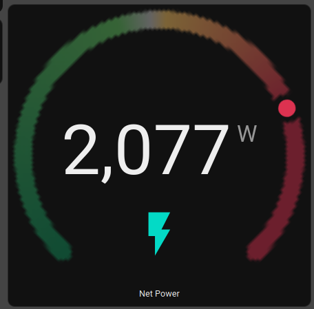

I have a sensor that displays correctly as a plain number (e.g. 2312) when I check it in Developer Tools → States.
But when I use it in a card (specifically custom:gauge-card-pro, custom:modern-circular-gauge), it shows up as 2,312 with a comma as the thousands separator.

The only thing that removes the comma is changing the number format manually in my user profile: Profile → General → Number format → (switch away from the locale that uses comma as thousands separator)
Is there any other solution that applies only to this sensor/card — without forcing me to change the number format globally for my entire user profile?

As I said before, just show 2077 and not 2,077 or 2.077 without changing Profile → General → Number format
