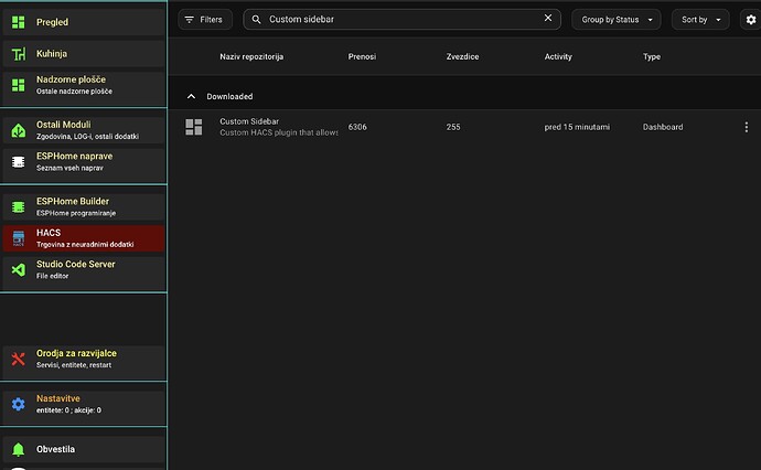

I never used default dashboard from day 1. First thing i do is “take control” and “start with empty dashboard”. I want thing set up the way i want, not anyone else. To be honest, when i open HA i really don’t care if, say, there are currently any lights turned on or not, any covers closed… but as admin i want to see if all is ok with ha, server etc… so on my default dash i have HA info, proxmox info and similar.
But, regarding sidebar I found even better way than “panel_custom” : custom sidebar in HACS. Beside the fact that i can make developer tool at the bottom reappear i can colorize whole thing, make comments below the name, create new entries, shortcuts… This kind of customizatiom should be built-in HA.
(translation: developer tools is “Orodja za razvijalce”)

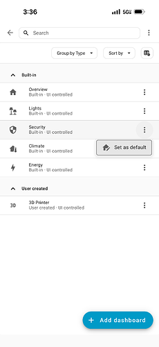

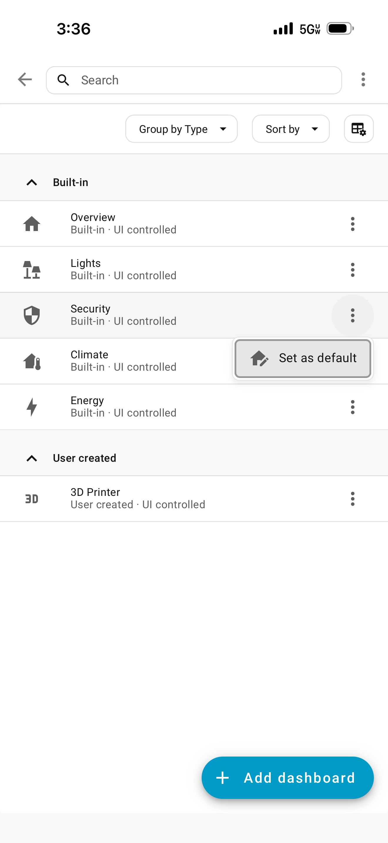

I wanted to make an integration panel the default dashboard but as of now only HA dashboards can be default
Can only make those guys default not an intergration panel.

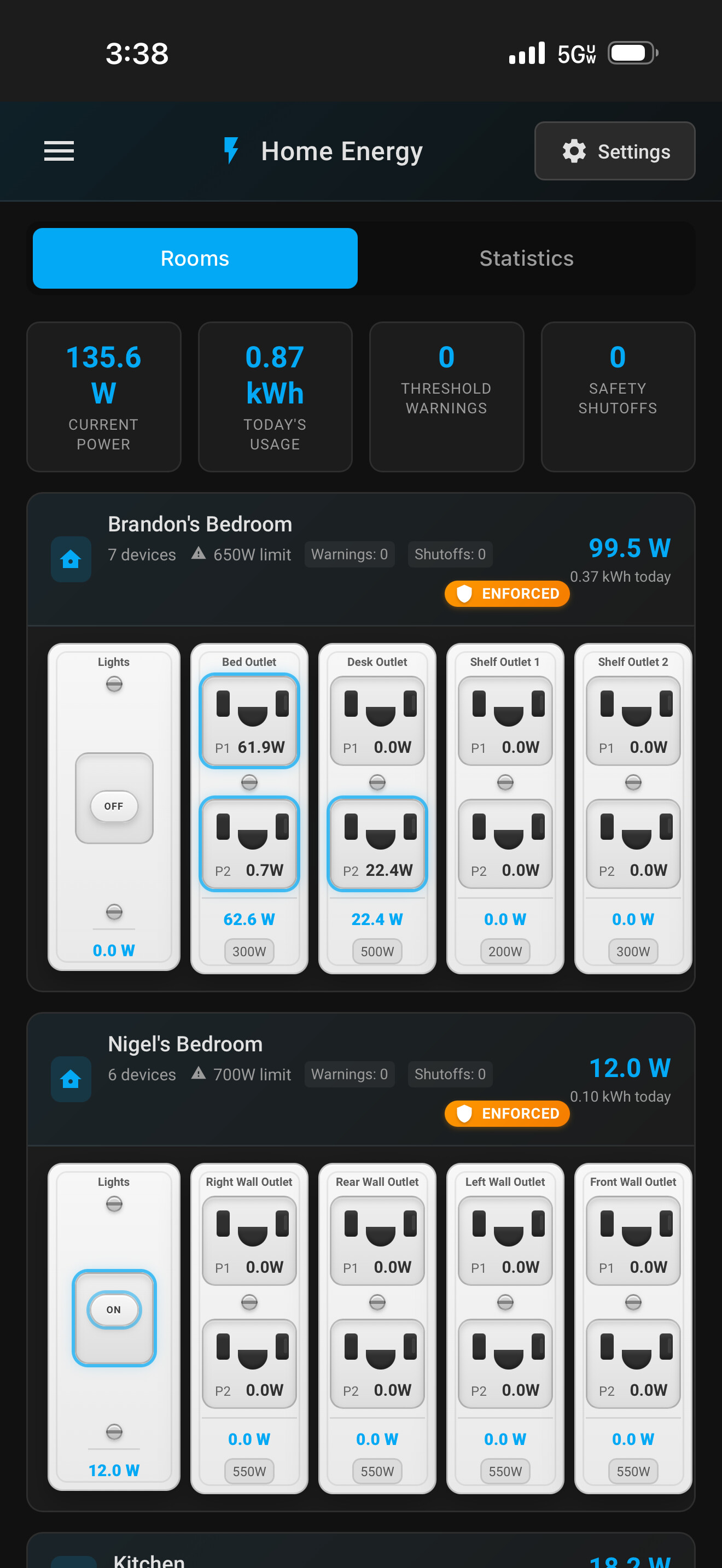

@finity like you I have tons of projects lol some come some go like my Textnow which fluffing awesome but seems Textnow won’t approve usage of their api
Or this cool project which monitors smart outlets and enforces low electric usage in my home
And pretty much all the blueprints in my sig signature will be ported over to being an intergration with a panel I prefer it that way running python in backend so much better
It’s not only the built-in HA dashboards that can be set as default. It’s any dashboard whether it’s system or user created. The integration panel isn’t a dashboard tho so you can’t select it.
And I have no idea how to make it a dashboard.
I just put a direct link to it in my side-bar using “panel_custom”.
i didnt catch that gotcha (panel dashboard).
Ill submit a feature request for it
