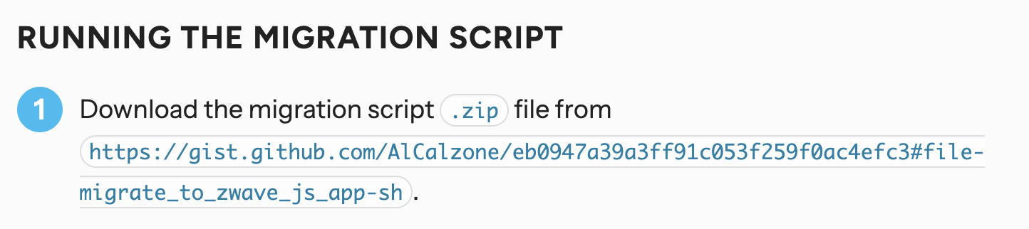

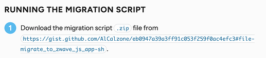

This is not linking to a zip, but to the shell script:
Should it just be a link to the raw script? The Advanced SSH app has wget. Would it be easier in the step where you ssh into /tmp to then to have an wget command to copy-and-paste to download the script?

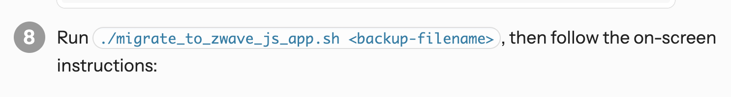

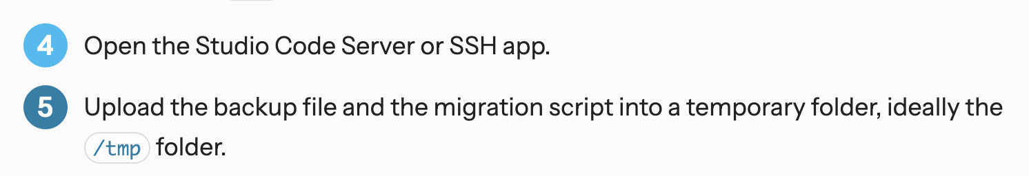

I feel like this could be challenging w/o some examples. How many people migrating have ever ssh’d into HA?
This is what I did, but I have SSH all configured:
$ scp -O migrate_to_zwave_js_app.sh store-backup_20260227190257.zip argon:/tmp
migrate_to_zwave_js_app.sh                              100% 7527   764.4KB/s   00:00
store-backup_20260227190257.zip                         100%   12KB   1.1MB/s   00:00
This worked w/o any problems:
Should this explain don’t check if using the GPIO module, or maybe just remove this and link to the next step in the instructions?

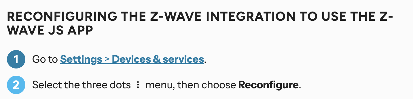

[migrate] You can now reconfigure the Z-Wave integration as follows:
[migrate] If using a USB or TCP based controller:
[migrate]   - CHECK 'Use the Z-Wave Supervisor app'
[migrate] Otherwise:
[migrate]   - DO NOT check 'Use the Supervisor app'
[migrate]   - URL: ws://core-zwave-js:3000

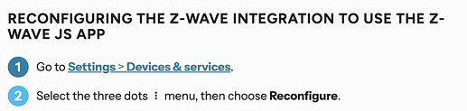

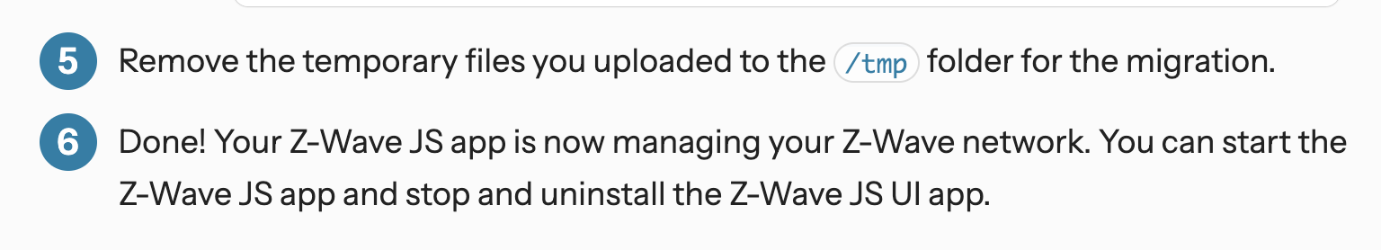

This is missing “click on z-wave integraton”
Should this step include “Remove the old ZUI app”?

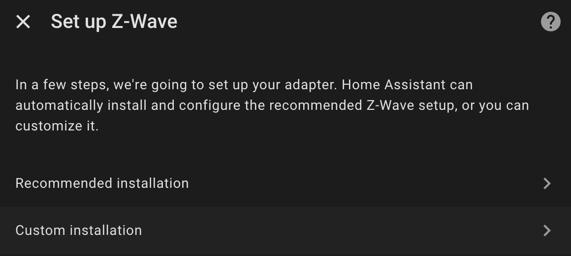

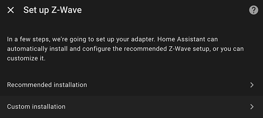

I always find this dialog confusing. If you click on “Recommended installation” HA will immediately start downloading the core app if not already done.

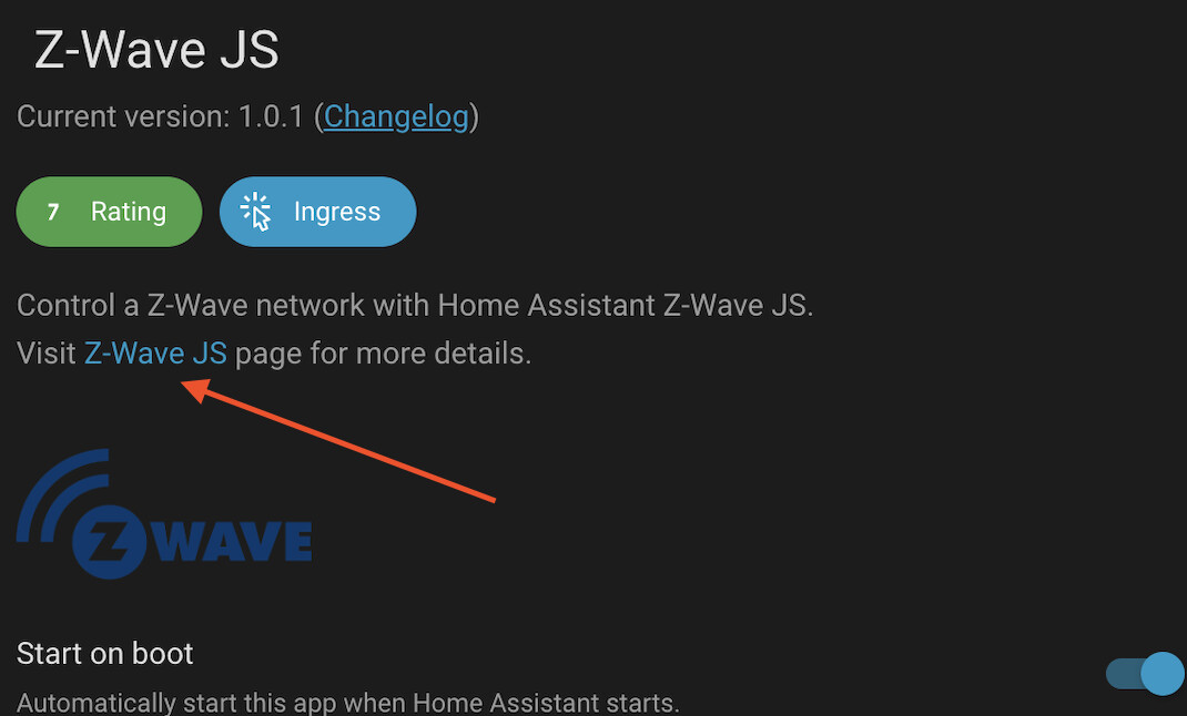

This link here leads to the add-on page, which doesn’t really have any details (well, other than the code).
Might be a little helpful, but you also need to get the store backup zip file into /tmp as well. In my case, I have the /share folder samba mounted to my PC, so I downloaded both the store backup files and the shell script and put them in the /share folder, and from there in the Adv SSH & Web Terminal has access to the /share folder so I next “cp”'d these two files into /tmp dir of the Adv SSH &Web Terminal.
BTW I did just now try out your idea of wget. The following worked for me in Adv SSH & Web Terminal
wget "https://gist.githubusercontent.com/AlCalzone/eb0947a39a3ff91c053f259f0ac4efc3/raw/69494c1671a04ba81b5ffb6060037ccf02a57fb2/migrate_to_zwave_js_app.sh"
For what its worth, I didn’t get that dialog. Is that dialog from the ZWA-2 Integration? If it is, then it would explain why I didn’t get it as I don’t have a ZWA-2.
It’s what you get the first time you add the integration or if you “Add hub” later.
It just confused me (which isn’t hard) a few times early on. Of course you want the Recommended way!
I haven’t thought about it but seems like a if you do not have the app installed is could say “Click continue to install the Z-wave app and configure it.” but also have an “Advanced” or “Manual” option. And if the core app is installed then only offer the Advanced option. Or something like that.
But, that’s starting to sound feature-requesty.
Hmm… in this situation, the integration is already there, and according to the instructions one is not Adding a Hub (meaning adding a second instance), but instead “Reconfiguring” the existing instance.
You are right. Sorry. It was more of a side note. Just to test, I first clicked on the z-wave integration and saw that dialog and pasted it in my post. I clicked Recommended and away it went installing the core app. Unrelated to migration but something I find a bit confusing.

Choosing that is supposed to install the core app, as that’s the recommended installation.
