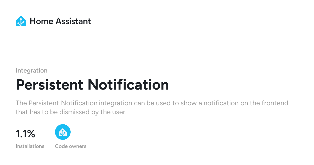

You can’t just make things up… There are only 3 configuration variables allowed under data for persistent notifications.
Your options are to add a timestamp to the title or message.
action: notify.persistent_notification
metadata: {}
  message: The pump turned on
  title: "{{ now() }}"
metadata: {}
  message: The pump turned on at {{now()}}
