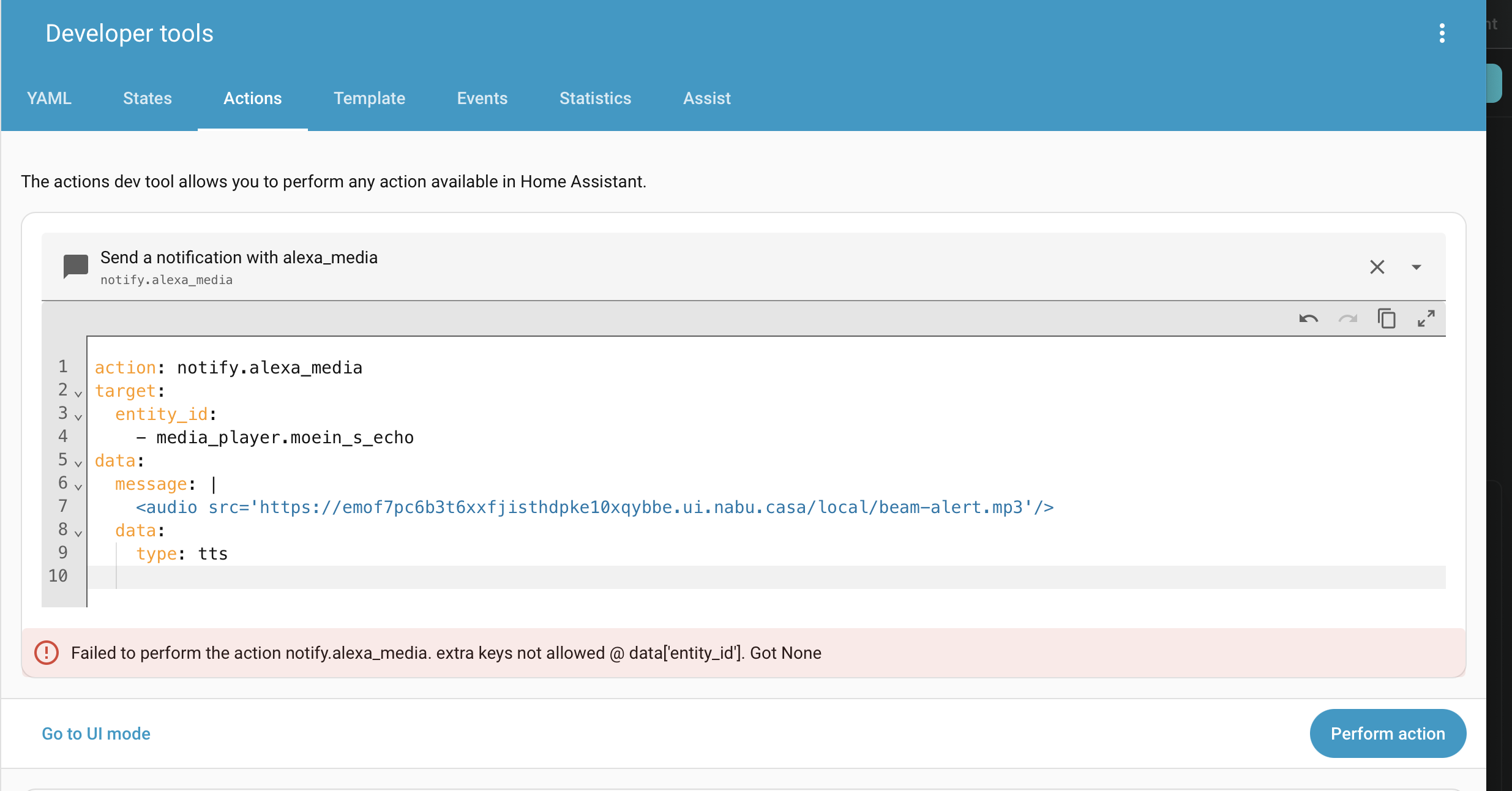

Hi , so I have looked at this for a long time and and unfortunately I cant figure it out : im trying to make Alexa play a 20 sec custom sound. Below is a screenshot of what I have tried :
Link to sound file : https://emof7pc6b3t6xxfjisthdpke10xqybbe.ui.nabu.casa/local/beam-alert.mp3
My echo is named : moein_s_echo
Amazon has strict requirements for audio notifications through Alexa, including bit rate, which is what seems to be causing the failure in this case.
From Alexa SSML Reference - Audio:
The bit rate of the linked file appears to be 44.1kbps.
