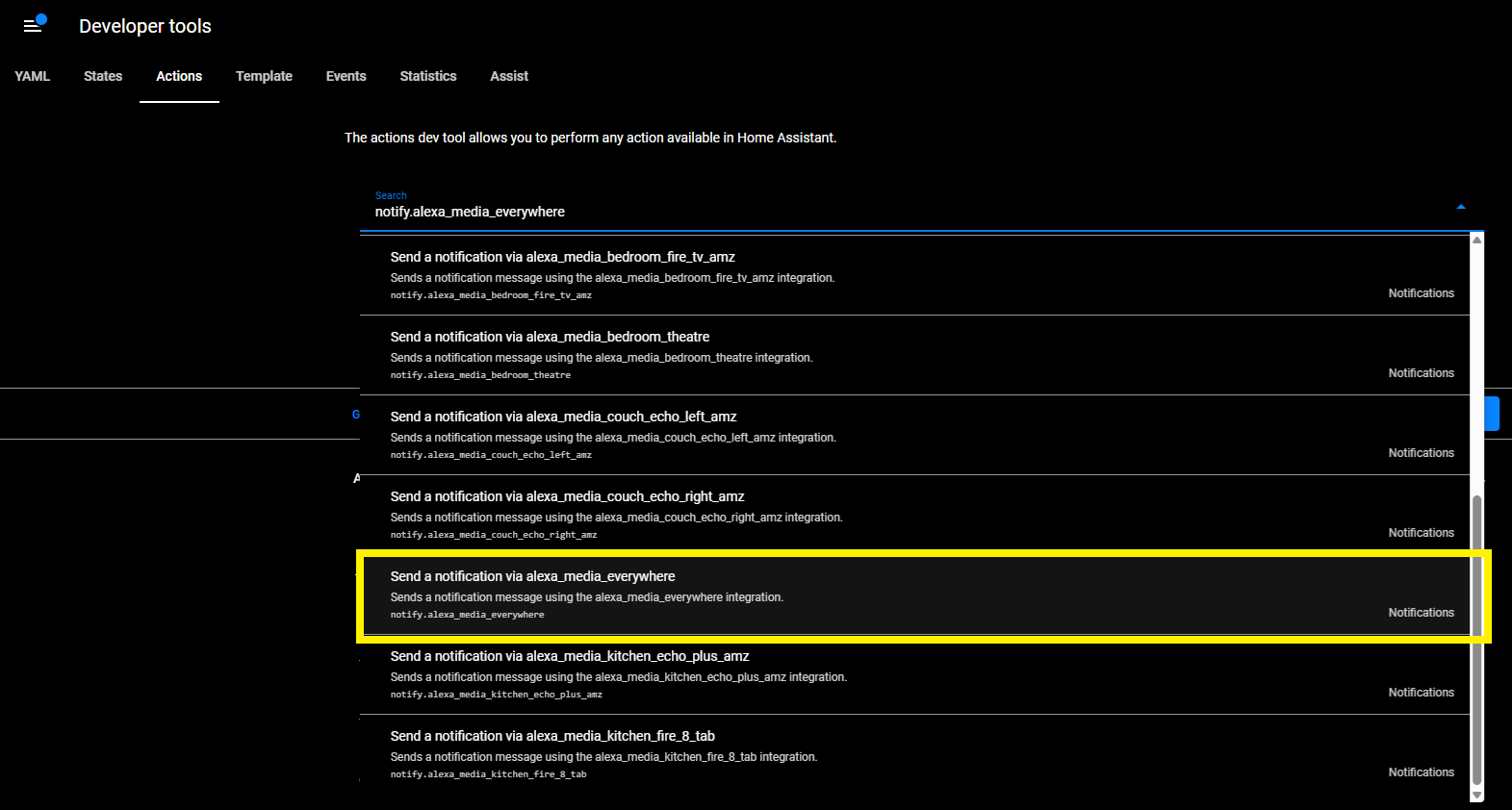

Looking under Developer Tools -> Actions, the action no longer exists!
Was it deleted or broken from the latest upgrade?
Alexa itself is not working as expected.
Actually, I realized that all my Alexa devices are now unavailable…
finity
July 14, 2025, 2:04am
4

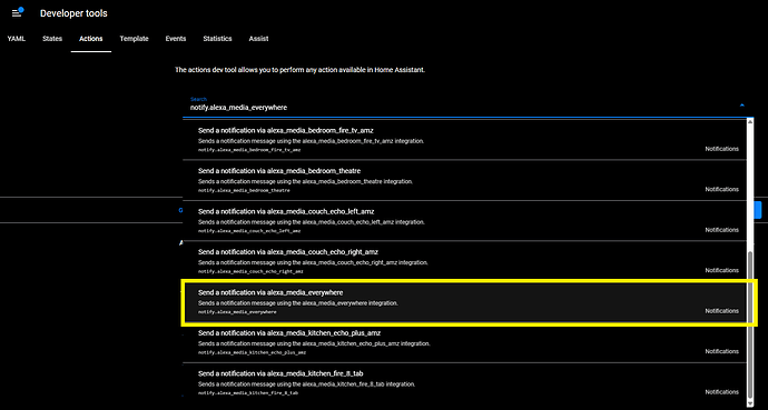

I don’t have the “everywhere” notification available but the rest of mine are working. I actually don’t remember the last time I saw the “everywhere” notification available since I never use it.
