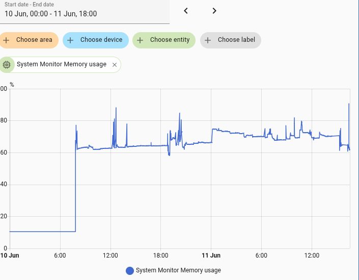

A few days ago, I reported that my “System Monitor Memory usage” had unexpectedly jumped and stayed excessively high?
Now, I notice that I am unable to compile anything. At first I thought that it was just the small amendment that I was trying to make. Now after trying to minimise the task, I find that I can not even compile the “test.yaml”:

Don’t know if its related but “System Monitor Memory usage” is still running at 60%?
