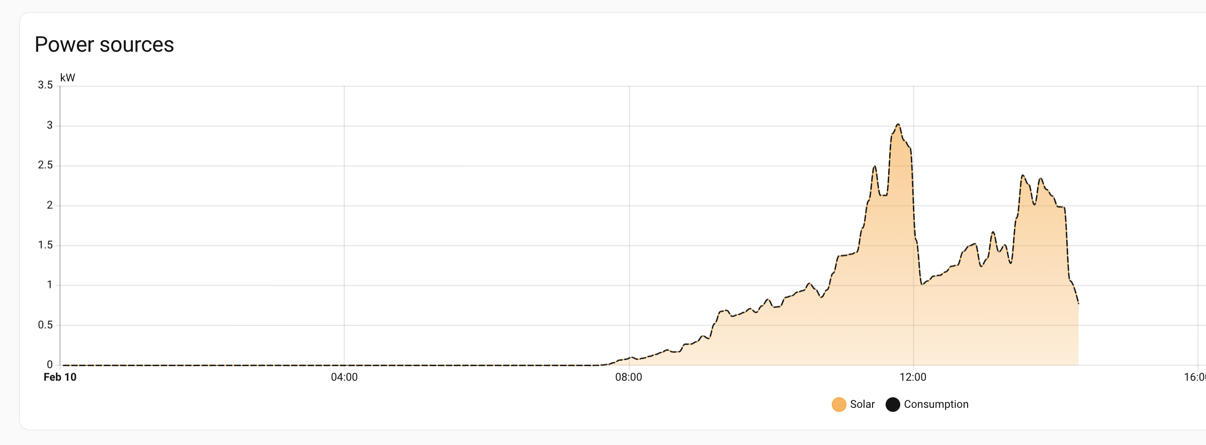

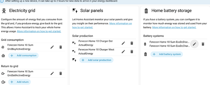

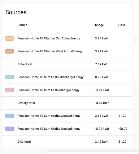

I am not sure what I have setup wrongly but in HA, the Now tab in the Energy Dashboard shows the Production as the same as the Consumption value

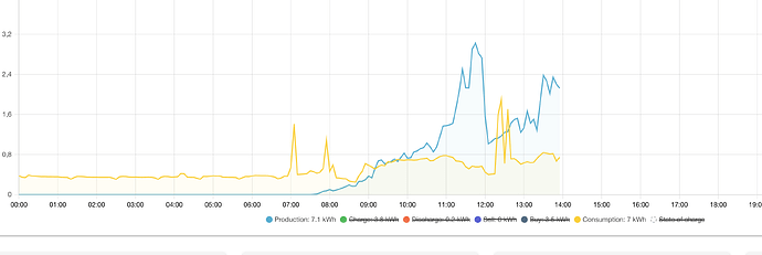

In my Fenecon Dashboard it looks like this:

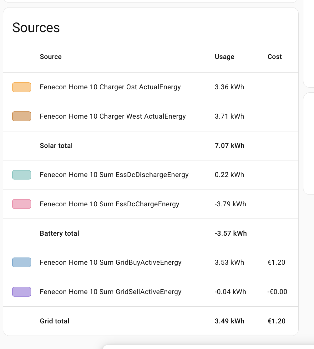

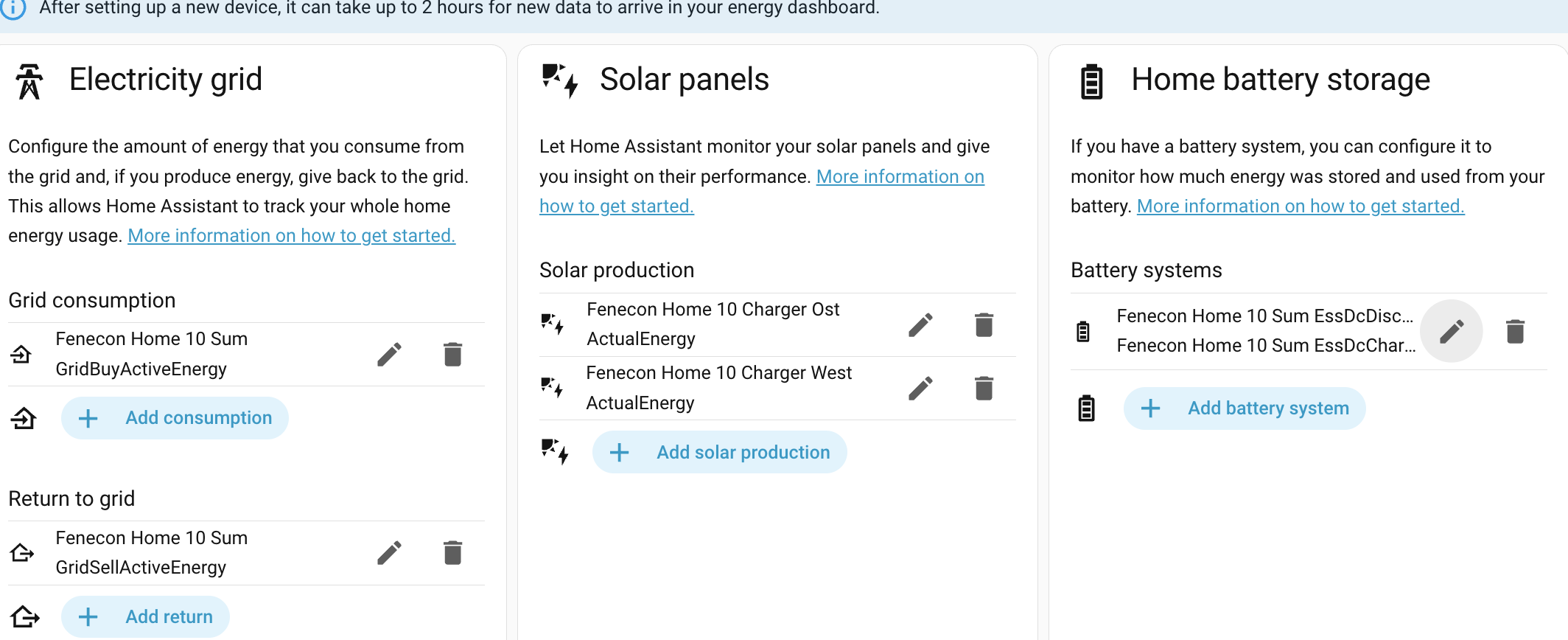

I think I have correctly setup the inputs
Does someone knows what could of be wrong here? Or what should I check to find the issue.
Thanks in advance!
I found the problem thanks to github. A layer 8 problem.
I didn’t configured the Power Sensors, I just got the Energy ones.

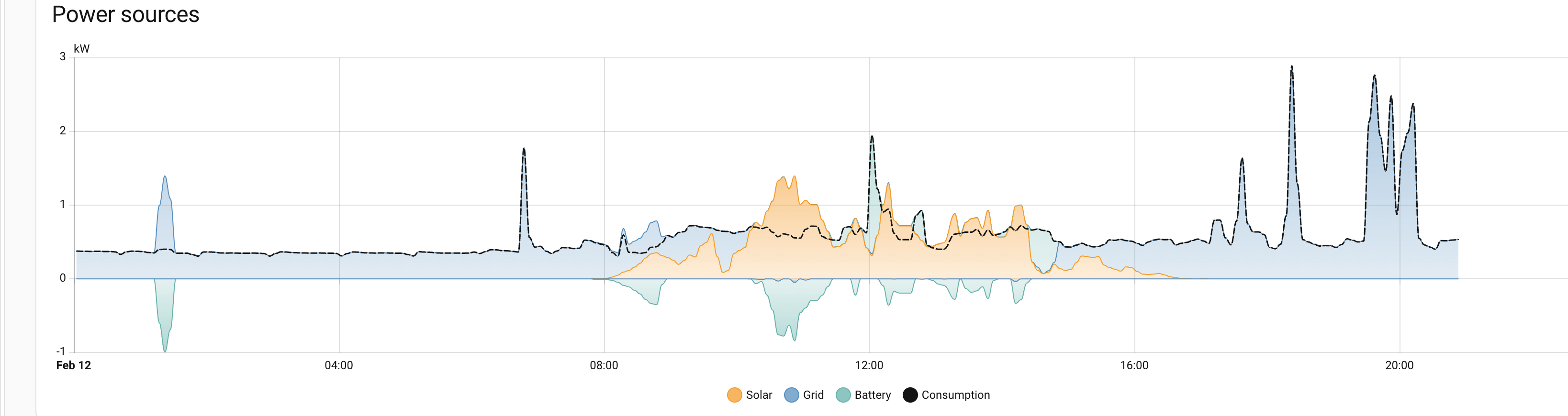

I added Fenecon Home 10 Sum GridActivePower as Grid Power Sensor and EssDischargePower as The Battery Power Sensor and now looks correct (I think).
