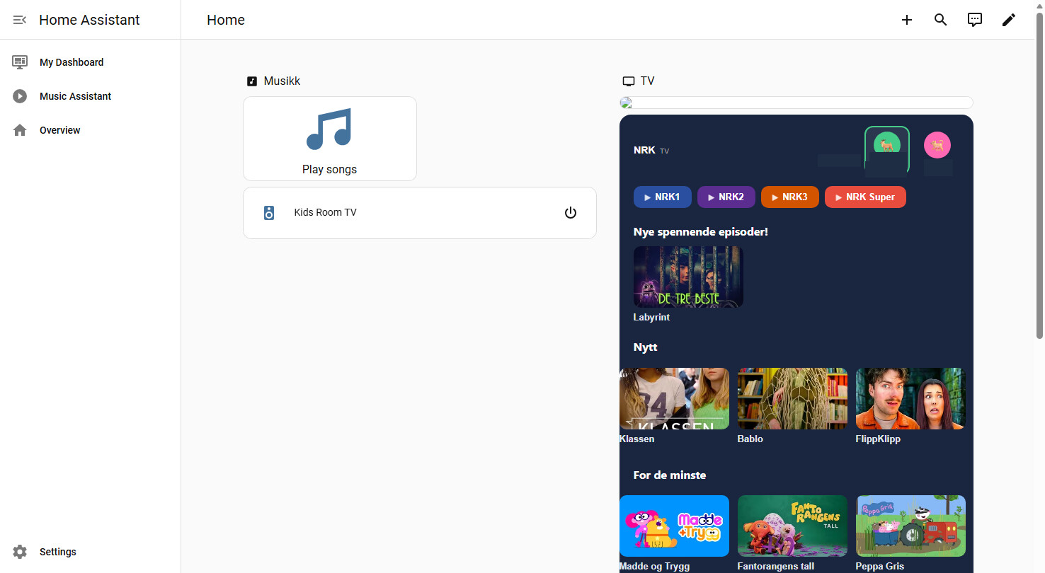

:art: NRK TV Card
GitHub: filipferris/ha-nrk-tv-card
A custom Lovelace card that replicates the tv.nrk.no browsing experience:
  • Profile switching with avatars (adult/children profiles)
  • Live channel buttons (NRK1, NRK2, NRK3, NRK Super)
  • Scrollable show grid with thumbnails from NRK’s API
  • Click a show → browse seasons → pick an episode → plays on your TV
  • Responsive design for tablets and phones
