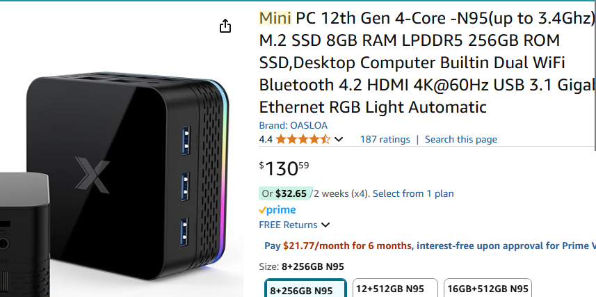

Thanks for the inputs. In a way I’m glad no one’s insisted I carry on with the Pi. I’m looking at buying this plus a 12V3A Mini UPS.

I’m looking at something basic and compact that can output 12V 3A, like this. It says surge protection too so I’m drawn to that. I’m just not sure if a mini pc such as this, running on 100% load, will draw power more than 3A, even momentarily. Also, I’m not sure if a mini PC would throttle when it hits a peak current draw (like the Rpi does when it hits a peak temperature value). My “full load” here would include turning on/off up to 40-50 relay switches, using 50-60 motion detection sensors (20% WiFi based that sort of spam values and the rest 80% LoraWAN based) - no fancy face or voice recognition sh*t using cctv footage.

It’s not only these ‘packed with NVMe stick’ devices that can flake out and leave you head scratching. One of my earlier tries on a device similar to the one you cite (I have no experience with the one you cite, so I am NOT bad mouthing it), where the NVMe drive would get to a temperature and just drop off the buss (not good Dave). And at time I did not have a good handle on how to monitor NVMe temperature and errors.
