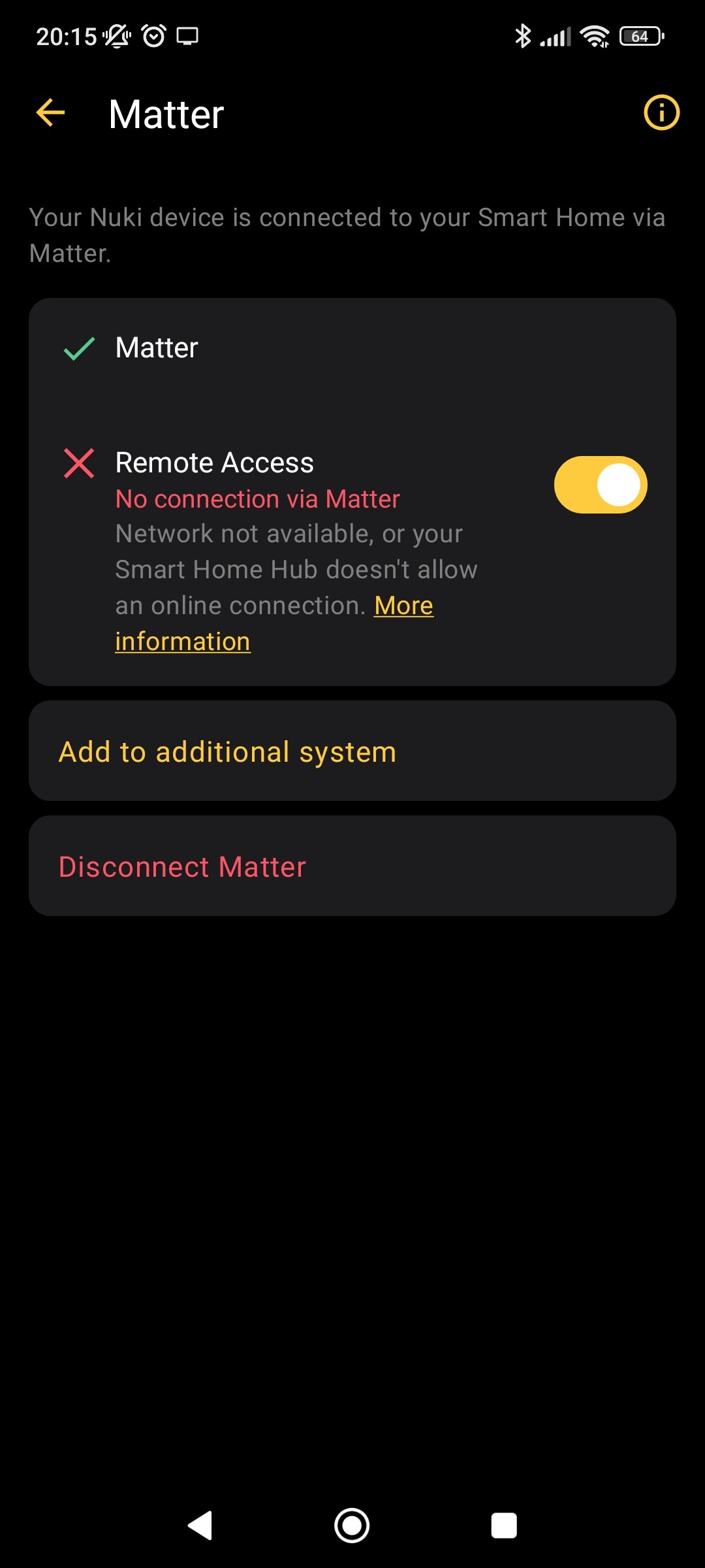

Everything Worked so far. When I opened the nuki app a little while later, The Matter Settings tell me, that Remote Access is enabled, but not working Correctly:

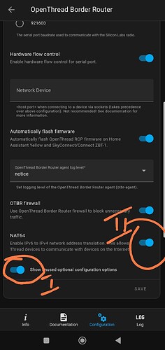

My Assumption is, that maybe NAT64 is not enabled on my Open Thread Border Router. I have not specifically enabled it during the setup, as I have not seen this option anywhere.
Does anyone know, where I can enable this Option in Home Assistant? I have not found any hints in google about it…
This is in Settings, Add-ons, OpenThread Border Router, configuration. Enable “show unused optional configuration options” then you find NAT64 to activate. Save and restart OTBR.
Thanks, in the meantime I also finally found it and enabled it. After uninstalling everything again and starting fresh, it now also works…
