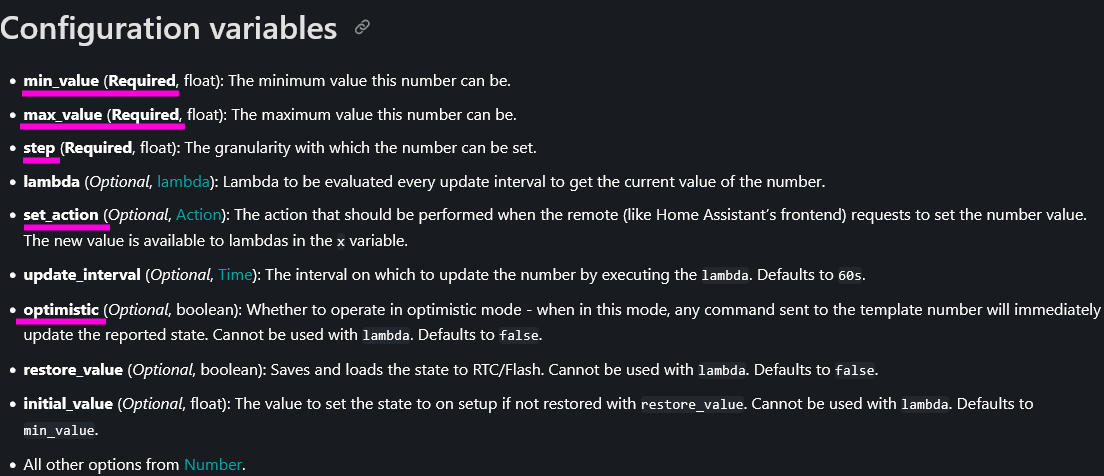

They are all in the template number component configuration options. Right here: https://esphome.io/components/number/template/#configuration-variables
Note what the very last line says.
So how to I create a number component - not a number template?
Or more likely how do I know I cannot create a number component ?
You don’t. As I said that is the base component. You need to create a “type” of number component. In this case a template number.
That is what all the configuration options you are missing are listed under as in the image I shared and linked to above.
I think you are getting hung up on the fact that the example shown in the documentation for this component does not have all the options in the example yaml. It is a simple example. You can still add more options to it from the list of valid ones.

set_action and optimistic_mode are the 2 mode options that establish how your number entity will function/behave whenever a number is set from the frontend so, without you instructing it by setting one of the two options then it doesnt know how its supposed to handle a number when someone sets a number.
