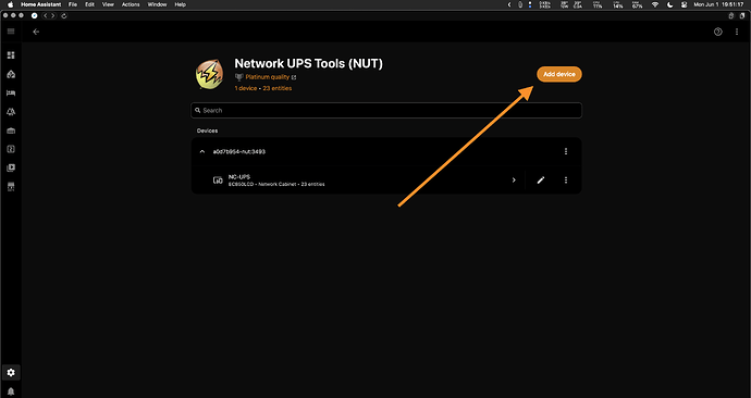

Hey @yvs21, I know you've got it working but unless I'm misunderstanding, you can.
If you just need HAOS to
A. Be the server to connect the local UPS
B. Then monitor the status sensors on both UPSes
That is fully possible, you just need to add another entry to the NUT integration with the remote connection details.
@Inventor7777, thanks so much for the tip!
I tried this before, but I got lost in the trees. I was trying to connect to remote servers in NETCLIENT mode, but I couldn't connect the local UPS. You've opened my eyes to a simple, standard solution. Everything works now.
