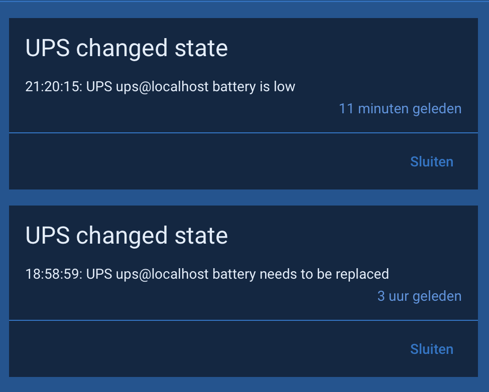

All of a sudden my phone got delivered these alerts… Still new to the UPS and NUT (been running it for a week or 2 now).
Which makes the notification all the more remarkable to me. It is a new device, so I wouldnt expect the battery to be in need of replacement at all :wink:

right, so I returned the device used above, and waited a few months, only to experience a power out the other day…
so, I ordered a new UPS, and lo and behold, within minutes of installing it, the same loggings returned
this must be a fluke, and the first thing I did was edit the automation to Not issue critical warnings on that anymore.

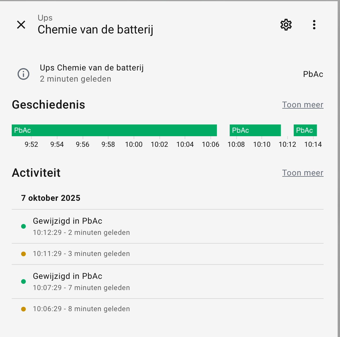

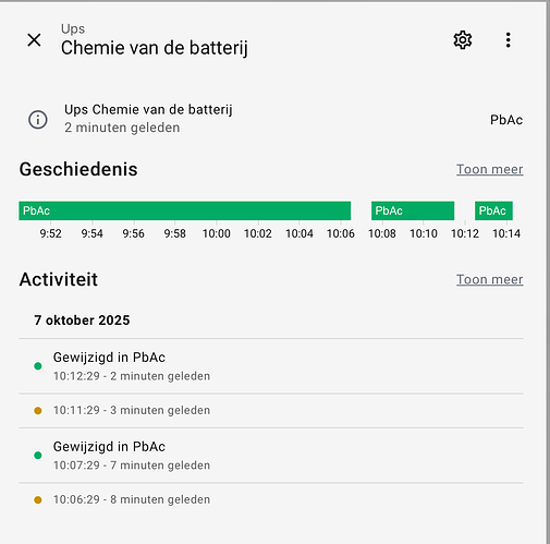

in the device dashboard, the only entity I could find that was out of the regular, was the battery chemistry (sensor.ups_chemie_van_de_batterij in Dutch) having no value/state. I saw it getting back to PbAc later on.
Maybe that is some sort of selftest in the Integration/Add-on.
to be able to what the history of some of the important entities, I now enabled them in the recorder, maybe that will show problems if and when the next notification is issued…
I do see this
but these times dont coincide with any notification I got…
