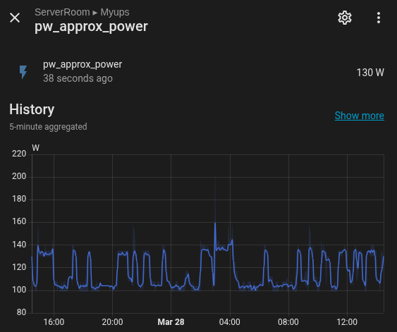

I also didn’t have power nor current, but I did have a load [%].
So, knowing the maximum power [450W] it could deliver, I created a helper
{{((states("sensor.myups_load") | int / 100) * 450) | round(0)}}
Which calculates the (approximate) power consumption…

Actually… I measured it with a kWh meter, and was surprised to see the formula was wrong :scream:….
So going back to the manual again, and turns out I have the 750VA model (and not the 500VA), which also states 450W in the manual :laughing:
So my original formula was correct with a power factor of 0.6 :wink:
750 * 0.6 = 450 Watt
