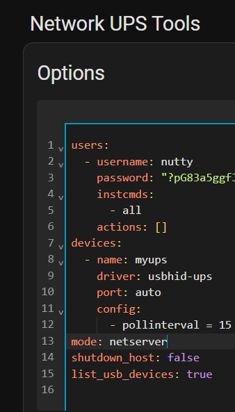

I am having a combination of issues. When I plug UPS USB in it works for about 15 minutes before data going stale. I am able to add the device, it is recognized, and I am able to create automations based on its status. Unfortunately, once UPS reads as stale I can’t simply restart Network UPS Tools because I get the libusb1: Could not open any HID devices: insufficient permissions on everything error. At that point I can unplug\replug the USB into the UPS and it works for 15 minutes or so. I’ve tried changing the poll interval but nothing works.

I don’t think this helps in my situation. Even when I reboot the server the UPS isn’t recognized. The only thing that seems to “wake it up” is when I unplug the USB from the UPS itself. I’m starting to think it’s an issue with the UPS itself, may test with another UPS.
That is a good idea, but it could be a USB driver problem on either end. As always make sure the USB driver firmware is up to date.
