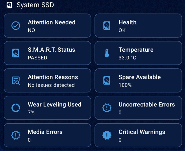

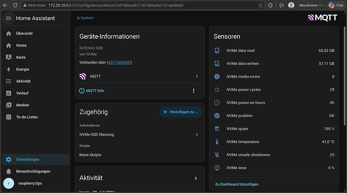

  • Reads the NVMe SMART log on the host and publishes everything via MQTT discovery – the device and sensors appear automatically, no YAML or templating.
  • ~10 sensors: wear (percentage_used), available spare, temperature, data written/read (TBW), power-on hours, power cycles, unsafe shutdowns, media errors – plus a “Problem” binary sensor with configurable thresholds, perfect for a single notification automation.

  3. Install NVMe SMART Monitor, start it – the device + sensors show up under the MQTT integration within a few seconds.

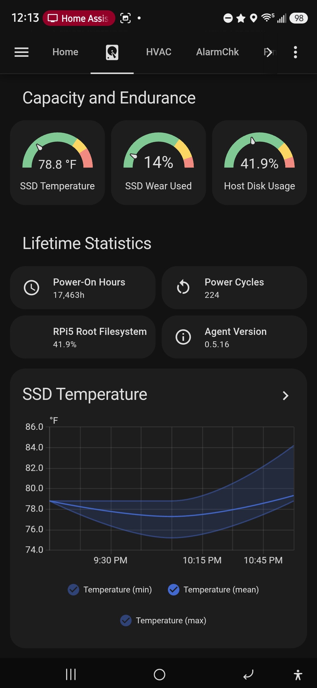

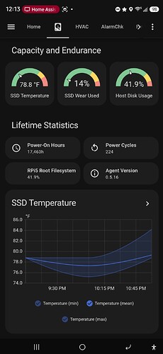

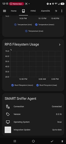

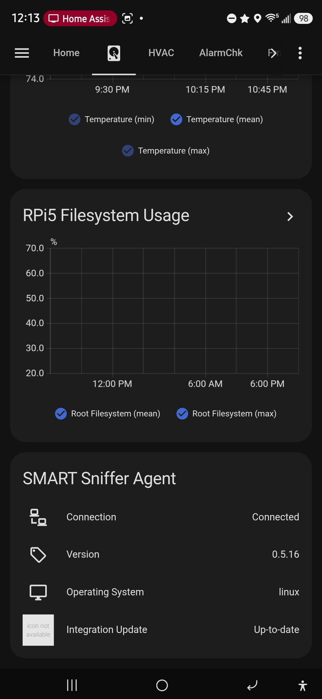

Thanks so @tom_l @smarthome-praxis for the idea and guidance, now it’s one of my UI-Minimalist dashboards!
