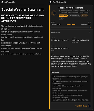

NWS Alerts Card

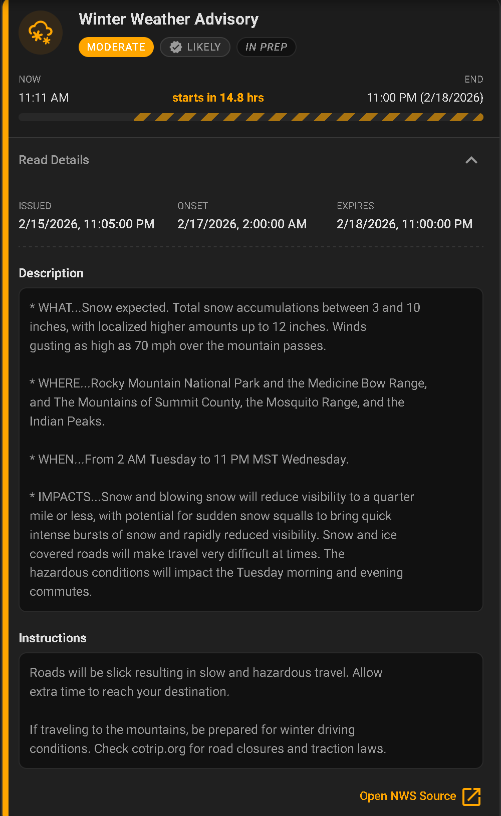

I’ve been developing a card for displaying information from the NWS Alerts custom integration.
This card is display-layer only and does NOT interact directly with the NWS API. The above integration is a hard requirement.
Motivation
I live in an area where fire season, winter weather, and damaging high winds frequently occur simultaneously or in quick succession. I wanted more temporal information about each specific alert available at-a-glance, and the more detailed information clearly delimited to mitigate the dense walls of text that can sometimes accompany these alerts.
Features

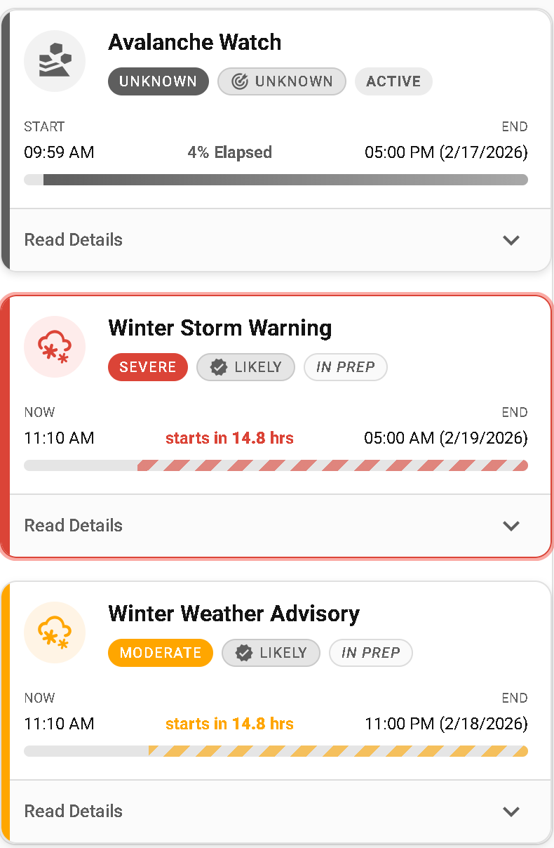

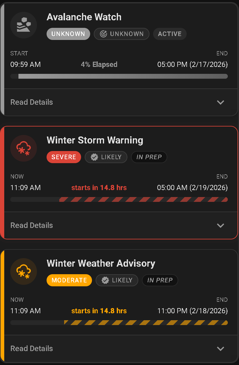

  • Severity-based color coding with animated borders for extreme/severe alerts
  • Progress bars showing elapsed/remaining time for each alert

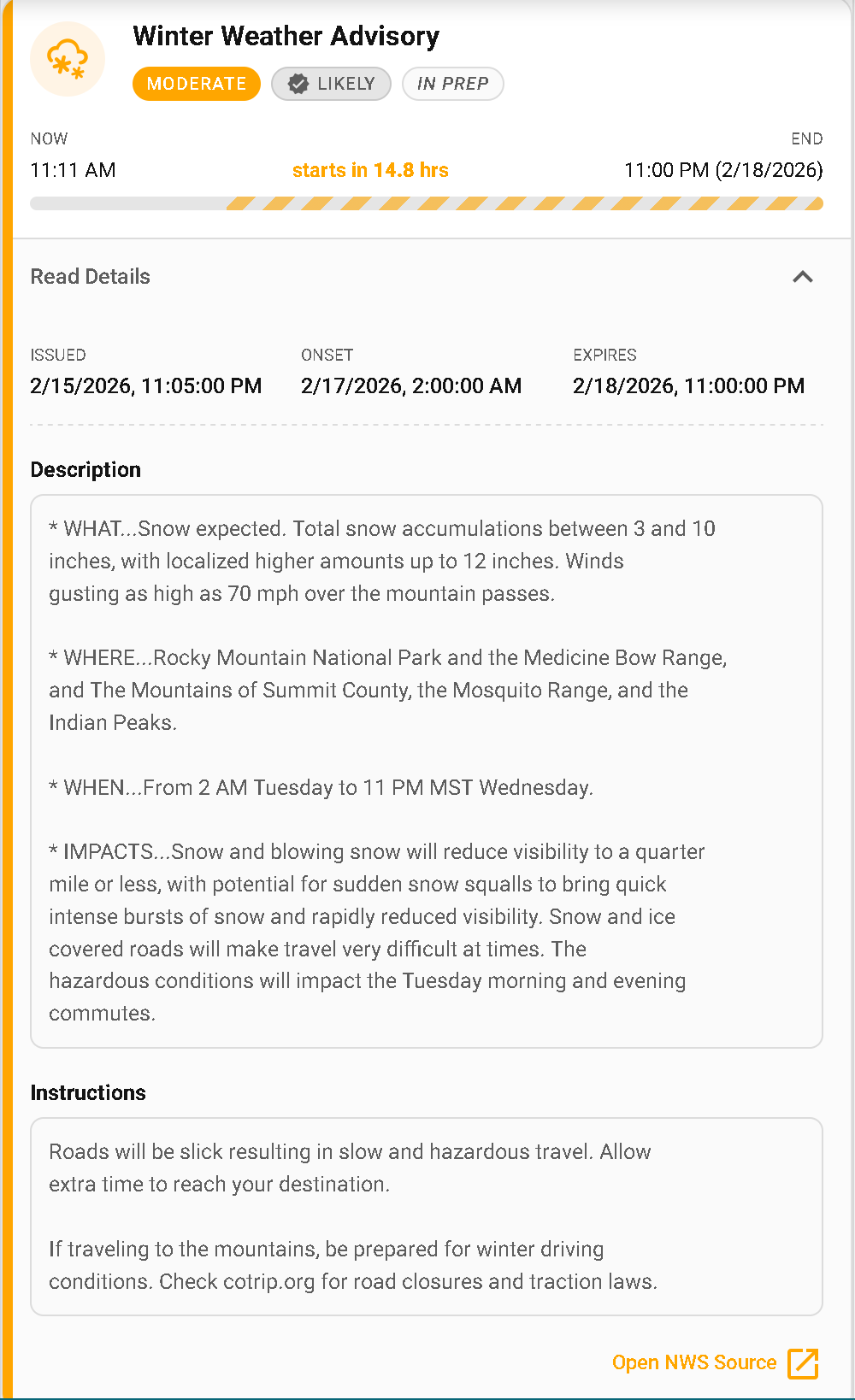

  • Expandable details with description, instructions, and NWS source link
  • Zone-based alert filtering
  • Card picker integration (add from HA UI)
  • Visual editor support (basic configuration, hopefully more to come)
What’s next
Besides more visual polish and deeper support for more weather conditions, I’m unsure of what might come next here. If there is interest, I’m very open to feature requests, bug reports, etc. and I will do my best to be responsive.
Screenshots

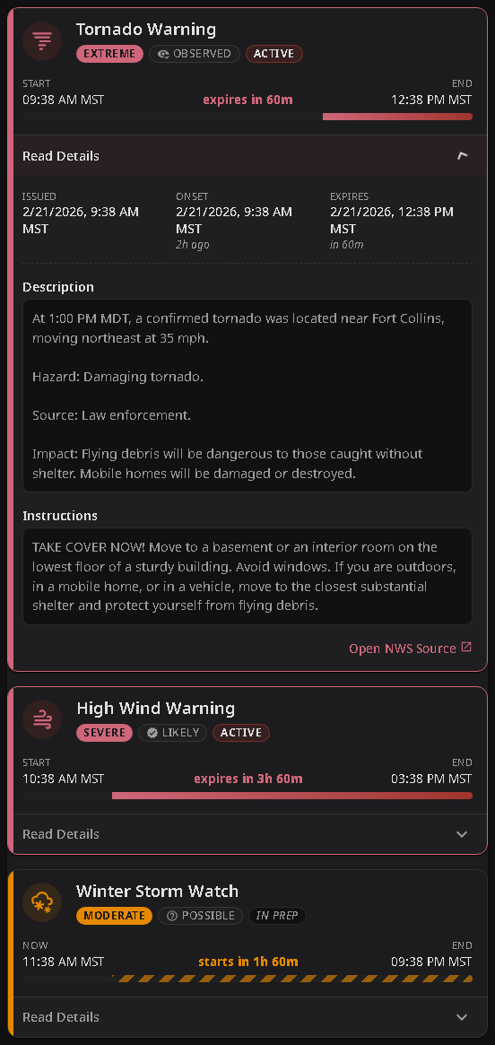

  • Official NWS Colors: Added a colorTheme option to switch from severity-based colors to the official NWS hazard-map colors (e.g., Tornado Warnings in Red, Flash Flood in Dark Red).

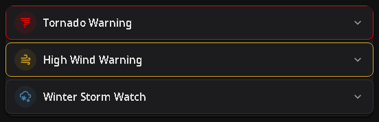

  • Compact Layout: A new layout: compact mode for dense dashboards that uses slim, expandable rows to save space.
  • Smart Contrast: Severity badges now use WCAG luminance checking to automatically switch between light and dark text based on the background color—no more invisible labels in light mode!

Screenshots
Compact
Details open
Thanks to everyone for the feedback so far! If you run into any issues with the HACS version, feel free to ping me here or on GitHub.

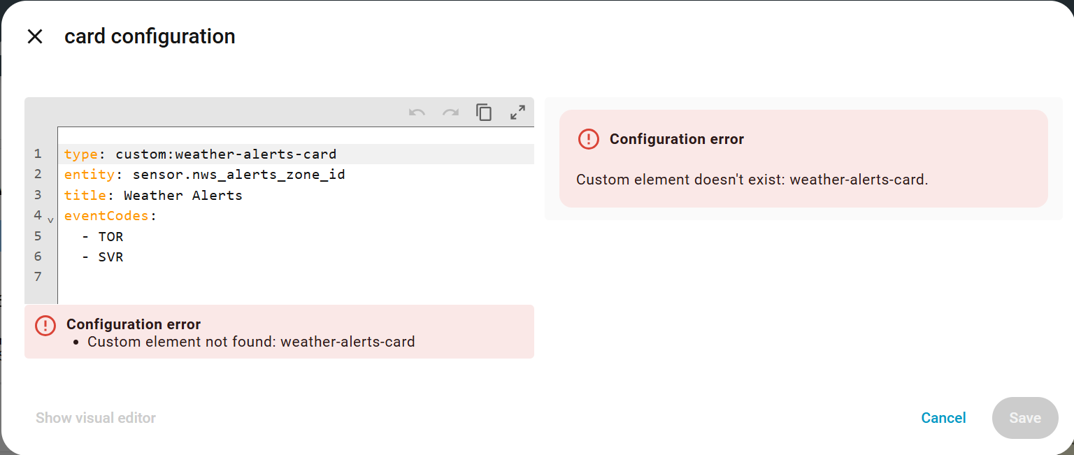

I’ve installed this card via HACS, reloaded the page and I’m getting an error.
I get this error on all of my devices. Google Chrome on W10, HA Companion App on iOS and macOS, Firefox on W10. Running HA 2026.1.3 in a container from my NAS.

I was wondering if it’s possible to add the alerts Headline to the card? As you can see when you compare the Weather Alerts card to plain markup, events like “Special Weather Statement” are kind of ambiguous without the headline. Thanks!
Check the www/community folder and make sure there is a folder in there called “weather_alerts_card” and that it also exists in your lovelace resources.
I added it to my resources manually via yaml so I don’t know where HACS puts it but I think I remember when I let HACS handle the resources for the card on initial install it gave me the same error until I added it manually (as I do for all my other custom cards).

I can’t believe I totally forgot to display this. Gonna make an issue to track this and try a few things out tomorrow. Thanks for the feature request!
EDIT: feat: display alert headlines on the card · Issue #74 · seevee/weather_alerts_card · GitHub now tracking this feature. Feel free to add detail!
EDIT 2: Implemented in v2.5.0-alpha.2, let me know what you think!

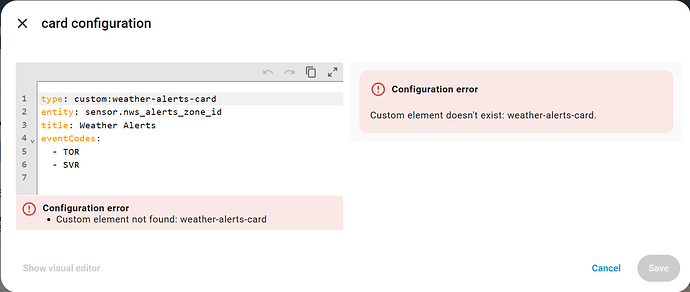

Following on from finity’s advice - this is almost definitely a resource loading issue.
  1. Check Resources — Go to Settings → Dashboards → three-dot menu → Resources and
    confirm there’s an entry pointing to
    /hacsfiles/weather_alerts_card/weather-alerts-card.js (type: JavaScript Module)
  2. If no entry exists, add it manually
  3. Hard refresh the browser (Ctrl+Shift+R / Cmd+Shift+R)
Here’s the entry that HACS made for me, for reference:
Yes the resource entry is there. And yes I did a hard refresh of my browsers. It still was giving me the configuration error.
I just updated to v2.4.0 and now the card is appearing at least on the HA Companion App on iOS. It’ll be a couple hours before I can check the browsers on W10.
EDIT: The card is appearing correctly now on all browsers and devices without needing to hard refresh after updating to v2.4.0
