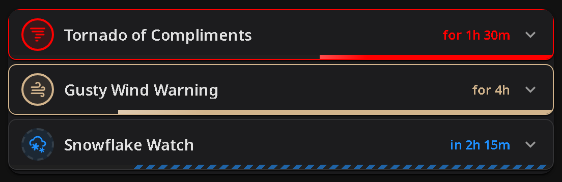

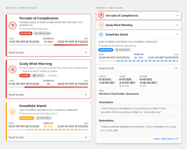

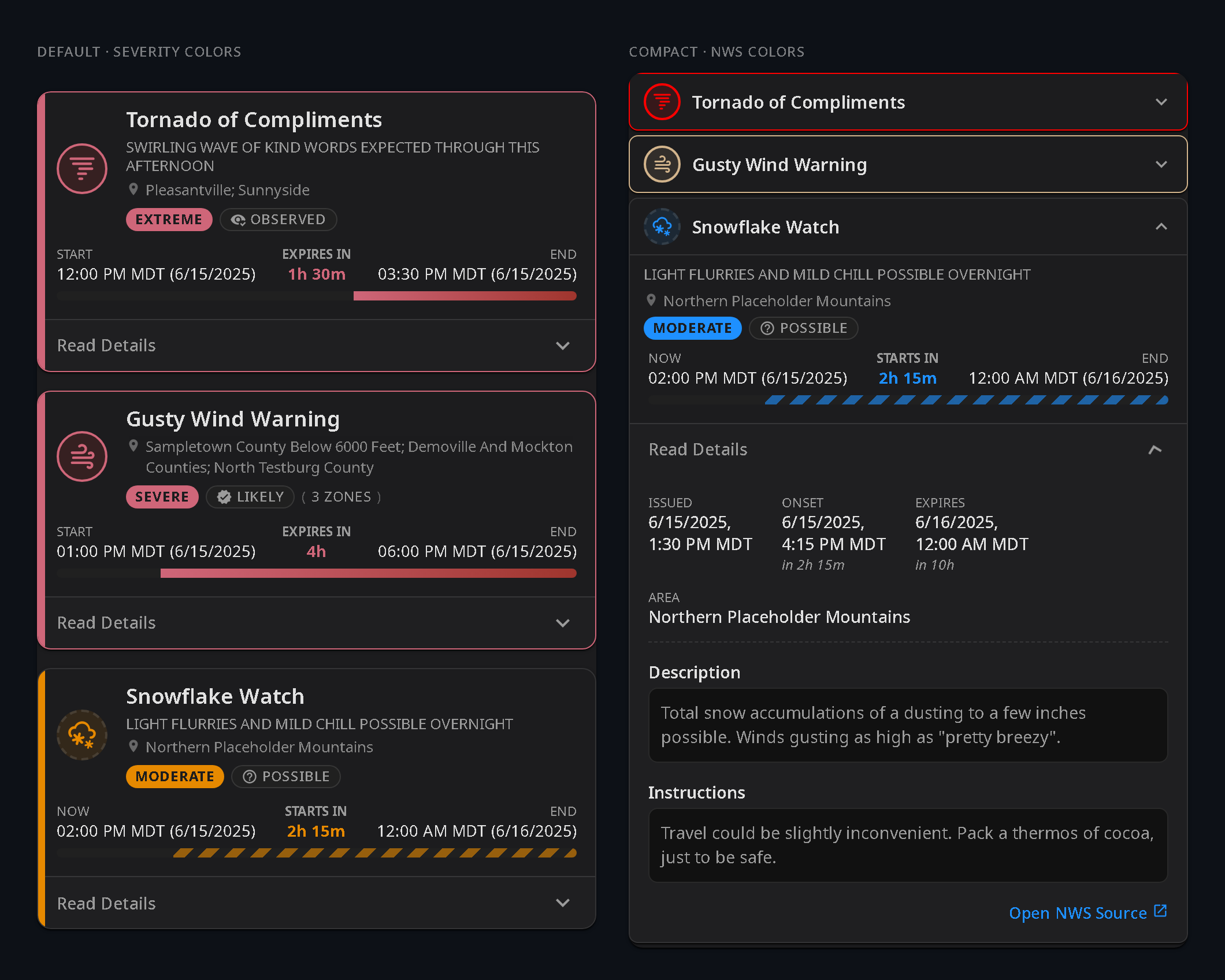

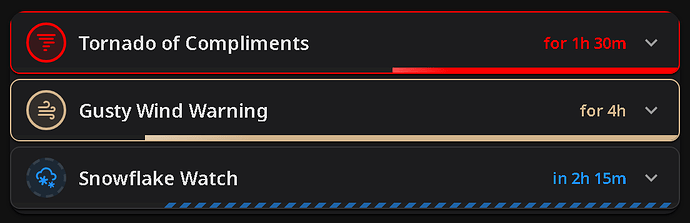

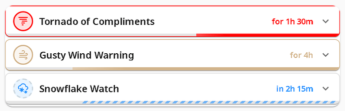

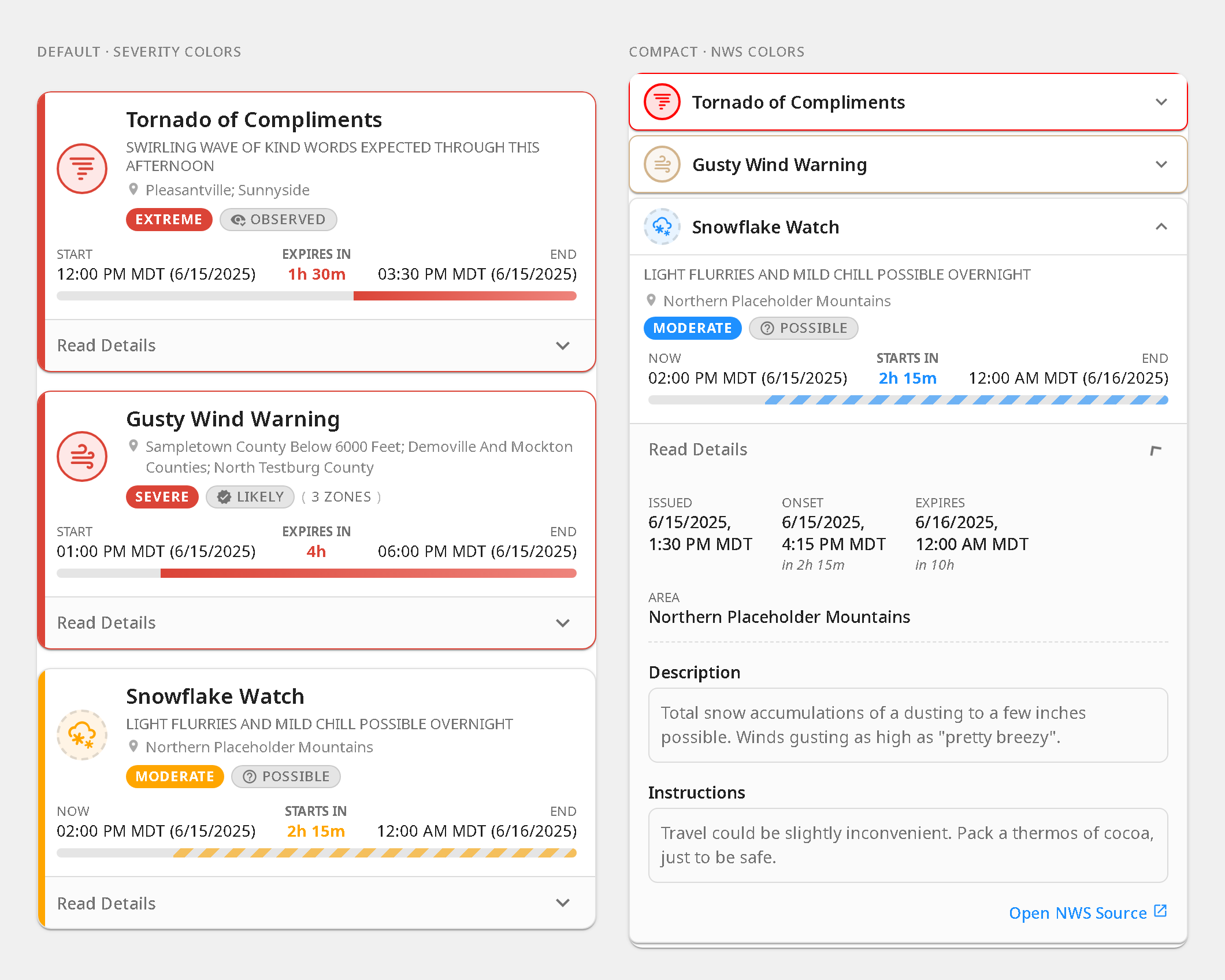

v2.6.0 is out with a couple of additions:
Compact layout gets some love — single-row alerts now with inline progress bars that expand on tap. Great for sidebar panels or space-constrained dashboards.
Set layout: compact in YAML or pick it from the visual editor.

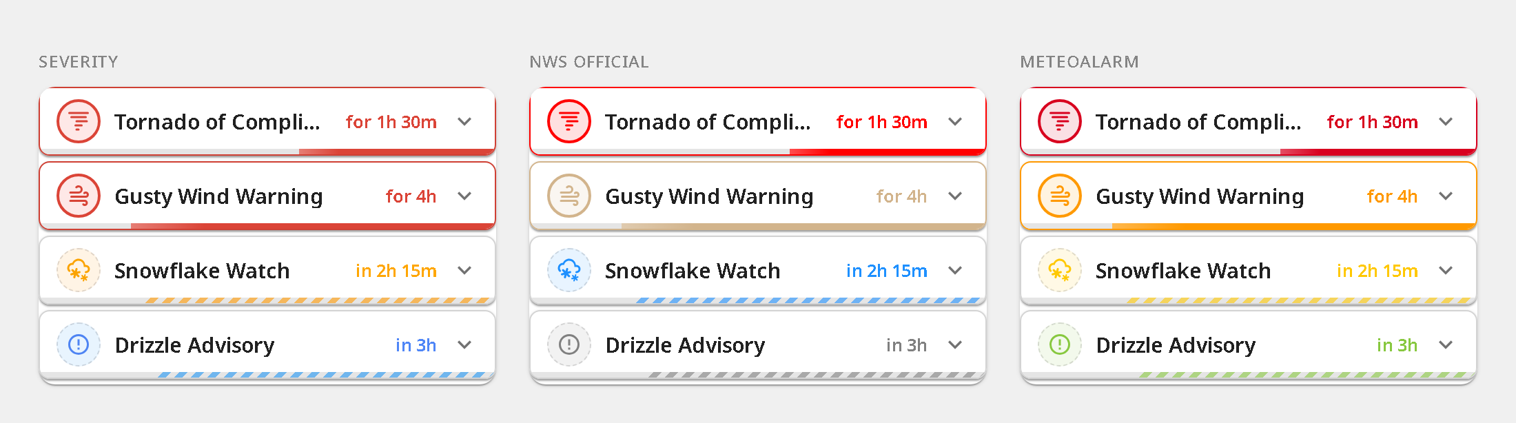

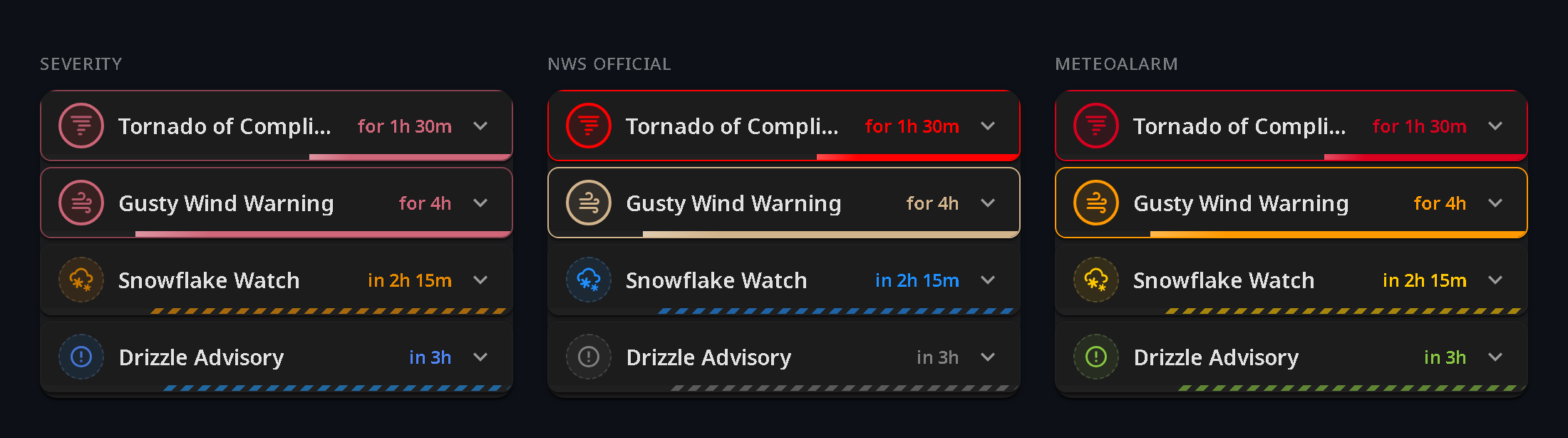

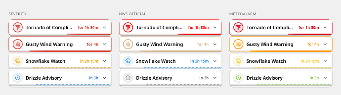

The three color themes (severity, NWS official, and MeteoAlarm awareness) all work in compact mode too:
Also in this release: the entity picker now filters to only compatible alert sensors, so setup is a bit smoother.

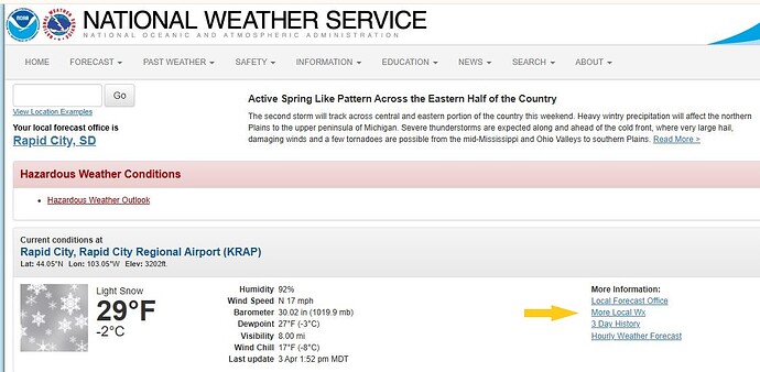

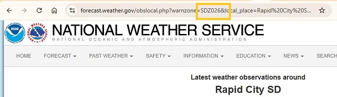

I did notice a slightly quicker way to find your NWS zones of interest.
Thanks, all!
