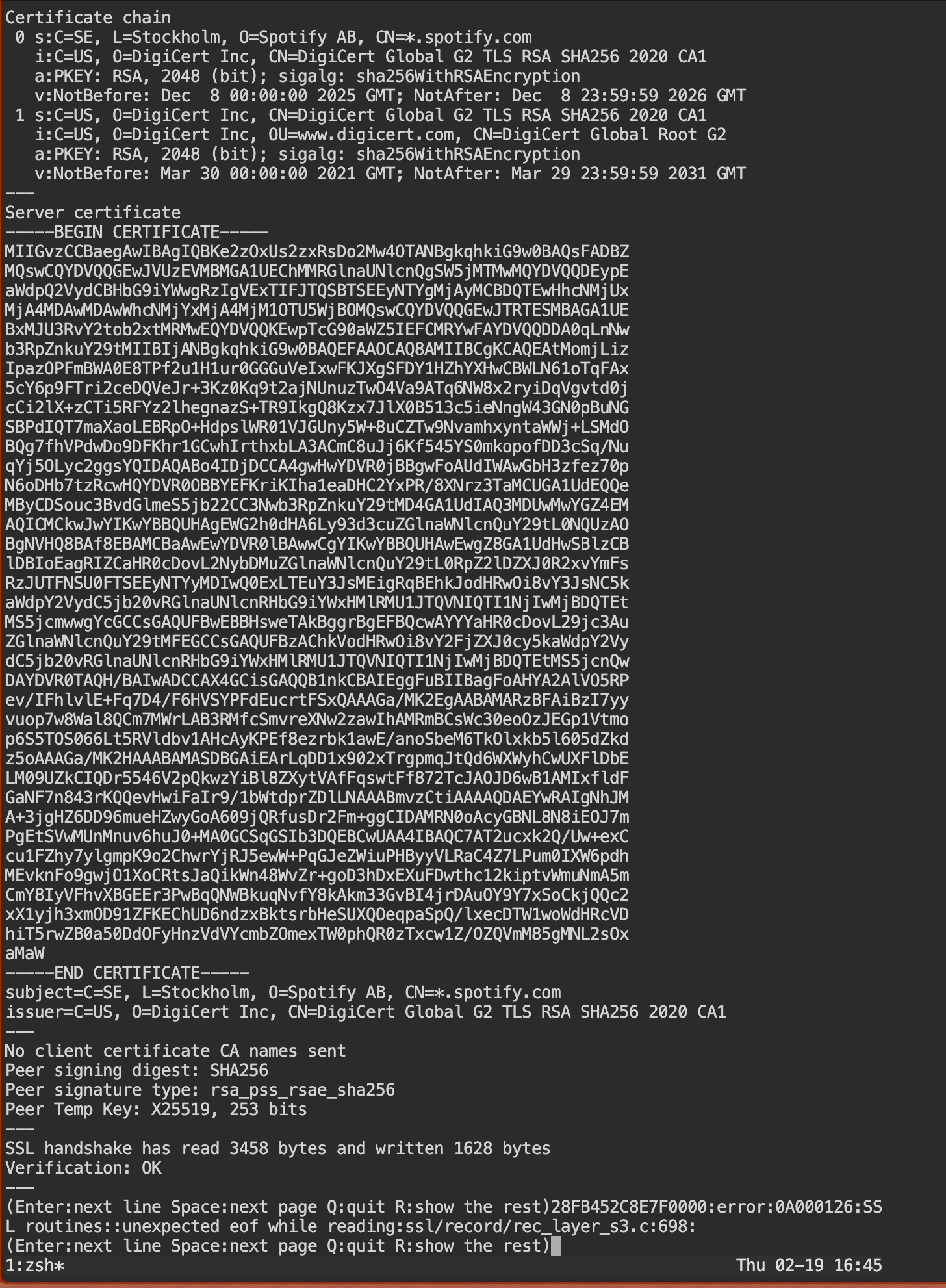

List SSL Certificate Chain
  1. Issue the following command from an HA Terminal window to list the SSL Certificate chain.
openssl s_client -connect api.spotify.com:443|more
  1. Output should look something like this:
verify return:1
Certificate chain
 0 s:C=SE, L=Stockholm, O=Spotify AB, CN=*.spotify.com
   i:C=US, O=DigiCert Inc, CN=DigiCert Global G2 TLS RSA SHA256 2020 CA1
   a:PKEY: RSA, 2048 (bit); sigalg: sha256WithRSAEncryption
   v:NotBefore: Dec  8 00:00:00 2025 GMT; NotAfter: Dec  8 23:59:59 2026 GMT
 1 s:C=US, O=DigiCert Inc, CN=DigiCert Global G2 TLS RSA SHA256 2020 CA1
   i:C=US, O=DigiCert Inc, OU=www.digicert.com, CN=DigiCert Global Root G2
   v:NotBefore: Mar 30 00:00:00 2021 GMT; NotAfter: Mar 29 23:59:59 2031 GMT
Server certificate
-----BEGIN CERTIFICATE-----
  1. press Control-C to stop the command, and return to terminal prompt.
  2. what output do you see for the “Certificate chain” section?

Apologies, I wasn’t aware of the advanced version, please see below:
  1. what output do you see for the “Certificate chain” section?
  1. what is the output? It should look something like this:
@Jakesa
Not a problem, for most people the stock HA version is sufficient; for networking issues like this though, the more powerful tools are helpful in diagnosing.
What concerns me in the openssl output you posted is the unexpected eof while reading ... toward the end of the response output. I can’t tell if that’s due to the |more functionality, or if it truly can’t read something related to the certificate response.
If it truly is an error, then it mirrors the reason == _lib.SSL_R_UNEXPECTED_EOF_WHILE_READING in the exception output from your original text.
Here’s what I see for the end of the response when I run the openssl command without the |more suffix:
SSL handshake has read 3458 bytes and written 1628 bytes
Verification: OK
New, TLSv1.3, Cipher is TLS_AES_256_GCM_SHA384
Protocol: TLSv1.3
Server public key is 2048 bit
This TLS version forbids renegotiation.
No ALPN negotiated
Early data was not sent
Verify return code: 0 (ok)
Can you re-run the following command, and reply with the output located after the Verification: OK line:
If you can, do a copy/paste of the text instead of a screen capture. I want to paste the response into a chatGPT query for possible explanation.

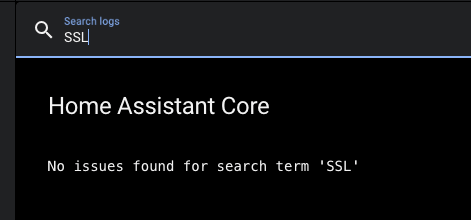

Nothing is showing up in the raw logs for SSLINFO just to confirm I placed it after """ Configuration schema. """ and before Custom Service Schema Please see below:

Please see below. Does this mean it is most likely a custom_component or integration? I will start looking for those keywords you mentioned earlier:
2026-02-21 10:59:58.921 WARNING (ImportExecutor_0) [custom_components.spotifyplus] SSLINFO - === Python Environment ===
2026-02-21 10:59:58.922 WARNING (ImportExecutor_0) [custom_components.spotifyplus] SSLINFO - Python version: 3.13.9 (main, Nov 25 2025, 17:58:43) [GCC 14.2.0]
2026-02-21 10:59:58.922 WARNING (ImportExecutor_0) [custom_components.spotifyplus] SSLINFO - === SSL Module Info ===
2026-02-21 10:59:58.922 WARNING (ImportExecutor_0) [custom_components.spotifyplus] SSLINFO - OpenSSL version: OpenSSL 3.5.4 30 Sep 2025
2026-02-21 10:59:58.922 WARNING (ImportExecutor_0) [custom_components.spotifyplus] SSLINFO - HAS_SNI: True
2026-02-21 10:59:58.922 WARNING (ImportExecutor_0) [custom_components.spotifyplus] SSLINFO - Default verify paths: DefaultVerifyPaths(cafile='/etc/ssl/cert.pem', capath='/etc/ssl/certs', openssl_cafile_env='SSL_CERT_FILE', openssl_cafile='/etc/ssl/cert.pem', openssl_capath_env='SSL_CERT_DIR', openssl_capath='/etc/ssl/certs')
2026-02-21 10:59:58.922 WARNING (ImportExecutor_0) [custom_components.spotifyplus] SSLINFO - === urllib3 / PyOpenSSL Check ===
2026-02-21 10:59:58.922 WARNING (ImportExecutor_0) [custom_components.spotifyplus] SSLINFO - urllib3 present: YES
2026-02-21 10:59:58.922 WARNING (ImportExecutor_0) [custom_components.spotifyplus] SSLINFO - Using PyOpenSSL: True
2026-02-21 10:59:58.922 WARNING (ImportExecutor_0) [custom_components.spotifyplus] SSLINFO - === cryptography / pyOpenSSL versions ===
2026-02-21 10:59:58.922 WARNING (ImportExecutor_0) [custom_components.spotifyplus] SSLINFO - cryptography: 46.0.2
2026-02-21 10:59:58.922 WARNING (ImportExecutor_0) [custom_components.spotifyplus] SSLINFO - pyOpenSSL: 25.3.0
2026-02-21 10:59:58.922 WARNING (ImportExecutor_0) [custom_components.spotifyplus] SSLINFO - === TLS + SNI handshake test ===
2026-02-21 10:59:58.953 WARNING (ImportExecutor_0) [custom_components.spotifyplus] SSLINFO - [OK] api.spotify.com
2026-02-21 10:59:58.953 WARNING (ImportExecutor_0) [custom_components.spotifyplus] SSLINFO -      TLS version: TLSv1.3
2026-02-21 10:59:58.953 WARNING (ImportExecutor_0) [custom_components.spotifyplus] SSLINFO -      Cipher: ('TLS_AES_256_GCM_SHA384', 'TLSv1.3', 256)
2026-02-21 10:59:58.954 WARNING (ImportExecutor_0) [custom_components.spotifyplus] SSLINFO -      Cert CN: SE
2026-02-21 10:59:58.986 WARNING (ImportExecutor_0) [custom_components.spotifyplus] SSLINFO - [OK] accounts.spotify.com
2026-02-21 10:59:58.986 WARNING (ImportExecutor_0) [custom_components.spotifyplus] SSLINFO -      TLS version: TLSv1.3
2026-02-21 10:59:58.986 WARNING (ImportExecutor_0) [custom_components.spotifyplus] SSLINFO -      Cipher: ('TLS_AES_256_GCM_SHA384', 'TLSv1.3', 256)
2026-02-21 10:59:58.986 WARNING (ImportExecutor_0) [custom_components.spotifyplus] SSLINFO -      Cert CN: SE
2026-02-21 10:59:59.035 WARNING (ImportExecutor_0) [custom_components.spotifyplus] SSLINFO - [OK] cloudflare.com
2026-02-21 10:59:59.035 WARNING (ImportExecutor_0) [custom_components.spotifyplus] SSLINFO -      TLS version: TLSv1.3
2026-02-21 10:59:59.035 WARNING (ImportExecutor_0) [custom_components.spotifyplus] SSLINFO -      Cipher: ('TLS_AES_256_GCM_SHA384', 'TLSv1.3', 256)
2026-02-21 10:59:59.035 WARNING (ImportExecutor_0) [custom_components.spotifyplus] SSLINFO -      Cert CN: cloudflare.com
2026-02-21 10:59:59.036 WARNING (ImportExecutor_0) [custom_components.spotifyplus] SSLINFO - === Direct SNI capability test ===
2026-02-21 10:59:59.036 WARNING (ImportExecutor_0) [custom_components.spotifyplus] SSLINFO - SNI support is ENABLED in Python
