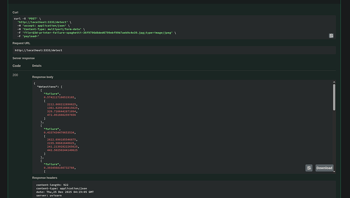

I am planning on a complete rewrite of both using fastapi/async. Before I do that though, am I missing anything? Has this already been solved and my Google-fu is failing me?
I purchased a p1s and want to have spaghetti detection. It seems the only decent way is to run the obico ml model and have a program handle things. Obico standalone is more of a print farm manager fwict. Am I correct in this conclusion?

I saw that too. Not sure if it’s still a viable option after bambulab locked down their firmware. It also depends on 2 or 3 different projects to glue it together and while it’s doable, I think a local rest API would be a much better plan, especially for ppl who only want the ml abilities.
I’ve already fixed the errors from the unmaintained add-on and opened a PR, but no reply from the maintainer. I could get the existing working, but it’s synchronous and it also depends on receiving a request with a public facing image to download.
Rest API that you can send the image to with params would make it a much better experience, that and being fully async.
