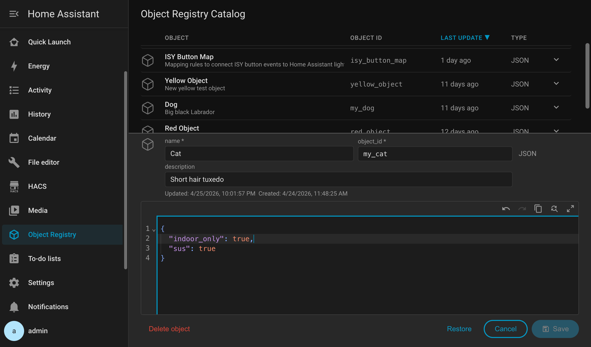

Based on this screenshot, it appears all of the JSON is composed manually in the editor (without any automated assistance from the editor).
Personally, I don't find writing data structures in JSON to be easier than YAML.
