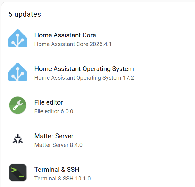

I am not sure about the timing. I have HA core 26.4.1 waiting to load along with the new HA OS and 3 other updates that came out today. I will see if the updates are connected to the issue.
But wow! I can’t believe all the constant updates that keep rolling in almost daily. This update list is just from the last 3 days. It seems one update or another breaks some integration every month or so, HA has become a part-time job.
