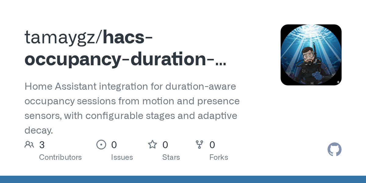

Leaving this here, in case anyone out there has the same need as I had (which lead to the creation of this hacs integration):
It lets you create a occupancy duration helper, that tracks motion/presence/occupancy sessions based on a linked motion sensor, especially for people that have sensors that dont track occupancy :wink:
I know there’s way bigger integrations like Area Occupancy Detection etc.pp. out there, but they were either too big or didnt solve my specific issue.
What was my issue? Well, pooping & music:
Occupancy Duration Helper is a Home Assistant custom integration that turns motion and presence signals into persistent occupancy sessions with duration tracking, configurable stages, and adaptive decay.
I wanted to play music on the toilet, but only when actually pooping, so a fade-in starts only when a longer visit reaches the configured long stage. I also wanted music and ventilation while showering, but not when someone only enters briefly to wash their hands. This integration makes those use cases easy by listening to a motion sensor and tracking the session over time according to the configured stage profile.

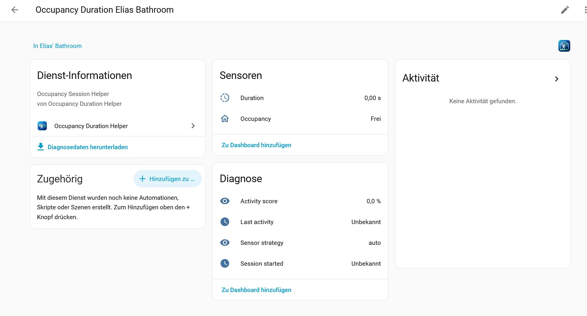

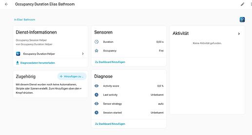

However, after installing Occupancy Duration Helper through HACS, restarting HA and adding a first PIR Sensor through “Integrations” (config flow) I can see additional “Helpers”. But I am unable to reconfigure any settings since Occupancy Duration Helper is not visible through Settings → Devices & services.
Consequently I can not provide diagnostics through HA -> Settings → Devices & services → Occupancy Duration Helper → Download diagnostics either.
Additionally there is no entity for xxx_stages with Settings -> Tools -> States. Hence no automations based on above entity is possible.
What am I doing wrong here? :thinking:

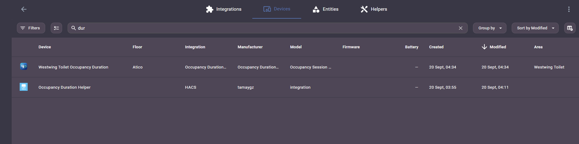

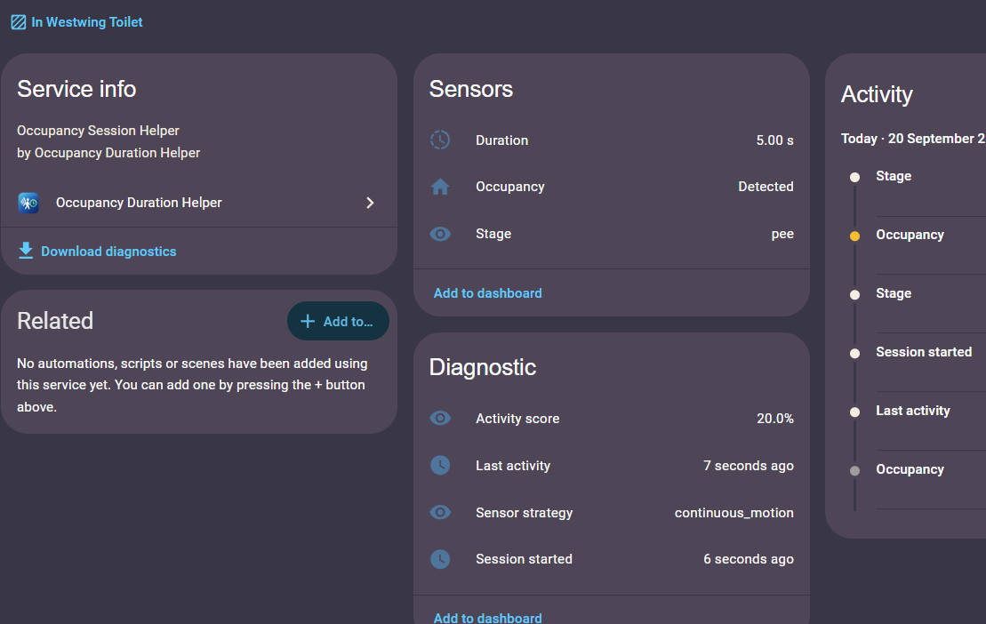

Check via HA → settings → Devices & services → Devices tab (instead of integrations tab), see if you have the helper created there
@Tamsy
There it is. Thank you for the hint.
