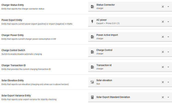

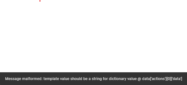

Thanks for making this blueprint. I’m trying to get this working but I get this error message when I try to save it.

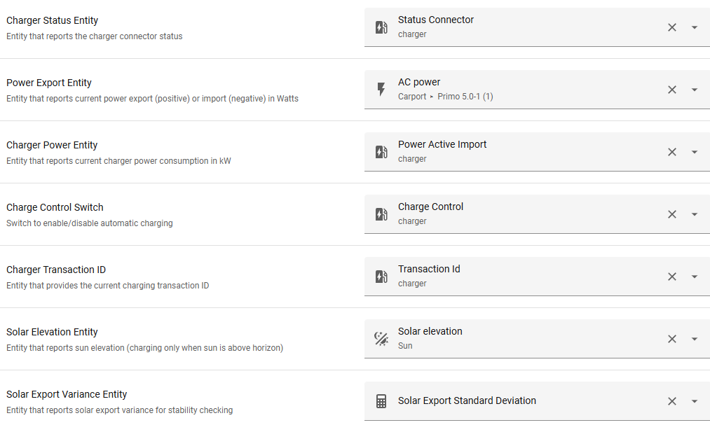

This is my configuration. (I probably have done it wrong)
Sorry for the delay. Have just seen this now. Are you still having the issue? Can you show me the command you are sending?
@WINfiEld can you set the precision of the solar variance to zero instead of two. Looks like my sensor I am reading returns whole watts to the solar variance helper.
