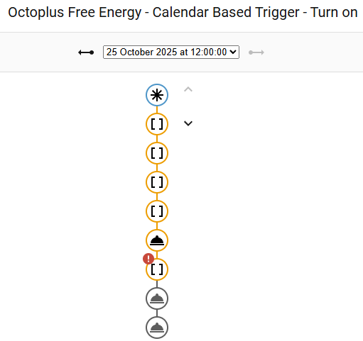

I’ve been attempting to make use of the Octopus Energy free energy sessions with Octoplus, by turning everything I can automate to turn on, on!
But I came across a small issue, if certain devices are not available - they stop my automation as per this image from the traces:
The actions part of my code used to be:
