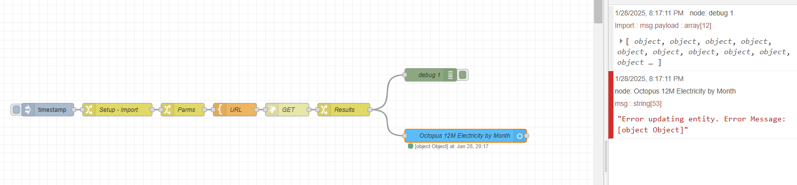

Hey folks
Sorry for dragging up an old post. I’ve only just started on my HA journey and I’m looking at Geoff’s method for pulling 12 months of data for Octopus electricity. My intention is to create several similar flows for representing different timescales and datasets for both gas an electricity.
The main issue I have right now is getting the flow Geoff posted (obviously modified with my own API call values) returned to HA.
From various other posts (mainly from Geoff, many in this thread) I’ve tried setting up a sensor and configured the entity-config and device-config. However, I (mis?)understand I can’t just pass msg.payload back to HA in an attribute because it is an object and not a simple data type. What then, is the best approach to return the data to HA with the intention of plotting in Apex-Charts? Do I need to create a sensor for each of the 12 months and return e.g. msg.payload[0].consumption / period etc? Or am I way off course?
So far, I’ve only added and configured the sensor after the posted flow
I don’t know if I’m looking in the right place but I’ve not found any documentation to tell me how to exactly this?
Thanks for your time and any advice
BBz

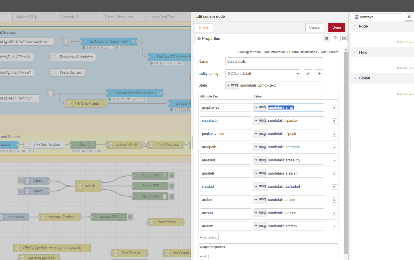

Home Assistant entities can only hold primitive data in the state value. Therefore, if you have 12 months of ‘a value’ it would take 12 different sensors to pass this to HA. That is a lot of sensors for a graph!
However, entity attributes can hold practically anything (up to a big limit). I pass quite complex objects, arrays, and arrays of objects by using the attributes. An array of 12 objects, each filled with the values I want, can go directly to HA.

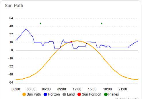

I have found, the hard way, that for graphing stuff the trick is to pre-process arrays for Apex charts, so they arrive in a format that is easy to deal with. For Apex Charts the expectation is that you will use a data-generator to unpick the array (in the entity attribute) and map to an array of [timestamp, value] pairs.
Here is a pic of what I am working on at the moment - a graph of the sun path and horizon for my solar PV.
SunPathSolarWinter
The data array going into an attribute-
Any attribute could be just msg.payload, or anything you want!
Naturally, if the main thing you want to pass is an array, and this goes into an attribute, the sensor state value will still need something in it - and if msg.payload has array in it, and you leave the default State set to msg.payload - BANG!
So, I always set the State to a primitive value of something of some use. For testing you can just set the State field option to ‘string’ and enter (without the quotes) “hello world”
After that there will be many more questions (not least on how to get Apex Charts working!) No, I don’t think there is much written up on this, but there are examples that you can pick through.
Oh wow, many thanks Geoff, I’m now getting data into an attribute in HA. I just didn’t have my head around the fact that State can be anything I like (was thinking I needed a state from the retrieved data) which had me stuck for a good while.
You (and others) have pasted plenty of examples of Apex Data Generator and of course there is documentation for this so I’ll have a good stab at it and see how I get on.
Thanks again for your very prompt and useful reply to my question - you’re a star!!
BBz

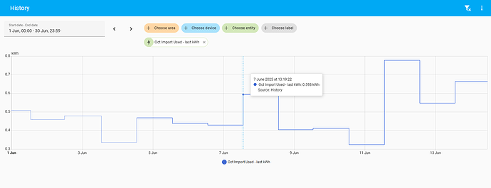

The LT stats are there. BottleCap Dave’s integration generates sensor(s) for the previous consumption, and this goes into LT stats so it can be retrieved for any period beyond the default 10 days. Yes, Apex-charts will by default plot any entity sensor from history, however this is ‘history’ and not ‘long term statistics’ hence just plotting the previous_accumulative_consumption only works for the past 10 days, and there is also the problem of the ‘date’.
Exhibit A: - Octopus Energy Integration, electric (import) previous_accumulative_consumption, in kWh.
Since I have a Solar PV system, which is currently doing its job very well, my import has been just the system balancing jitter at around 0.5 kWh per day, otherwise this is what I believe you are after. Note that, for the 7th June, the figure changed at 13:19 in the afternoon. This is quite normal, since the value in this sensor is the accumulated (total) consumption (not cost) value for the day, and it comes from the smart meter to Octopus during the night, arriving in my account sometime between 09:00 and 20:00 on the day after. On a good day, I get yesterdays readings by 09:00, but on a bad day not until early evening. Gas is another matter, and not getting a reading at all for two or three days in a row can happen.
Therefore, the figure 0.593 (0.6 kWh) needs to be captured early evening for the 7th June, and plotted on a graph for the 6th June.
Home Assistant can do this, if you are happy to work with SQL calls to the database and process an array of data. For myself, I use Node-RED. So much easier.
I modified something else I already had so as to generate this:-
This is correct, in that the value captured during the evening of the 7th is actually plotted against the 6th. Thank you for asking the question, now I have another nice graph I wanted to add to my collection. It has been a very sunny spring, almost entirely ‘off-grid’ since the start of April…

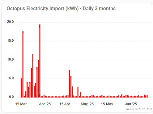

If you want the code to do this, you need Node-RED with the additional node-red-node-sqlite node set. The following code will
  • find the relevant octopus energy accumulative previous consumption meta-id in the statistics-meta table, which you can then add as the setting id in the main flow (you only need to do this once to find the correct id)
  • pull 400 records from long-term stats with time and date, at late evening, and group by date
  • analyse the returned data array, adding in a timestamp for 12:00 the day before (for back-plotting on the correct date)
  • export to an HA sensor as yesterday (value in state) and the entire day-table array in an attribute
There is other stuff in the code to build a year table by calendar month, and to build a billing table by Octopus billing date.
[{"id":"c5569d9c9b38ada0","type":"group","z":"2dd6b0b4a5f86125","name":"Consumption day-graph (for testing only)","style":{"label":true},"nodes":["c523a00720fbfd24","2b1273152bdb234e","f2a7abb264333158","c8ca6fb16faa1ead","03bdc0c644b5d3b2","92607112b89f4b45","343ae2b4d83cb0f5","1bec2fbf0ac54bc1","05a1494f02f9f815","36094bab72c774ae"],"x":34,"y":5819,"w":1072,"h":202},{"id":"c523a00720fbfd24","type":"sqlite","z":"2dd6b0b4a5f86125","g":"c5569d9c9b38ada0","mydb":"56ce7a19f8e148e7","sqlquery":"prepared","sql":"SELECT statistic_id, id FROM \"statistics_meta\"","name":"Long Term stats (name & id)","x":420,"y":5860,"wires":[["2b1273152bdb234e"]]},{"id":"2b1273152bdb234e","type":"change","z":"2dd6b0b4a5f86125","g":"c5569d9c9b38ada0","name":"Filter electricity previous cost sensors","rules":[{"t":"set","p":"test_a","pt":"msg","to":"sensor","tot":"str"},{"t":"set","p":"test_b","pt":"msg","to":"electricity","tot":"str"},{"t":"set","p":"test_c","pt":"msg","to":"previous_accumulative_consumption","tot":"str"},{"t":"set","p":"payload","pt":"msg","to":"payload[$contains(statistic_id, $$.test_a) and $contains(statistic_id, $$.test_b) and $contains(statistic_id, $$.test_c)]","tot":"jsonata"}],"action":"","property":"","from":"","to":"","reg":false,"x":730,"y":5860,"wires":[["f2a7abb264333158"]]},{"id":"f2a7abb264333158","type":"debug","z":"2dd6b0b4a5f86125","g":"c5569d9c9b38ada0","name":"debug 6","active":true,"tosidebar":true,"console":false,"tostatus":false,"complete":"payload","targetType":"msg","statusVal":"","statusType":"auto","x":990,"y":5860,"wires":[]},{"id":"c8ca6fb16faa1ead","type":"inject","z":"2dd6b0b4a5f86125","g":"c5569d9c9b38ada0","name":"Get long-term stats","props":[{"p":"params","v":"{\"$id1\":117,\"$days\":400}","vt":"json"},{"p":"billday","v":"24","vt":"num"}],"repeat":"","crontab":"","once":false,"onceDelay":0.1,"topic":"","x":170,"y":5940,"wires":[["03bdc0c644b5d3b2"]]},{"id":"03bdc0c644b5d3b2","type":"sqlite","z":"2dd6b0b4a5f86125","g":"c5569d9c9b38ada0","mydb":"56ce7a19f8e148e7","sqlquery":"prepared","sql":"SELECT id, state, udate FROM\n    (SELECT metadata_id AS id, state, date(created_ts, \"unixepoch\") AS udate, time(created_ts, \"unixepoch\") AS utime\n    FROM \"statistics\"\n    WHERE metadata_id IN ($id1) AND unixepoch()-created_ts < 86400 * $days AND utime > \"20\" AND utime < \"23\"\n    ORDER BY udate, id, utime DESC)\nGROUP BY id, udate","name":"Long term stats array","x":400,"y":5940,"wires":[["92607112b89f4b45","1bec2fbf0ac54bc1"]]},{"id":"92607112b89f4b45","type":"change","z":"2dd6b0b4a5f86125","g":"c5569d9c9b38ada0","name":"Analyse","rules":[{"t":"set","p":"payload","pt":"msg","to":"(\t/* June 25 - mods to include a day table, backed to yesterday, for day-consumption reporting */\t\t/* count entities recorded - expect one import or two as import and export */    \t    $ids:=$distinct(payload.id);\t    $imp:=$ids[0];     /* import id */\t    $exp:=$ids[1];     /* export id */\t    $bill:=billday;\t\t/* add month and year for easy parsing, also midday timestamp for yesterday */\t    $base:=payload~>|$|(\t        $x:=$split(udate,\"-\");\t        {\"month\": $number($x[1]),\t         \"day\": $number($x[2]),\t         \"year\": $number($x[0]),\t         \"timestamp\": (udate & \"T12:00:00\"~>$toMillis())-86400000 })|;\t\t/* get data end date, should be yesterday, and trim base array to one year */\t    $last:=($base[id=$ids[0]].udate)[-1];\t    $from:=$number($substringBefore($last,\"-\"))-1 & $substring($last,4,6);\t    $year:=$base[udate>$from];\t    $days:=$count($year)/$count($ids);\t    \t/* compose analysis for all entities */\t    $results:=$ids.(\t        $id:=$;\t        $array:=$year[id=$id];\t        $year_total:=$sum($array.state)~>$round(2);\t        $day_count:=$count($array);\t        $start:=$array[day=1][0].udate;\t        $month_array:=$array[udate>=$start];\t        $table:=[1..12].(\t            $m:=$;\t            $month:=$month_array[month=$m];\t            {\"month\": $m, \"year\": $month[0].year,\t             \"timestamp\": $month[0].udate & \"T12:00:00\"~>$toMillis(),\t             \"total\": $month.state~>$sum()~>$round(2)};\t        );\t        {\"id\": $id,\t        \"from\": $from,\t         \"base\": $month_array[0].udate,\t         \"last\": $last,\t         \"days\": $day_count,\t         \"total\": $year_total,\t         \"dtable\": $base,\t         \"months\": $table^(timestamp)}\t    );\t\t/* block by billing day, summing prior bill day inclusive to next bill day exclusive */\t/* array of billing dates over data period */\t    $bdates:=$base[id=$imp and day=$bill].udate;\t    $bills:=$bdates[[1..20]]#$mon.(\t        $dnext:=$;\t        $dfrom:=$bdates[$mon];                                  /* mon is already from 0 when starting map at 1 */\t        $dupto:=$fromMillis($toMillis($dnext & \"T12:00:00.000\")-86400000)~>$substringBefore(\"T\");\t        $period:=$base[udate>=$dfrom and udate<$dnext];\t        $debit:=$period[id=$imp].state~>$sum()~>$round(2);\t        $credit:=$period[id=$exp].state~>$sum()~>$round(2);\t        {\"from\": $dfrom,\t        \"upto\": $dupto,\t        \"kWh\": $debit,\t        \"credit\": $credit,\t        \"bill\": $round($debit-$credit,2)};\t        \t    );\t\t    {\"import\": $results[id=$imp],\t     \"export\": $results[id=$exp],\t     \"bills\" : $bills\t    };\t\t\t\t)","tot":"jsonata"},{"t":"set","p":"payload","pt":"msg","to":"(\t    $l:=$count(payload.import.dtable);\t    payload.import.dtable[[$l-90..$l]];\t)","tot":"jsonata"}],"action":"","property":"","from":"","to":"","reg":false,"x":640,"y":5940,"wires":[["343ae2b4d83cb0f5","36094bab72c774ae"]]},{"id":"343ae2b4d83cb0f5","type":"debug","z":"2dd6b0b4a5f86125","g":"c5569d9c9b38ada0","name":"debug 7","active":true,"tosidebar":true,"console":false,"tostatus":false,"complete":"payload","targetType":"msg","statusVal":"","statusType":"auto","x":720,"y":5980,"wires":[]},{"id":"1bec2fbf0ac54bc1","type":"debug","z":"2dd6b0b4a5f86125","g":"c5569d9c9b38ada0","name":"debug 8","active":false,"tosidebar":true,"console":false,"tostatus":false,"complete":"true","targetType":"full","statusVal":"","statusType":"auto","x":480,"y":5980,"wires":[]},{"id":"05a1494f02f9f815","type":"inject","z":"2dd6b0b4a5f86125","g":"c5569d9c9b38ada0","name":"Find id we want","props":[{"p":"params","v":"{}","vt":"json"}],"repeat":"","crontab":"","once":false,"onceDelay":0.1,"topic":"","x":180,"y":5860,"wires":[["c523a00720fbfd24"]]},{"id":"36094bab72c774ae","type":"ha-sensor","z":"2dd6b0b4a5f86125","g":"c5569d9c9b38ada0","name":"Oct Import Elec Daily Use Table","entityConfig":"1feb8331337d9514","version":0,"state":"payload[-1].state","stateType":"jsonata","attributes":[{"property":"table","value":"payload","valueType":"msg"}],"inputOverride":"allow","outputProperties":[],"x":950,"y":5940,"wires":[[]],"server":""},{"id":"56ce7a19f8e148e7","type":"sqlitedb","db":"/homeassistant/home-assistant_v2.db","mode":"RO"},{"id":"1feb8331337d9514","type":"ha-entity-config","server":"","deviceConfig":"","name":"SC Oct ImE Daily","version":6,"entityType":"sensor","haConfig":[{"property":"name","value":"Octopus Import Electricity Daily Consumption"},{"property":"icon","value":""},{"property":"entity_picture","value":""},{"property":"entity_category","value":""},{"property":"device_class","value":""},{"property":"unit_of_measurement","value":""},{"property":"state_class","value":""}],"resend":false,"debugEnabled":false}]
For this exercise I have curtailed the 400 output array to just the last 90 days, and set a usual Apex chart with data generator to pull from the table and plot the last three months.
type: custom:apexcharts-card
header:
  show: true
  title: Octopus Electricity Import (kWh) - Daily 3 months
show:
  last_updated: true
graph_span: 3 months
span:
  start: day
  offset: "-3month"
series:
  - entity: sensor.octopus_import_electricity_daily_consumption
    data_generator: |
      return entity.attributes.table.map((reading) => {
        return [new Date(reading.timestamp).getTime(), reading.state];
    type: column
    color: Red
    unit: kWh
I will leave you to experiment and provide a better version of my code in due course.
NOTE: I suggest leaving the sqlite node setting as ‘prepared statement’ and the configuration server to Read Only to prevent any accidental writes to the HA database!

So how do I plot a chart with attribute ts as the timestamp instead of the last_changed_ts?
The apex-charts card just requires an array of array-pairs of [timestamp (unix ms), value]. Usually the data generator is used to produce this array.
As long as you have your array of data values and times, in an entity attribute, all you need to do is map over this (either using the map function or by using a for-loop) picking out the value, and the timestamp of your choice. Both the plot-value and the plot-timestamp can be computed from any available value in any way required.
On its own, SQL can generate a table, but the challenge is getting this into a table in an entity attribute, from which the apex-graph chart can work. If that is your question “how do I get the value of an SQL query into an entity” then, for myself, I use Node-RED. Easy to perform the computation, and importantly NR permits creating entity sensors, and uploading whatever you want into the entity attribute. HA has an SQL sensor integration, but this only permits one value from a table-return to go into the entity state value. HA is not really setup to process arrays and tables of data.
@Biscuit
After re-reading the data_generator section of the ApexCharts Card documentation, I realized that the data_generator can only process from the latest state of the entity. Hence it means I have to create an entity that carries all the historical data every time when the state is updated in order to get it working. :fearful:
Now I am exploring how to accomplish a month long daily cost chart with Node-RED. Thanks for introducing it to me.
Let me report back when I have achieve what I have in my mind.
