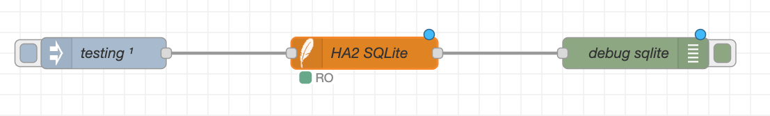

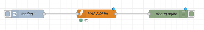

I have created a simple flow as following:

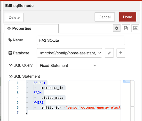

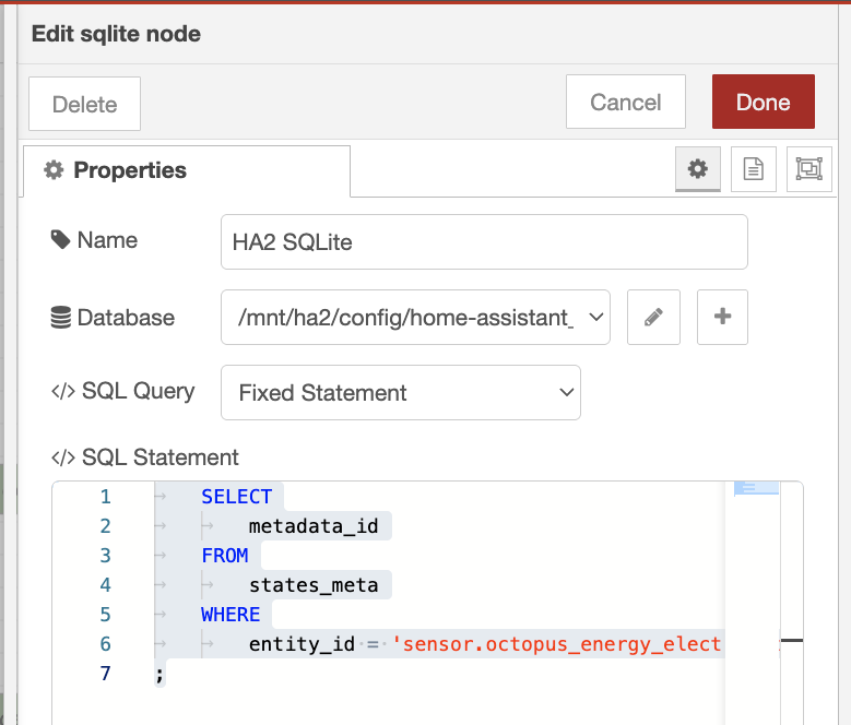

The properties of node HA2 SQLite is:
SQLStatement:
	SELECT
		metadata_id
	FROM
		states_meta
	WHERE
		entity_id = 'sensor.octopus_energy_electricity_[meter#]_[mpan#]_current_accumulative_cost'
The database was opened in Read-Only mode. It generated the following error when injected:
Error: SQLITE_READONLY: attempt to write a readonly database
