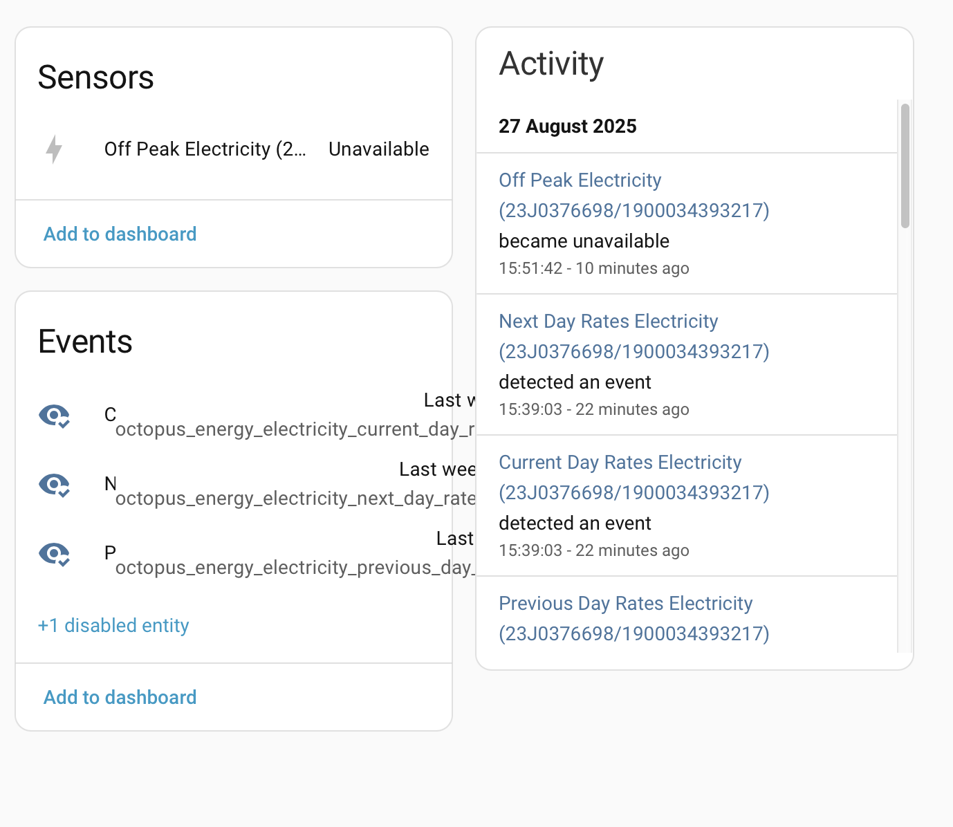

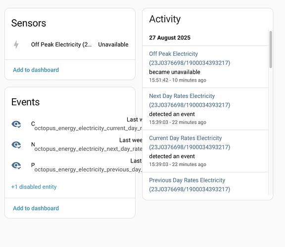

I thought this may resolve itself but after a few days, still nothing so I tried removing and reinstalling the integration. Now however, the only entities set up are shown in the picture. (electricity meter shown)
