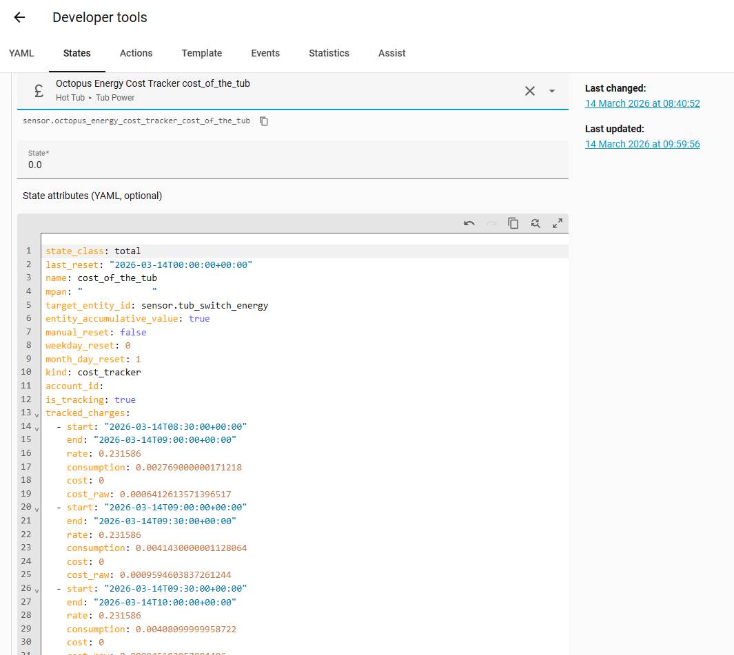

I can access the various octopus costs trackers’ YAMl code under setting/developer/states.
I have managed to find cost tracker entities e.g. “Sensor. octopus_energy_cost_tracker” and can edit them but it then reverts back to the incorrect setting.

What you have found is a (highly specific) Developer Tool that allows us to examine the full entity object. This data object holds the entity state value, as well as the attribute values. The HA States Tool shows the entity object using YAML formatting. The ‘object’ could be shown using JSON formatting as an alternative, but HA uses YAML for configuration constructs and uses the same approach here.
As a first point - the full entity object, when shown as YAML, is not ‘code’. It is just a representation in YAML format, of a data-structure. Properties (fields) and their values, arrays, and nested objects/arrays.
As a second point - you can’t edit the entity object (state/attributes). Well, yes you can, but the edit part of the tool is strictly used only for testing purposes, and any edits will only last until the integration updates and overwrites the entity the next time. Since the Octopus Energy Integration updates most of its entities every 30 minutes or so (more frequently for this one) your temporary edit will only last until the next update happens.
Use this tool rarely and with great care.

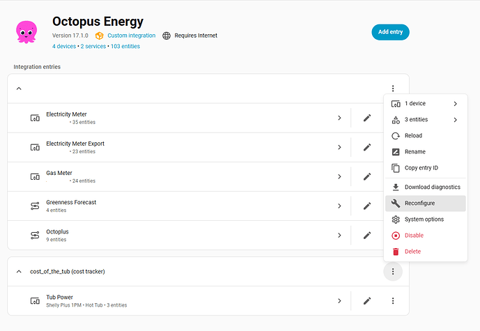

Go to Settings > Devices and services > Integrations
Go to the Octopus Energy Integration
Find your Cost Tracker entry that you added and click on the right-hand three dots
This will bring up a new menu, which includes the option to reconfigure. This will take you to the original setup where you can change the sensor configuration settings.
You will find a very helpful link to the documentation at the very top of the edit window, and part way down is the “Tracked entity state is accumulative” option, ticked for true and unticked for false.
Simple set the Tracked entity state is accumulative, and click submit.
