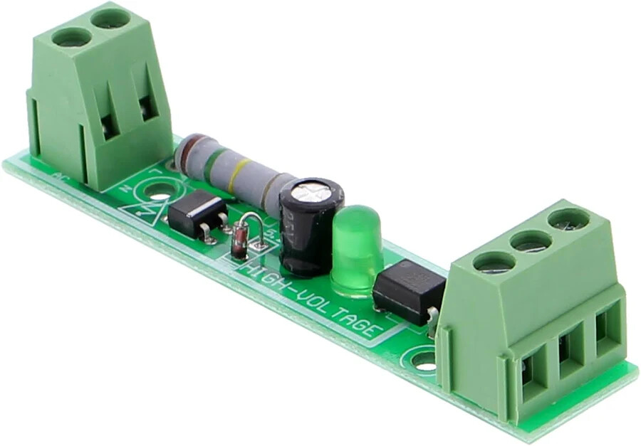

There are 814 AC opto modules around, but common approach is to get $1 220VAC opto module and swap the resistor according to your voltage.
