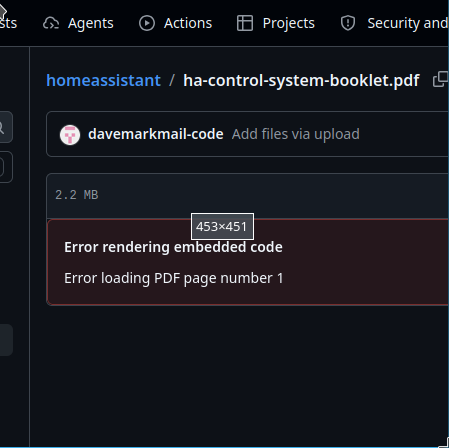

This pdf doesn’t render for me…
Sorry aabout that , not sure why its ok for me w ill check - Alternate icloud link > ha-control-system-booklet.pdf
It just won’t render on linux then, as that link is a no go also.
Very stange :frowning:
Added Markdown – homeassistant/ha-control-system-booklet.md at 8d470dec650e6db65eec35c790f39cd384e239ef · davemarkmail-code/homeassistant · GitHub
Works great!
