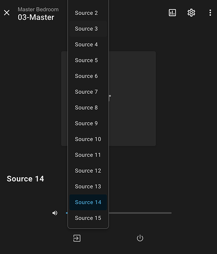

With RC3 and RC5 I am no longer able to manually change the source input from the regular Home Assistant media entity card. It is possible the problem exists before that, but this is when I first noticed it. I can adjust volume, power, etc. But source won’t set. I can set it from an automation that doesn’t use the regular entity media card/interface:
I’m seeing the same thing (source changes not “sticking” when changing it with the media card) with my Lync 12.
i’m trying to replicate this with my Lync12 with the plain Home Assistant card and I can’t. can you guys help me out by creating an issue on my github and filling that out? could i also ask for a video recording of how this actually looks and review the logs just to be sure and send anything that could look suspicious? thanks.
I have opened an issue with a screen recording attached.
@UngluedChalice Please have a look at the issue I opened on GIT and chime in if you would.
https://github.com/hikirsch/htd-home-assistant/issues/31

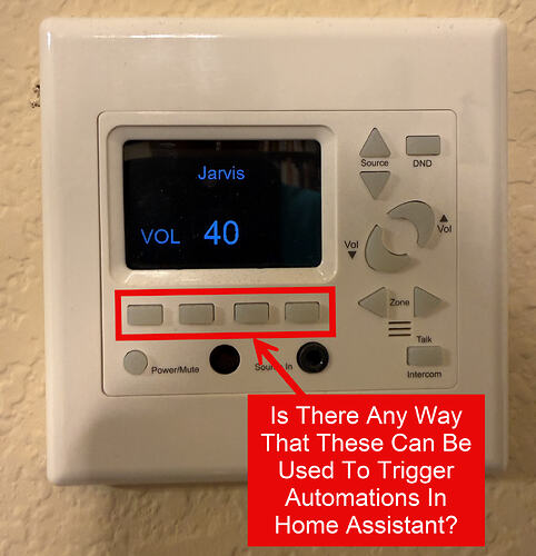

@harshl Perfect!! Thank you!!! I will migrate this from HomeSeer! Yay!! That is one less item I need to worry about in this migration. I really appreciate you testing this for me! I use it all the time. I wish the HTD Lync Keypads had other buttons that could be used trigger automations. What I use the DND button for is to tell the home automation controller to pause the music it then also undoes DND mode on the zone that it was pressed on. The benefit is local control (to a very limited extent) of the source that is playing from the keypad. That brings up another question to find out if this is possible.
The keypad has 4 other buttons that don’t do anything unless you are playing an MP3. Does anything get generated by the HTD Lync 12 when any of these are pressed that HA could maybe trigger off of? That would allow people to control their media from the keypad in a basic way like I do with the DND button. Thanks for all your help and thanks to all that have supported this effort!!! You are awesome as is Ultrajones (@kingfetty) for the HomeSeer UltraHTDAudio3 plugin that I used for years! Thank you all!!! :smiley:
@Jean-Marie here is what I have found so far. The buttons are not actionable unless the pad is set to the MP3 source. The play and stop buttons seems to signal commands to the network controller reliably, but the fast forward and backward buttons are spotty. I am suspicious of this being because there are no MP3s on my controller. I am going to load up some MP3s onto the controller as soon as I have a little time and test again to see if those buttons repeat commands back to the network controller reliably at that point.
Regardless, it doesn’t seem ideal to use these as triggers since it must be on the MP3 source to do so.
If, under those restrictions, you still have interest, let me know and I’ll see about getting it implemented.
@Jean-Marie
I have done a ton of testing and it seems that using these buttons would require that the source of the panel be set to the MP3 source, and even after that, only the first press of a button is reliably reported, unless another button is pressed first. For instance, if you press the play button, it will be reported and picked up, but if you try to use the play button again before pressing the stop button, it would not be seen.
I think it would be very unreliable and not worth the effort to implement. If anyone else finds differently and disagrees, I am happy to put in the effort with additional information provided to me.
This also only accounts for these older gen panels. I have no access to the newer panels/controller revisions to see if they behave differently.
I’m going to close the issue out for now. It would have been awesome if it had worked better!
