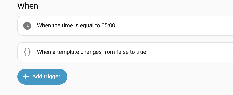

When I “take control” I can obviously seeing that automation checking if debug is activated (sure, as debug is activated by each change). When I do manually remove that trigger condition, CPU goes down. (Screenshot of modified version attached)
Any idea why checking but not being activated lead to that CPU usage?
You are correct. I updated the blueprint to disable (comment out) the trigger so people can use it only when they need to. Thanks for finding this!

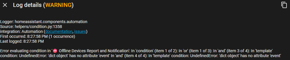

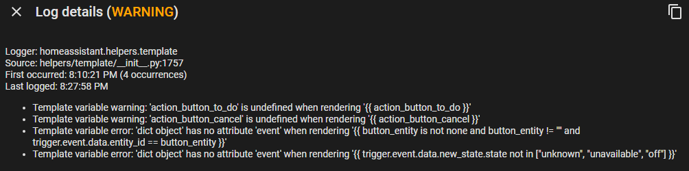

I reimported the blueprint to 46c. The trace navigation seemed to be fixed, but new errors occur instead. I think these new errors may prevent the automation from running at all.
Perhaps the blueprint might benefit from the suggestion made here?
I just retested all functions (auto-add to to-do, action buttons, filter out all devices, etc, etc) I cannot repro your error.
Restart HA and if you still get it send the Trace file and the Log Errors in text, not screenshots.
I restarted and tried again. The same problem reoccurs. Here is the full text from the log.
The normal log produces these errors:
Logger: homeassistant.components.automation
Source: helpers/condition.py:1358
integration: Automation ([documentation](https://www.home-assistant.io/integrations/automation), [issues](https://github.com/home-assistant/core/issues?q=is%3Aissue+is%3Aopen+label%3A%22integration%3A+automation%22))
First occurred: 2:12:30 AM (1 occurrence)
Last logged: 2:12:30 AM
Error evaluating condition in '⛔ Offline Devices Report and Notification': In 'condition' (item 1 of 2): In 'or' (item 1 of 3): In 'and' (item 3 of 4): In 'template' condition: UndefinedError: 'dict object' has no attribute 'event' In 'and' (item 4 of 4): In 'template' condition: UndefinedError: 'dict object' has no attribute 'event'
Logger: homeassistant.helpers.template
Source: helpers/template/__init__.py:1757
First occurred: 2:12:30 AM (2 occurrences)
* Template variable error: 'dict object' has no attribute 'event' when rendering '{{ button_entity is not none and button_entity != "" and trigger.event.data.entity_id == button_entity }}'
* Template variable error: 'dict object' has no attribute 'event' when rendering '{{ trigger.event.data.new_state.state not in ["unknown", "unavailable", "off"] }}'
Here is the trace log:
2026-03-09 02:12:30.559 ERROR (MainThread) [homeassistant.helpers.template] Template variable error: 'dict object' has no attribute 'event' when rendering '{{ button_entity is not none and button_entity != "" and trigger.event.data.entity_id == button_entity }}'
2026-03-09 02:12:30.561 ERROR (MainThread) [homeassistant.helpers.template] Template variable error: 'dict object' has no attribute 'event' when rendering '{{ trigger.event.data.new_state.state not in ["unknown", "unavailable", "off"] }}'
2026-03-09 02:12:30.563 WARNING (MainThread) [homeassistant.components.automation] Error evaluating condition in '⛔ Offline Devices Report and Notification':
