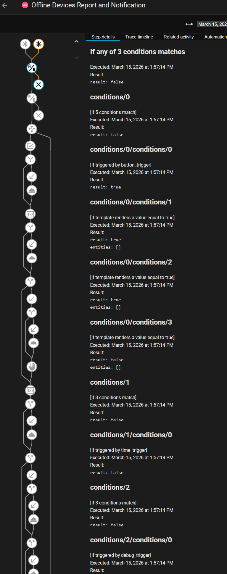

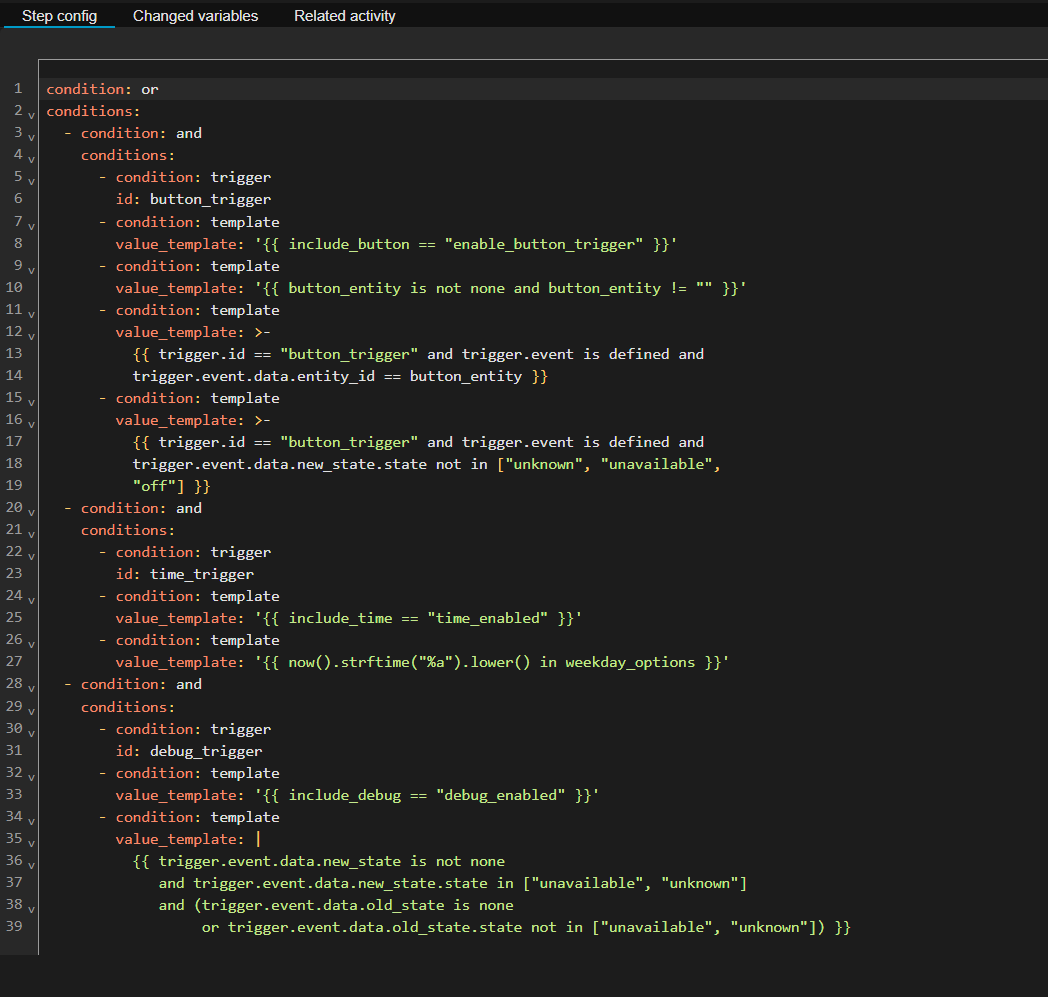

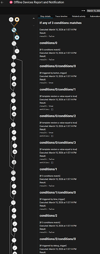

@Ltek I discovered another issue. The button will not run the automation. I think it’s failing at the following condition. I know the logic is there to prevent unwanted runs from other sources, but it also stops the UI button too.
     value_template: >-
       {{ trigger.id == "button_trigger" and trigger.event is defined and
       trigger.event.data.new_state.state not in ["unknown", "unavailable",
       "off"] }}
Here is the full trace images:
yeah, I must have forgotten to test it.
fixed in 48c, posted
Works! Thank you.

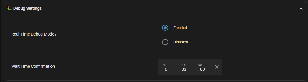

Default is to run on the schedule you input. If you want it to happen in Real Time, this is explained the top of the description…
DEBUG README... Real-Time Debug trigger code is commented out. To use, you need to uncomment 'Real-Time Debug Code' section
Okay, how can i uncomment it?
I can’t find the line in the yaml code.
I already set this:
Why is it commented out in the first place, but i still can set it in the BP/Automation itself?
Also why its called debug?
When a device/entity goes offline/unavailable i want a notification, thats the main purpose of this or not?
You must enable Real-Time in the blueprint source code since it should only be used for troubleshooting (aka Debug). On most systems real-time causes high CPU use since it must trigger on all entity changes, no matter what they are. The HA system does not give us any way to only trigger when something changes to unavailable. This blueprint is for a scheduled daily or weekly report. If you need to monitor a few specific entities in real time, you should make an automation just for those, so they monitor/trigger on only those few entities.

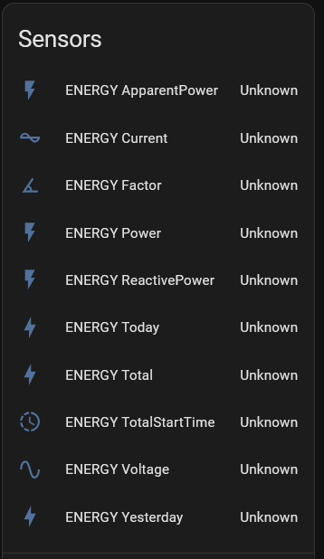

Also one of my WiFi plugs is not detected as offline:
you can schedule a run if you want, sure. next time I mod the BP I’ll add a configurable timeframe… I wont have time for a while.
the BP monitors entities from these domains…
  • sensor.*
  • binary_sensor.*
  • switch.*
If you think it should see your Sensor, I’d you to show me the make/model and the entity info from the main device. I have wifi devices from Tuya, Tapo, Shelly, and others which report offline for me.
Its a Nous A1T WiFi with Tasmota, other Tasmota devices work fine with the BP, but this device showed “Unknown” instead of “Unavailable”.
I already restarted the device and see if its happen again.
“Unknown” means the entity exists but has no state/value yet. Many entities do not start with a value - happens a lot when HA restarts, it does not cache values. So if the device has not reported in, it will be ‘unknown’ until it reports or is polled.
