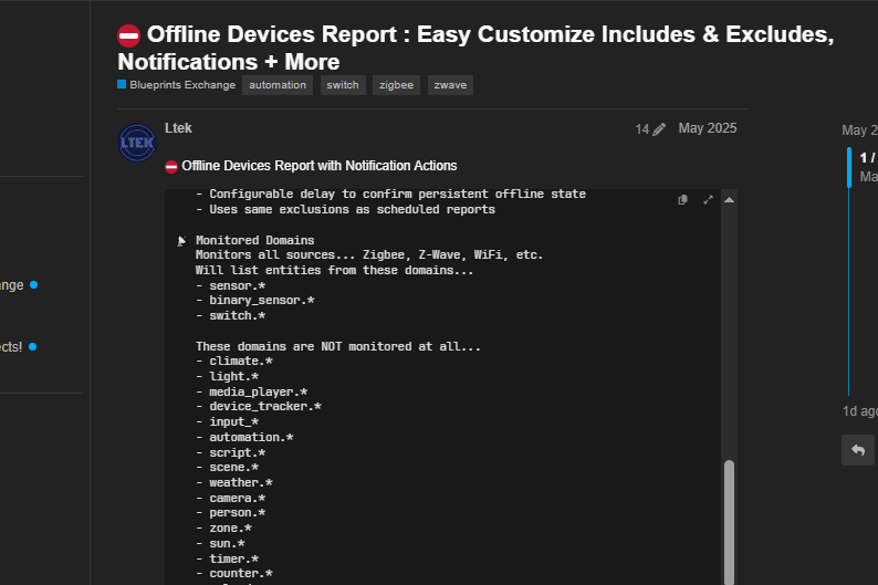

Is it possible to include .light sensors somehow?
by default it works with all entities in the sensor domain.
sensor.<entityID>
so all... light/lux, door/window, etc
the first post has very detailed info.

In the first post states that lights in the light-domain are not monitored. I dont get them listed on my offline-report when they are unavailable.
But i was wondering if there is a work-around to actually monitor the lights :thinking: Or am I misunderstanding something
You asked about "light sensors" ... which are usually referred to as Luminance or Lux... different than Light entities (in the Light domain). I've never had anyone ask to monitor Light entities.

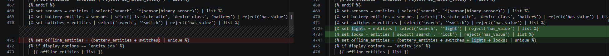

The use case for light. and also lock actually is that I want to know when they drop out of zigbee (they dont have battery) which I have been struggling with on some devices and the only solution seems to be re-pairing, when stuff dont work family gets upset :smiley:
Thank you for the YAML, I didnt get it to work, but I took it into Gemini and that did the trick.
https://pastebin.com/DGp4vQtt
Picture of main change:
Thanks again :partying_face:

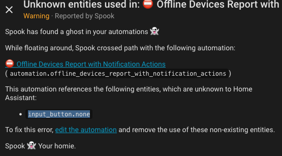

The default value default: input_button.none when no button trigger is selected leads to warnings:
default UI:
spook repair:
posted fix, version 2026.09.03.50
