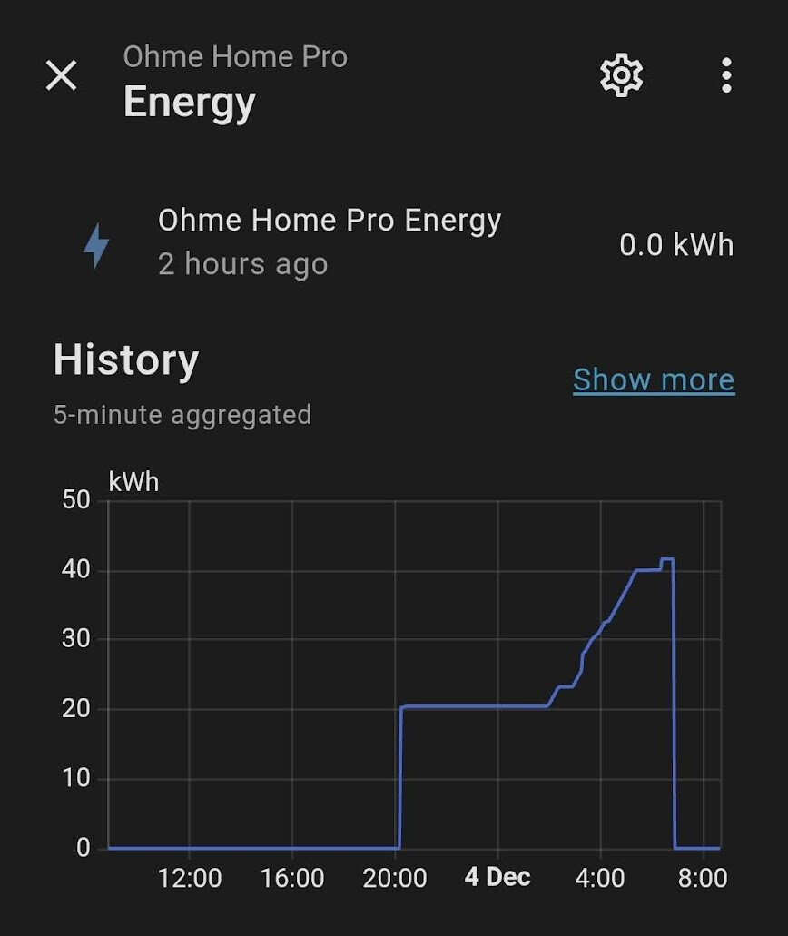

Hello and thank you for the integration. Do you know why energy sensor behaves so weird? As soon as car is plugged in it jumps to random amount. This makes it impossible to use in energy dashboard. Power sensor seems ok, so I’m experimenting with Riemann function sensor. But if energy sensor doesn’t provide useful data maybe not worth having it. Thank you!
