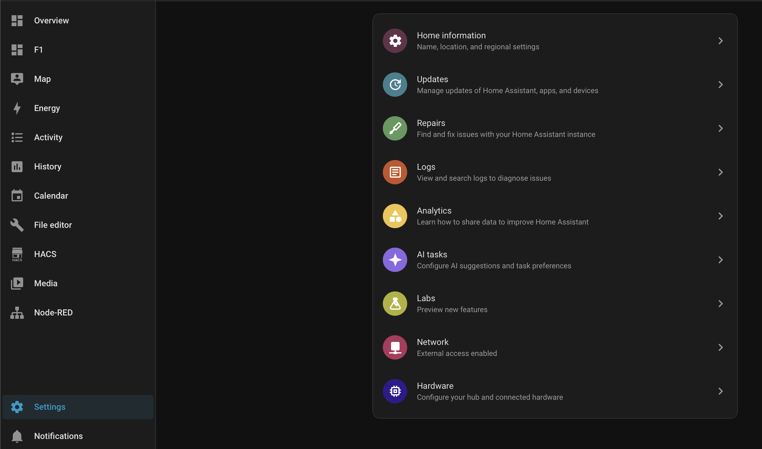

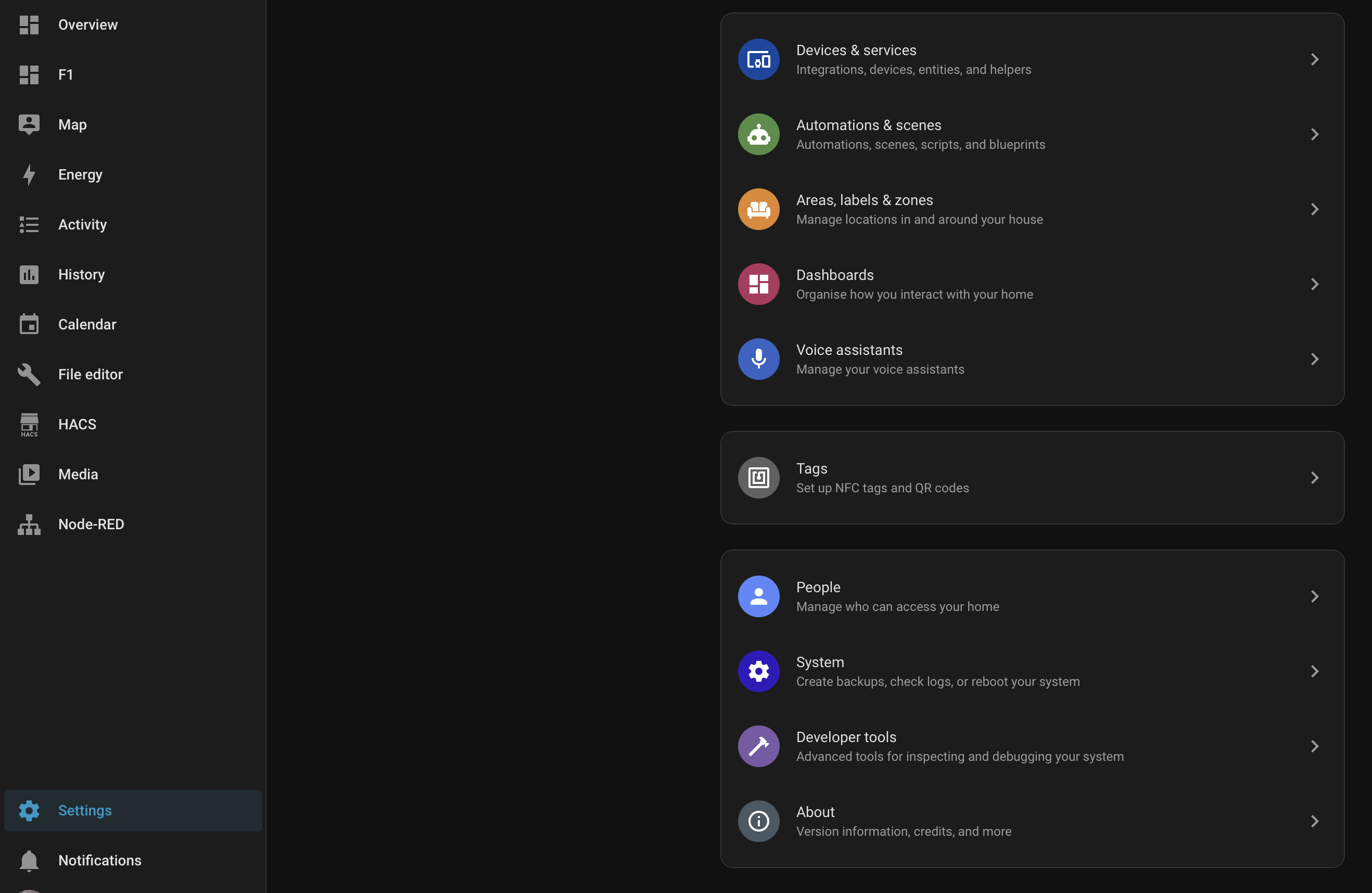

Ok... where did the apps / add ons option go
trying to install zigbee2mqtt, but it seems apps/addon’s disappeared
version 2026.4.4
this is home assistant as image onto raspberry pi, HAOS

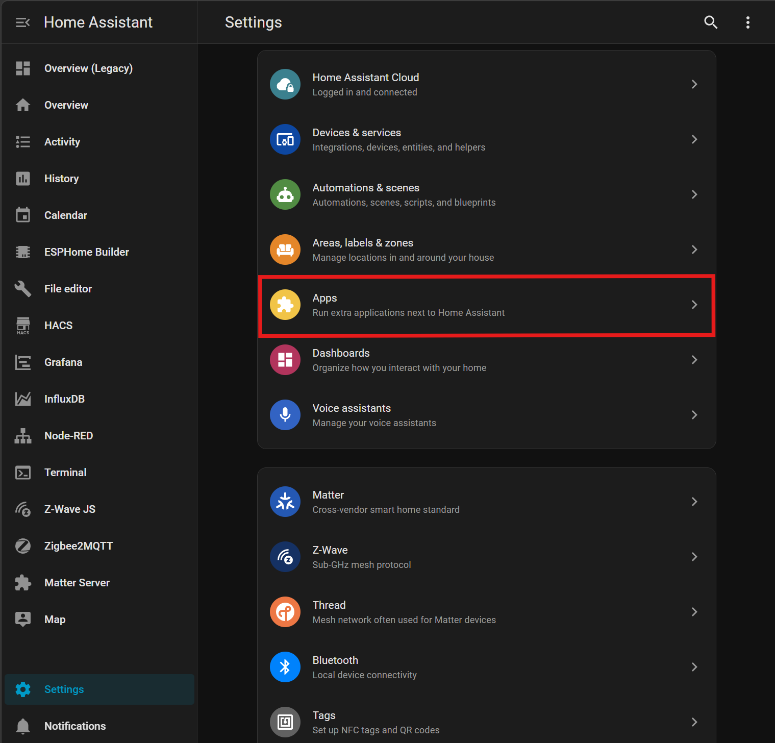

Well, here is where it is on my HAOS system… :man_shrugging:
Version info
Why are you running such an old version of the HAOS operating system?
ye that is where my apps was also, where I came looking for it.

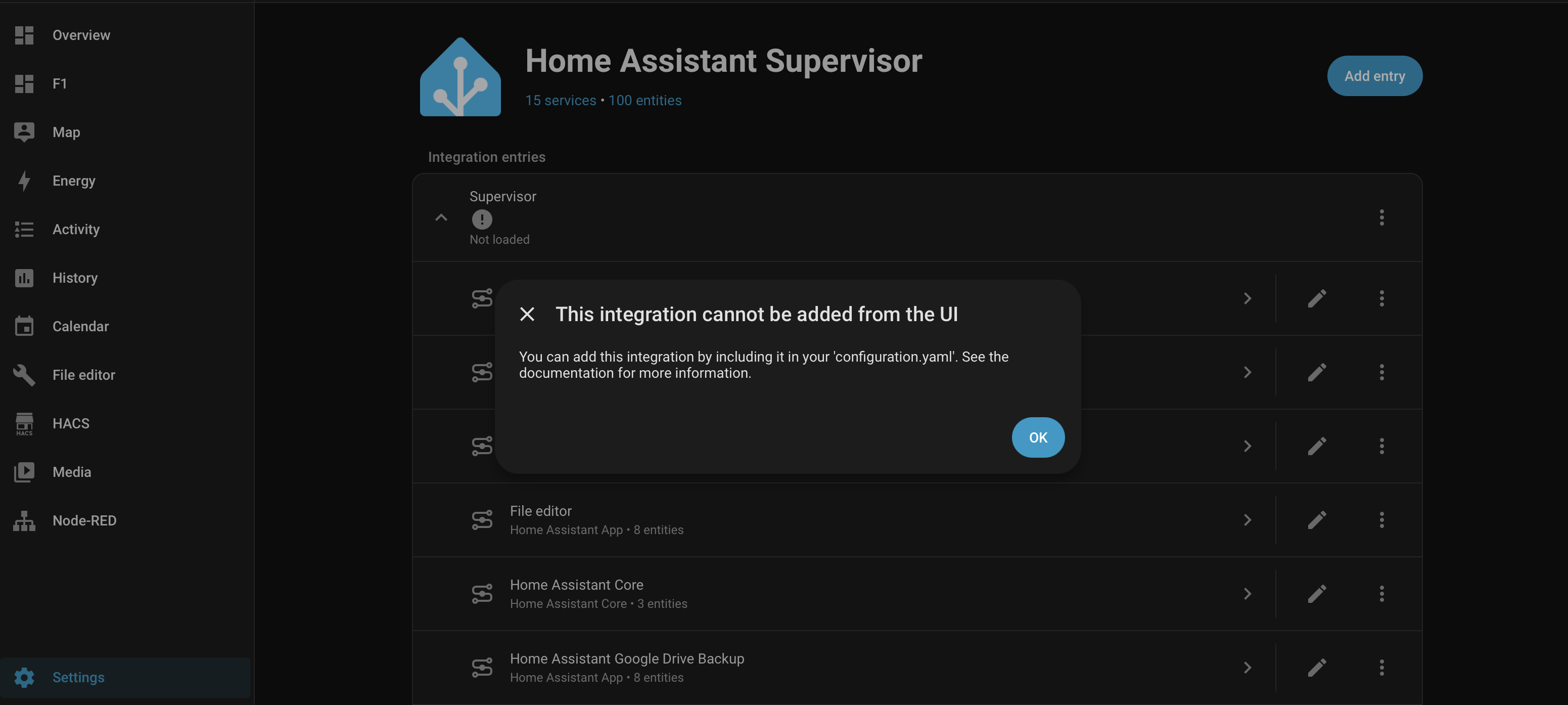

got the weird one, see the comment next to supervisor, saying it’s not loaded…
as far as I see OS 2025.05.5 is the newest… except if someone can give me the command to force a newer update.

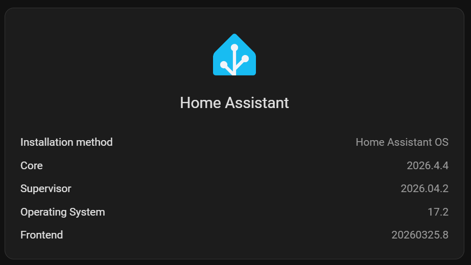

G
17.2
Not that i know of, that particular “issue” is a mystery to me :slight_smile: , i assume you have tried the basics, Clearing cache, Everything ! in your browser,and/or tried from other Devices
What’s Your Frontend Version ?
how do i figure out front end version ?

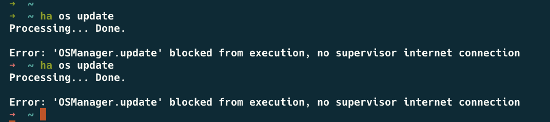

some reason get this when trying to do os update
➜  ~ ha os update
Processing... Done.
Error: 'OSManager.update' blocked from execution, no supervisor internet connection
even though as I said I can do ha core update.
