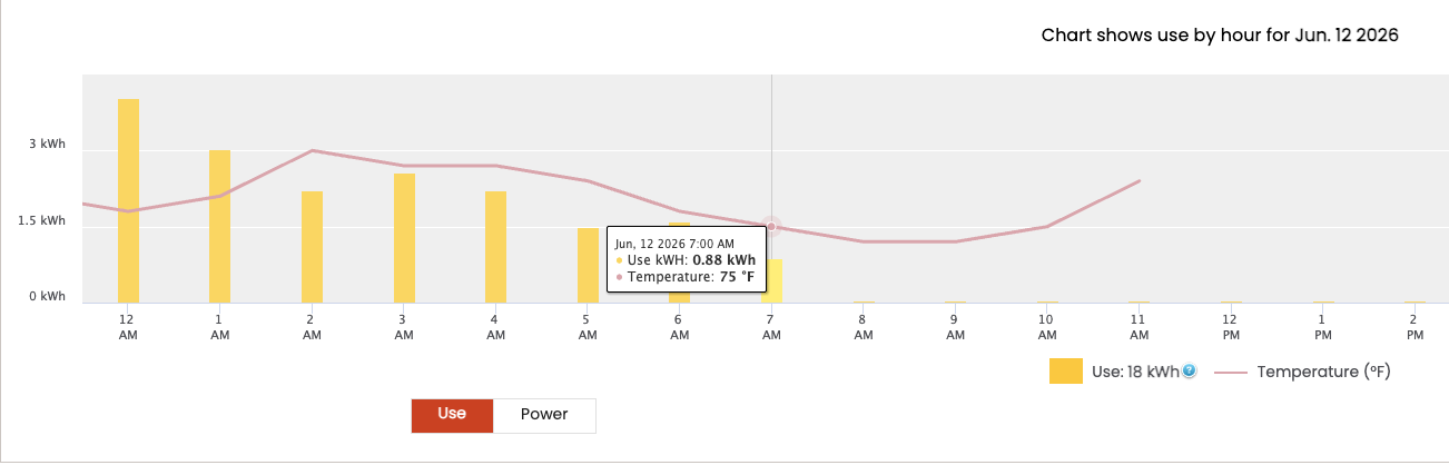

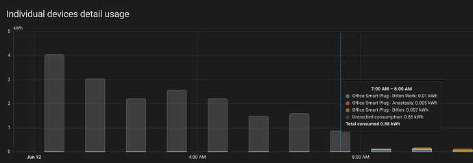

I wanted to view my energy consumption in home assistant and not have to log in to OGEs slow portal every time. So I made a custom integration for personal use and figured I'd share with the community

When you first initialize the integration with your username and password, it grabs 90 days of data.
OGE only gives an hourly breakdown of usage. They also don't update every hour. Right now its 5PM CST but they only show me data up until 8am CST

This integration is not extensive and there is more data that is possible to capture
For now I've decided energy usage and cost were the more important.
