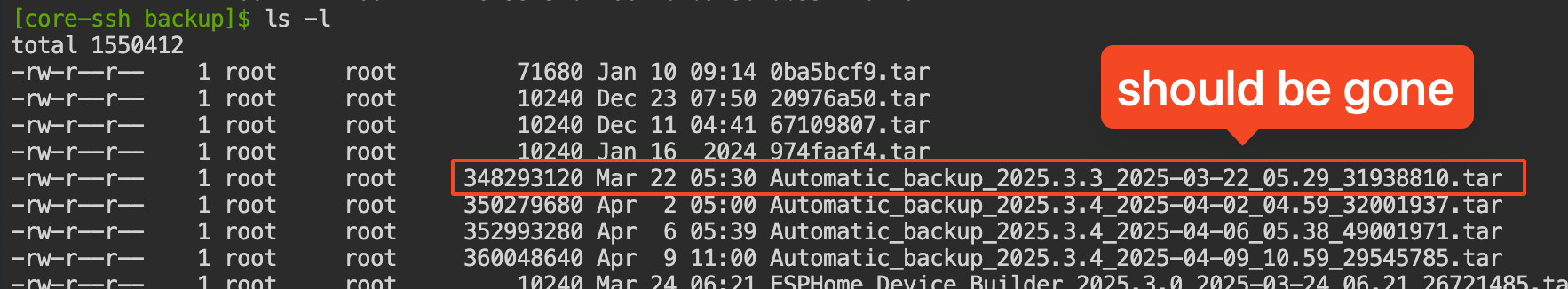

However(!), if I look at what’s actually in the /backup directory on the device’s disk, the oldest automatic backup which no longer appears in the above screen is still actually there on the disk:

Thanks, there are old backups from previous versions in the /backup directory, but the one I indicated in my screenshots which disappeared from the HA web interface but still exists on the disk is a “new” backup system backup that definitely should have been automatically deleted from the disk (presumably when it was removed from whatever index that HA maintains to show the list of existing backups in the web interface).

Thanks for the data. Can you confirm the owner and permissions on the files on disk? Are they owned by root and 644 like in my screenshot?
