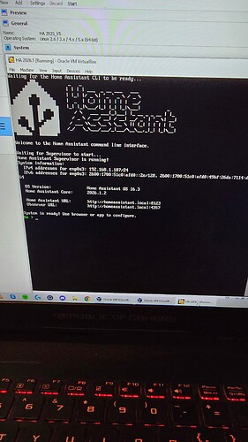

I currently only have the new instance of HA running and the IP is 192.168.1.107. Pictures might be valuable.
My laptop IP is 192.168.1.226

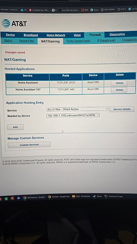

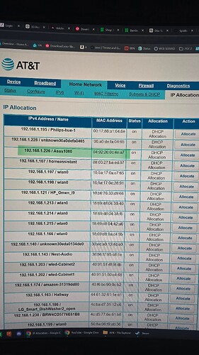

I am suspecting that my issues lie within my router settings. I went to a port forwarding site and verified that my port 8123 was NOT open. I am now looking into changing the settings of my ATT BGW210-700 router. It had worked fine previously.

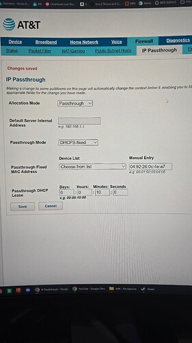

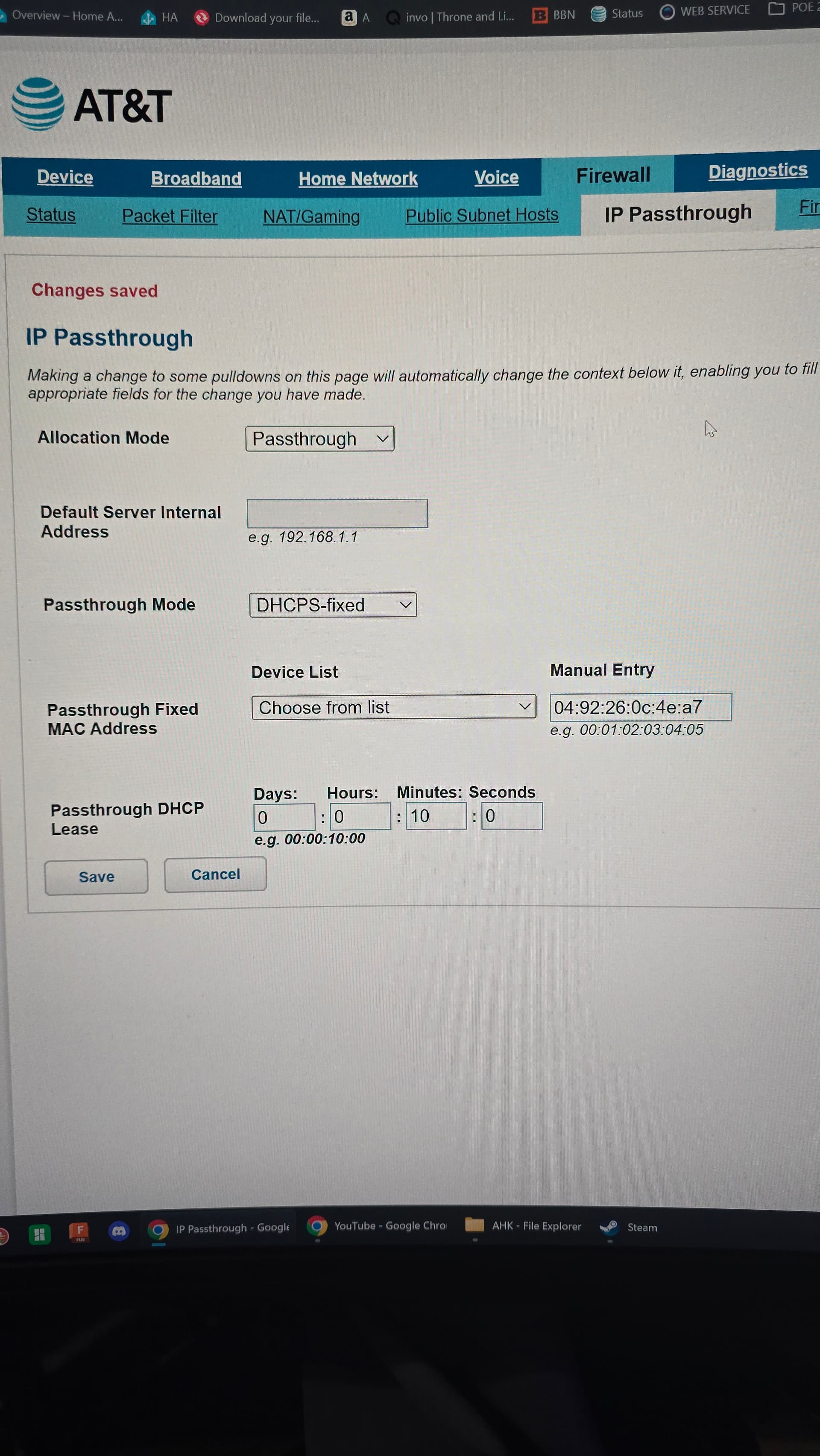

Here is what I have in the router.
Not sure if I need the IP passthrough or not, but I believe I had in on old version when it was working.
Is your laptop IP reserved (is it a static IP)? That’s what you’ll want to do if not. HA is a host, so it needs a static IP on the local network.
Yes I did have it on static IP, but will have to check if it still is. What is easiest way to check?
Brian
Typically, in your DHCP/DNS settings. Albeit, so there’s no confusion and we’re on the same page - there’s two ways to give it a static IP. One way is on the laptop itself. The other is the router. I prefer using the router to assign/lease a static IP, instead of changing the interface card settings on the laptop. Do what you prefer.
I found it in the IP settings of router, went to allocate, clicked the one it was using and then saved. Now it says fixed allocation. In the above screenshot i sent earlier it says DHCP allocation. I am powering down HA and restarting. I may have to restart router too perhaps. I restarted HA and it still shows 8123 to be closed using the port checker. Forgot to mention earlier that I run Adguard, but I have it disabled. Never had a problem in the past, but figured I would eliminate it.

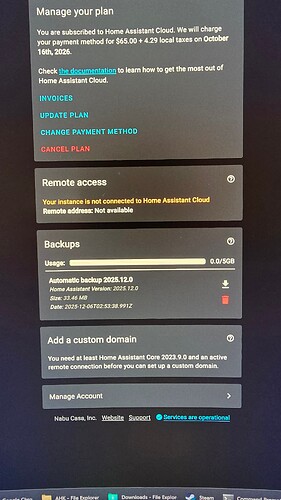

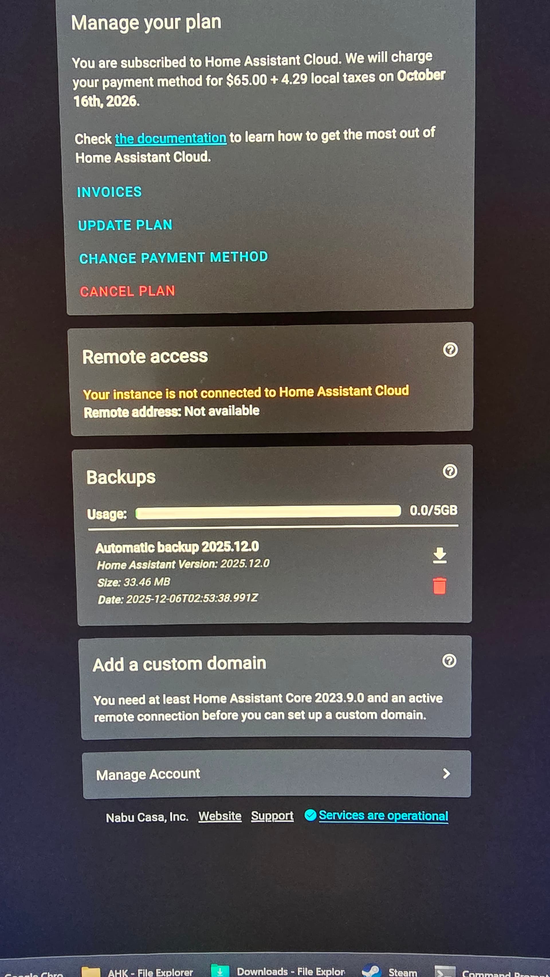

I had remote access enabled prior to it not working but now it says:
Your instance is not connected to Home Assistant Cloud
Remote address: Not available
Tried logging out and back in but nothing. Due to the fact that port 8123 is not open any more, I believe that is the culprit, but willing to try other stuff.

Take a good look at that link. You can login to Nabu’s Account page and activate remote access that way.
Here is what I am seeing.
Brian
is that from the Home Assistant Cloud page from your VM? Or is that from https://account.nabucasa.com/?
From https://account.nabucasa.com/

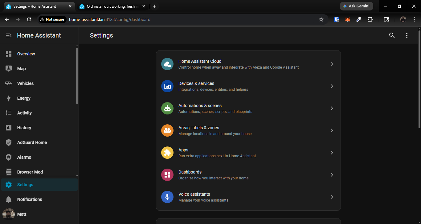

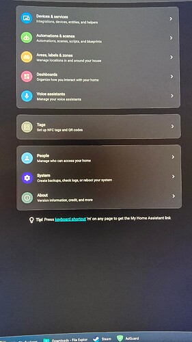

Alright, so you can access HA locally at http://192.168.1.226:8123? If yes, go to Settings > Home Assistant Cloud. Remote access should be enabled there.
That is my laptop’s address. My HA instance is the (http://192.168.1.107:8123/) address.

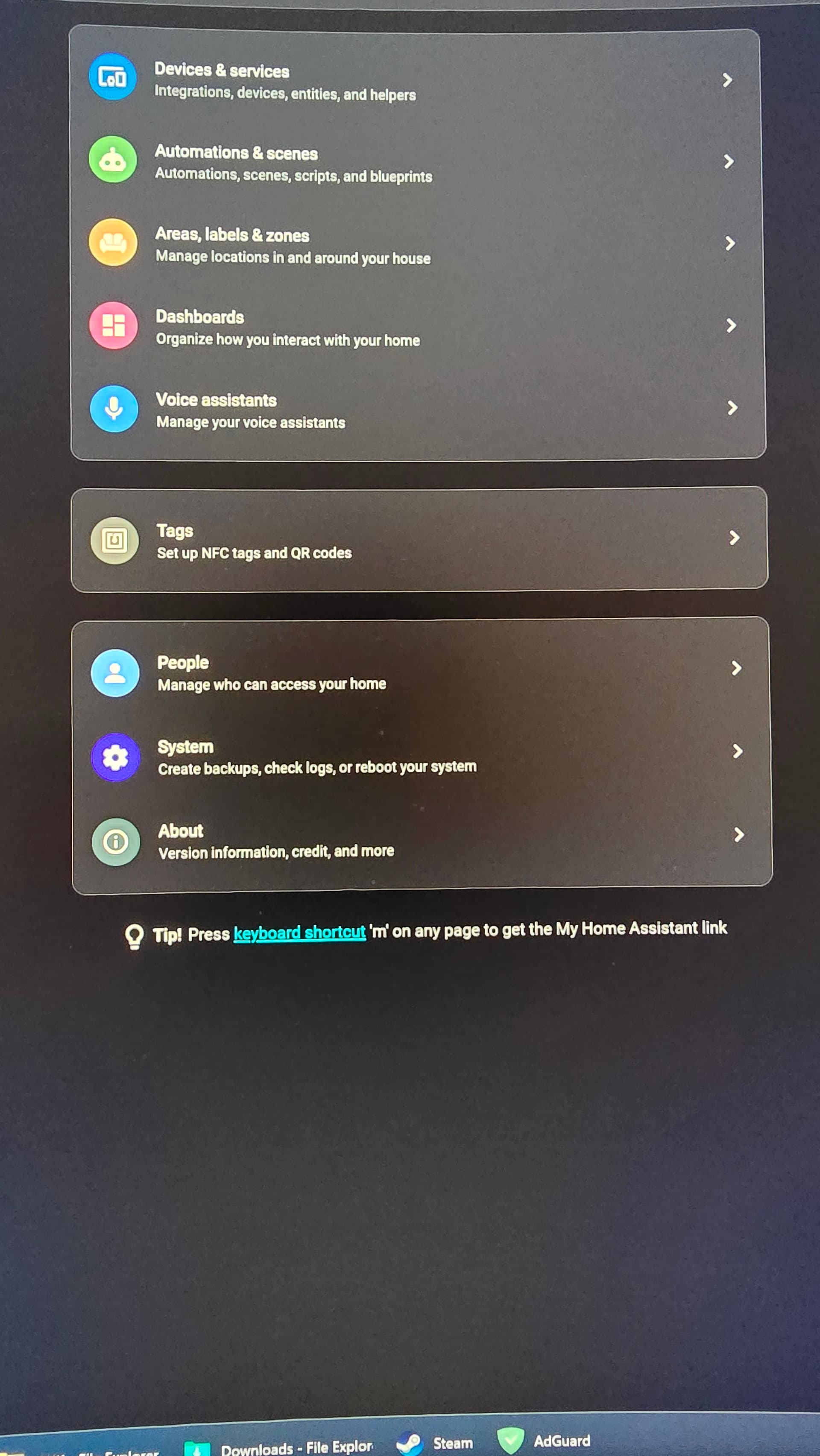

Ahh, yea… I see that now on the screenshot. Well good. So it’s accessible? Login and go to Settings > Home Assistant Cloud and check there.
No, under settings, HA Cloud is not visible.
That’s very strange… So the option is missing? Mine looks like this -
