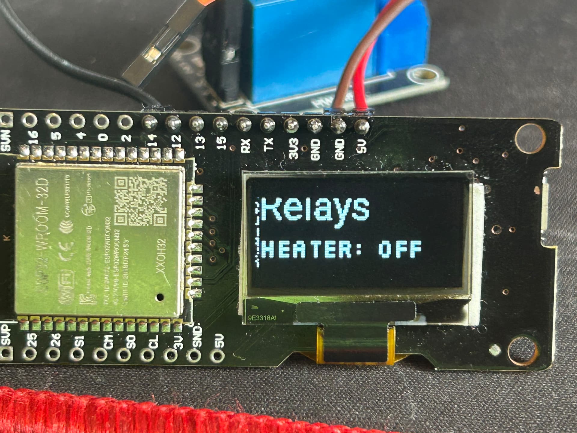

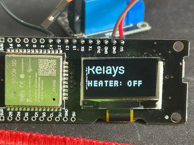

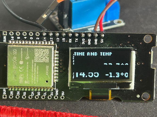

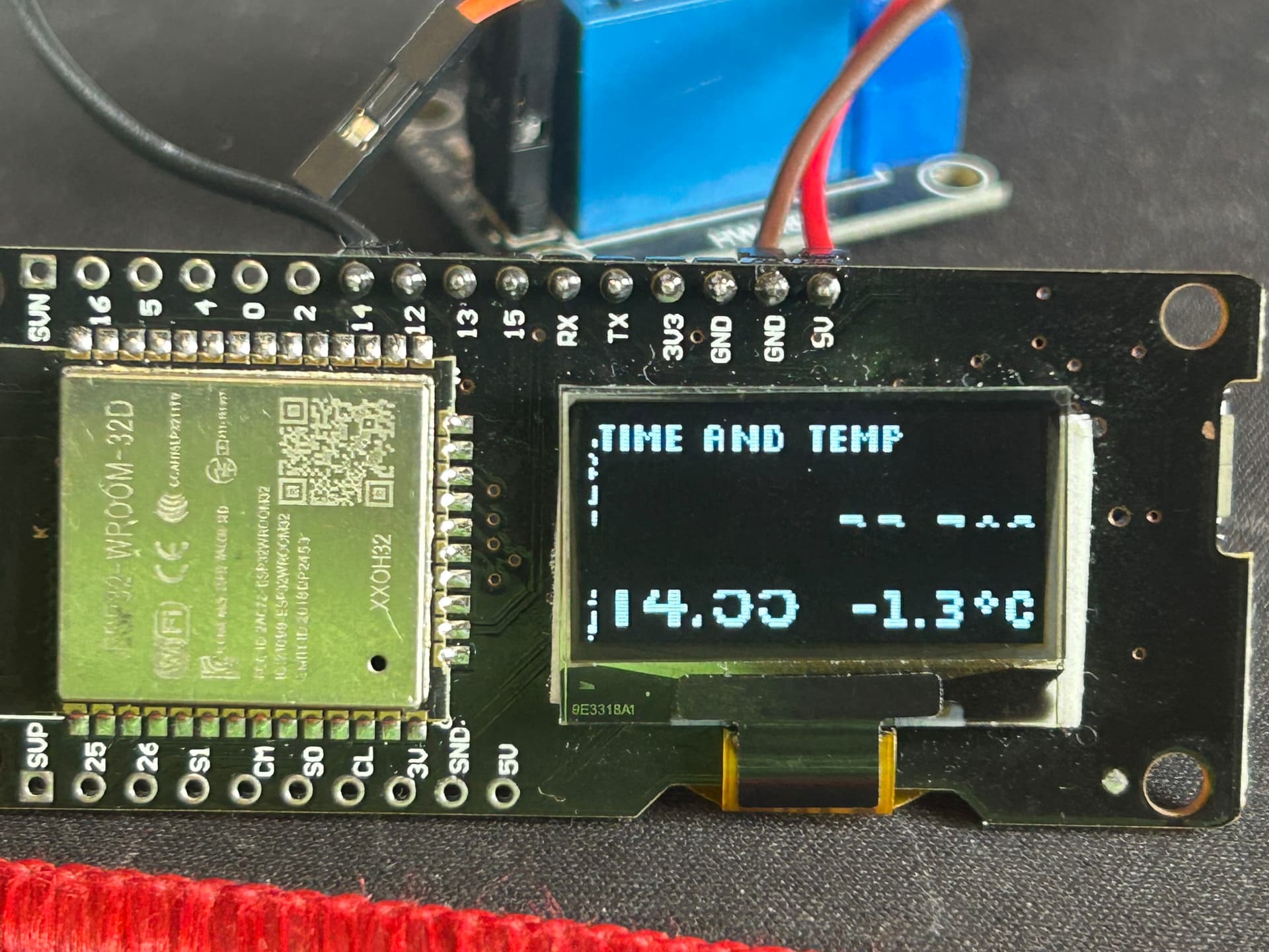

I’m aiming to create a bread proofing box, where I can read the temp and humidity from the box and control a heating element for bulk fermentation. up to know the project is just about programming as I’m waiting for the heating element and the DHT sensors to arrive. All is going well except I have the first column on the screen has some characters on it and I don’t know where its coming from and i do not know how to correct it.
Im sharing my code below and posting pictures of the characters on the OLED screen.(very first coloumn)
Thank you in advance

SSD1306 or SH1106?
What are you sensing your temperature and humidity with, or is that done somewhere else?
Hi @IOT7712 , thank you for your response.
All i can find about this esp32 is that is SSD1306. Is there a way i can know from the hardware itself ? im planning a DHT11/22 to get temp and Humidity.
I followed this site for its pinout
Random Nerd Tutorials Link
Thank you for your question, i changed the model from SH1106 to SSD1306 and that cleared it up. All good thank you once again.
