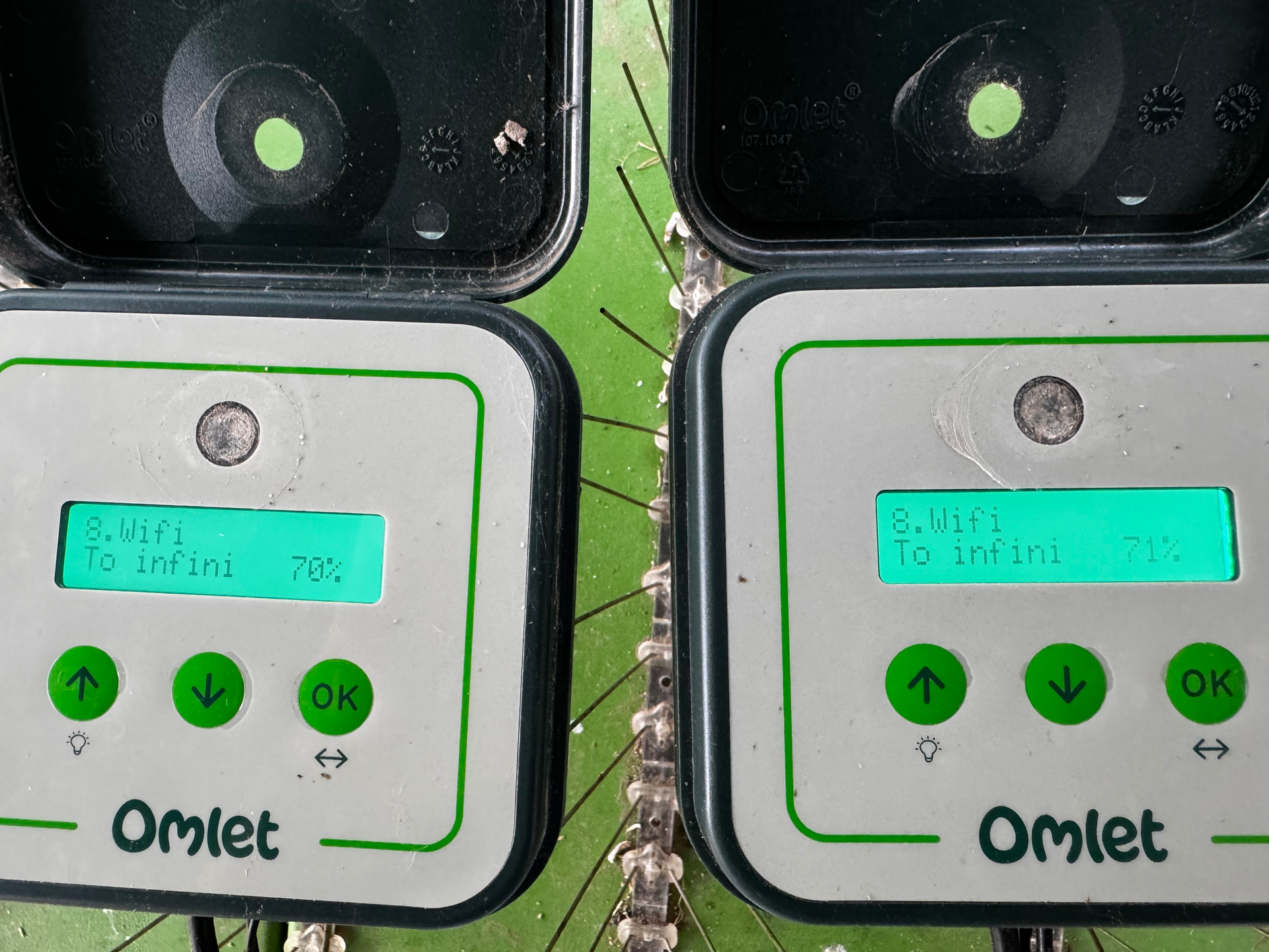

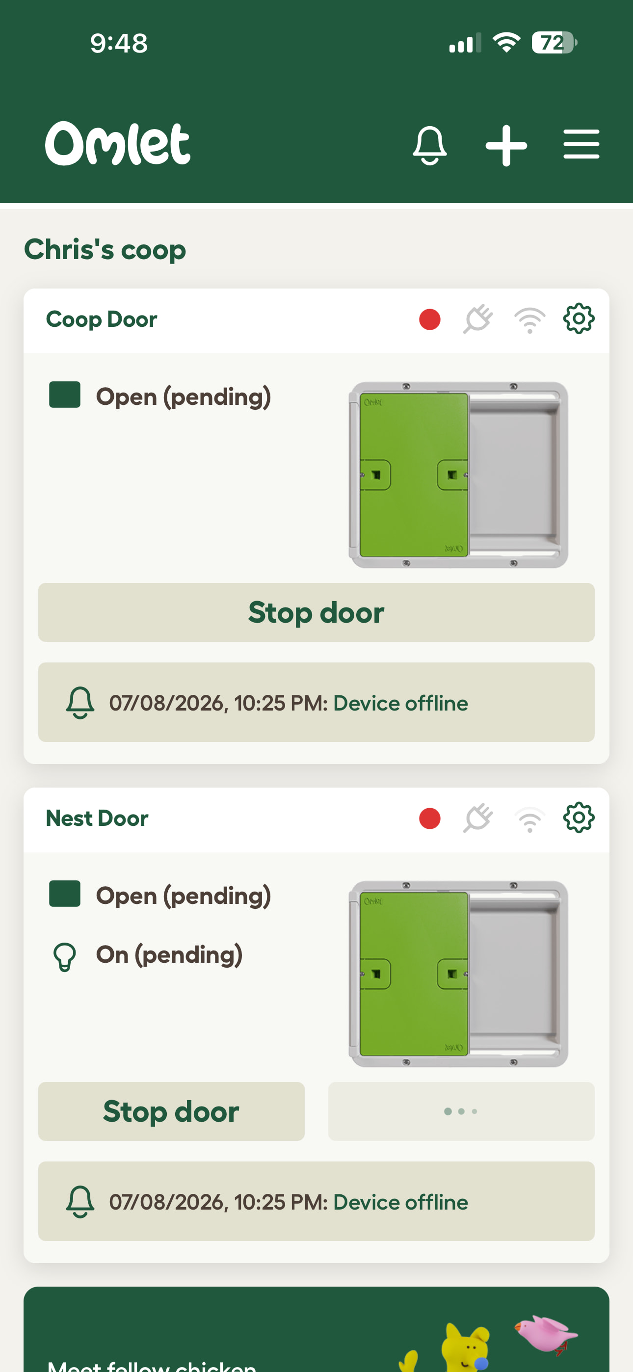

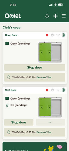

So per earlier posts, I have two Smart AutoDoors. Both running on mains. Both with plenty of signal strength.
Both have in recent weeks gone permanently offline. No matter how many times I power cycle them, they remain offline, with random intermittent connectivity.
One just randomly now decided to close, trapping a chicken inside. Not a time of day trigger, light trigger not in use, Home Assistant didn’t do it (it’s lost connectivity), just closed. So I power cycled them again. It then reopened. They’re possibly reacting to queued commands waiting because they are down, and yet they aren’t coming online and acknowledging they have done so… in fact they show last connectivity is yesterday.
But both remain offline in the app and Home Assistant, even though the devices themselves both say they are online at 70%+. Really frustrating how this has suddenly started being unreliable in recent weeks after per the above posts this and has been 10000000% stable since the firmware changes last year.
