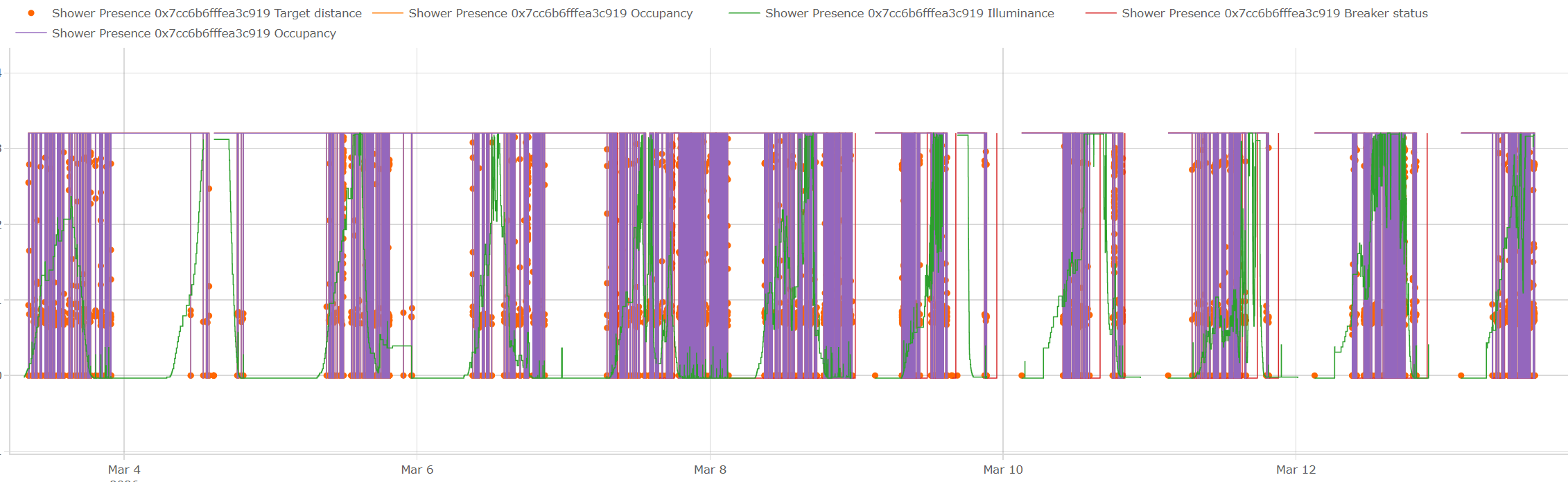

I’m using a ceiling device to turn on a towel rail when presence is detected in the shower - so relatively close range only. It’s detected as (from Z2M device):
Zigbee Model: TS0601
_TZE204_clrdrnya
Model MTG235-ZB-RL
(Tuya MTG235-ZB-RL control via MQTT | Zigbee2MQTT)
24G Human presence sensor with relay (Tuya)
(Zigbee2MQTT))
I have noticed in other devices they can have significant sensitivity from the rear.
I am seeing many false detection spikes - but on inspection it seem only during the day.
It’s mounted with its rear side in the attic space. Could it be detecting expansion/contraction of roof tiles? Anyone else seen anything similar?
It's likely just a tuya thing. I have an MTG275-ZB-RL and the sensitivity slider does nothing.
I didn't hang it in a permanent place, just for testing. I have it at 1m high facing the ceiling and it detects when I walk around the room. It detects curtains opening/closing sitting around 3m away. It detects the slight movement when I walk down the stairs (closed stairs, but the radar faces the stairs) and even worse, it seems to detect heat from electric radiators.
It's unfortunate that we can't select exclusion zones or even see XY locations.
I'm going to replace it with the Sensy One E1 Pro, as it has the LD2460 sensor, allows for an exclusion zone and can target 5 people. This tuya sensor could probably be repurposed in the attic, or the bin.
