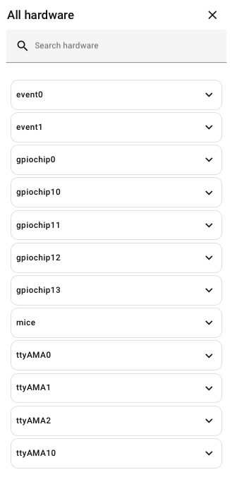

No USB devices are showing up in the hardware views. (I’ve tried 2 PLMs on both USBA ports and the USBC port)
